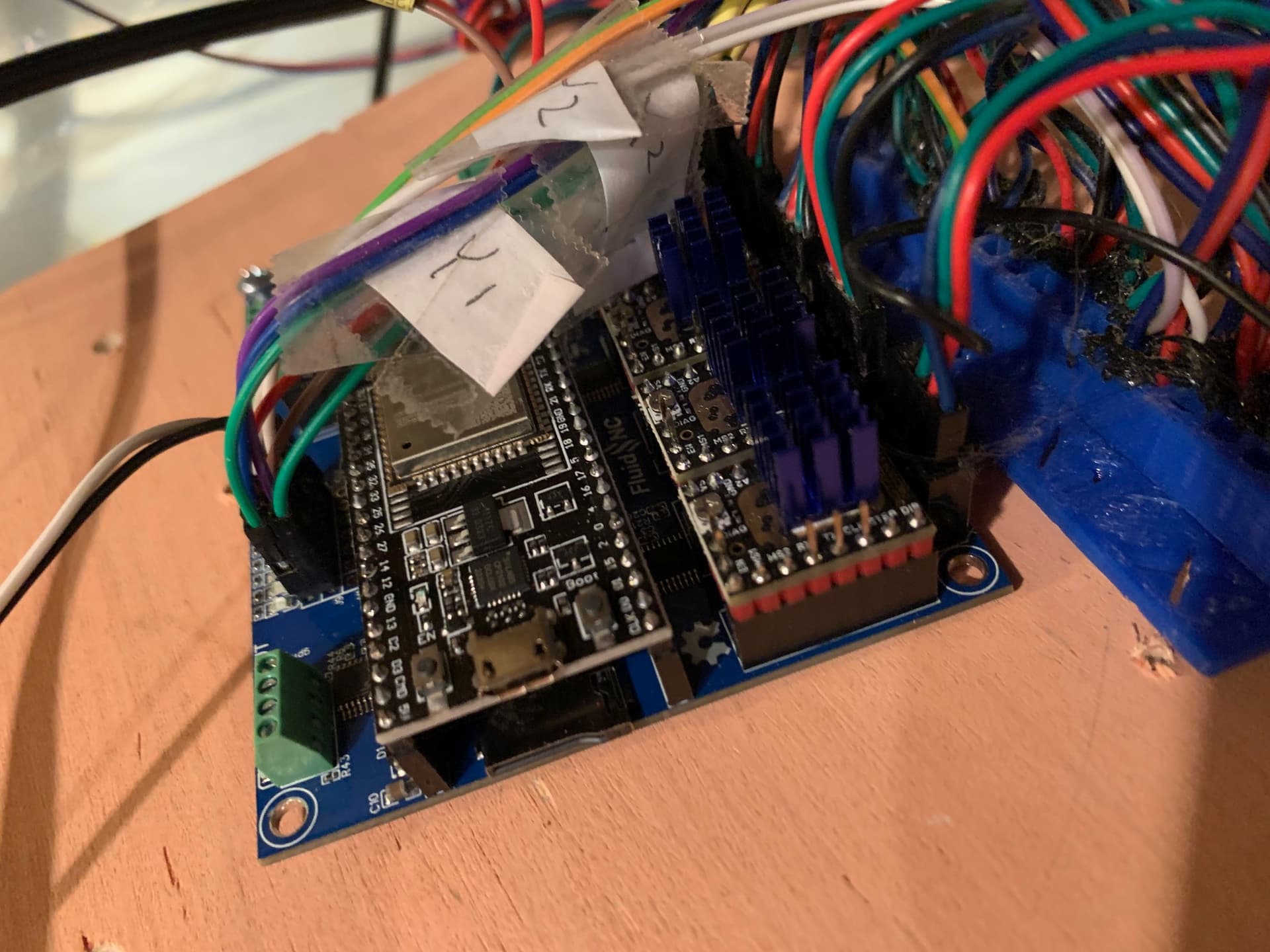

Looking ahead to the next couple questions: I don’t know how to have the (DW660 single speed) spindle start/stop with a 5-24v signal to my SSR, or how to use the probe. [Also I would like to set up the 6th motor driver for a rotary unit, either as a substitute for X, or as a true 4th axis. the pinout would help with that ]

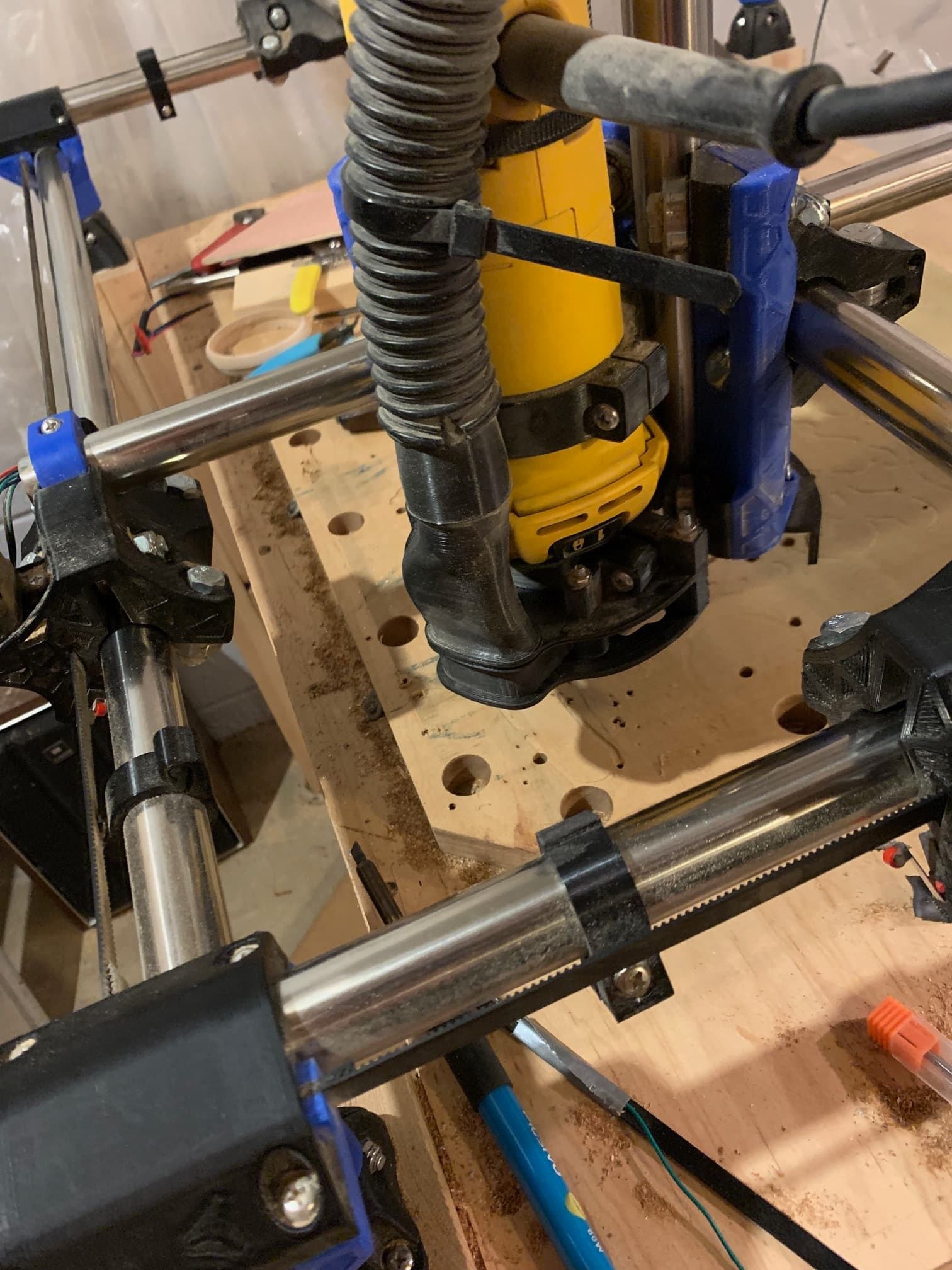

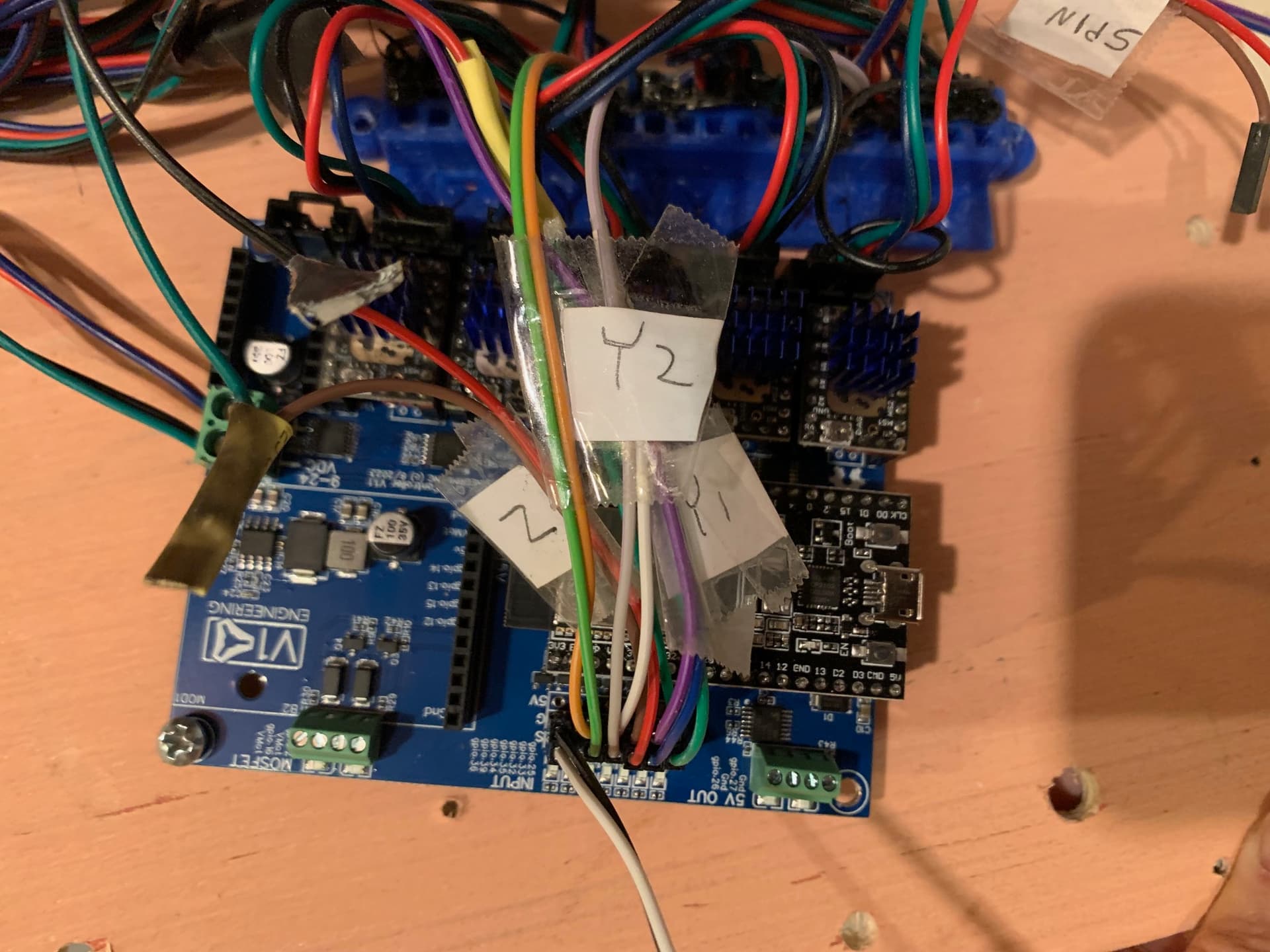

Here are some pictures of the board and the Primo, not sure what you are looking for, happy to take more photos.
Thank you

That is on the bottom of the board, There are pictures of that if you don’t want to flip it over.

I don’t see anything unusual on the board, good quality soldering etc.
