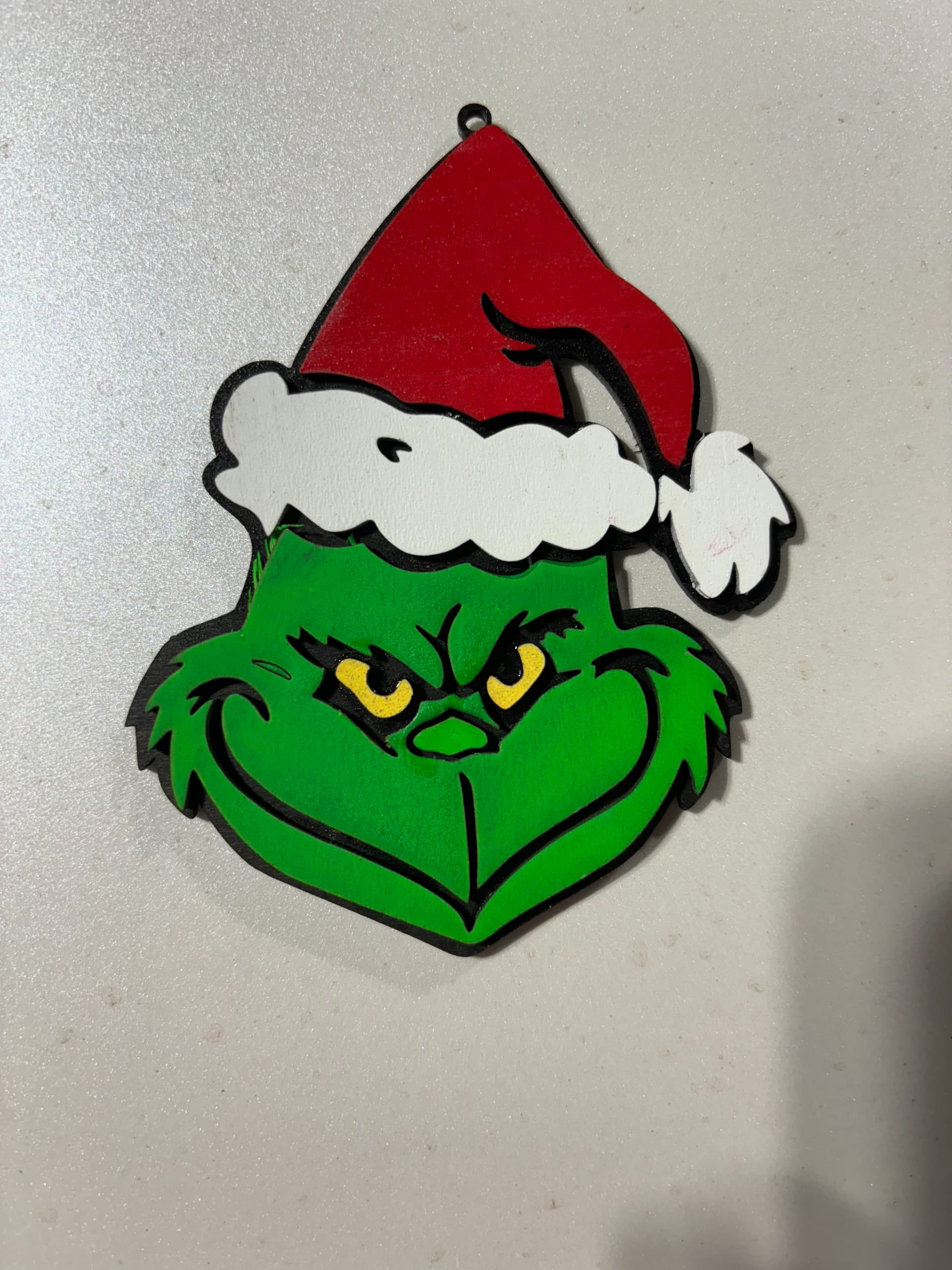

The grinch?

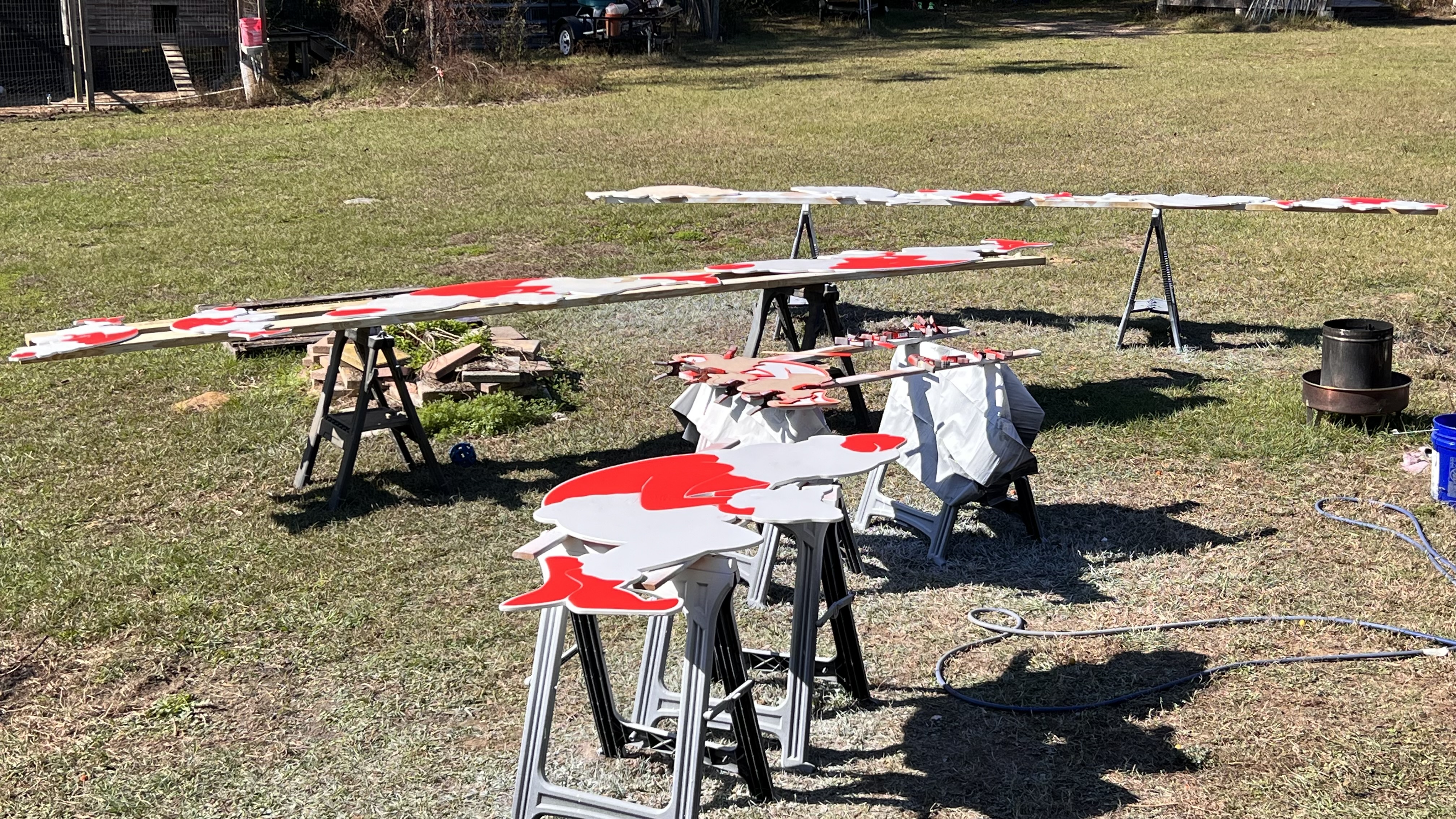

Yes it is. 3 6’ tall ones and 8 3’ tall ones. So ready to be done making them LOL
It was the hands that gave it away. They look great and I like how you use CNC to create new things ![]()
Thank you. That’s what I enjoy the most about having them.

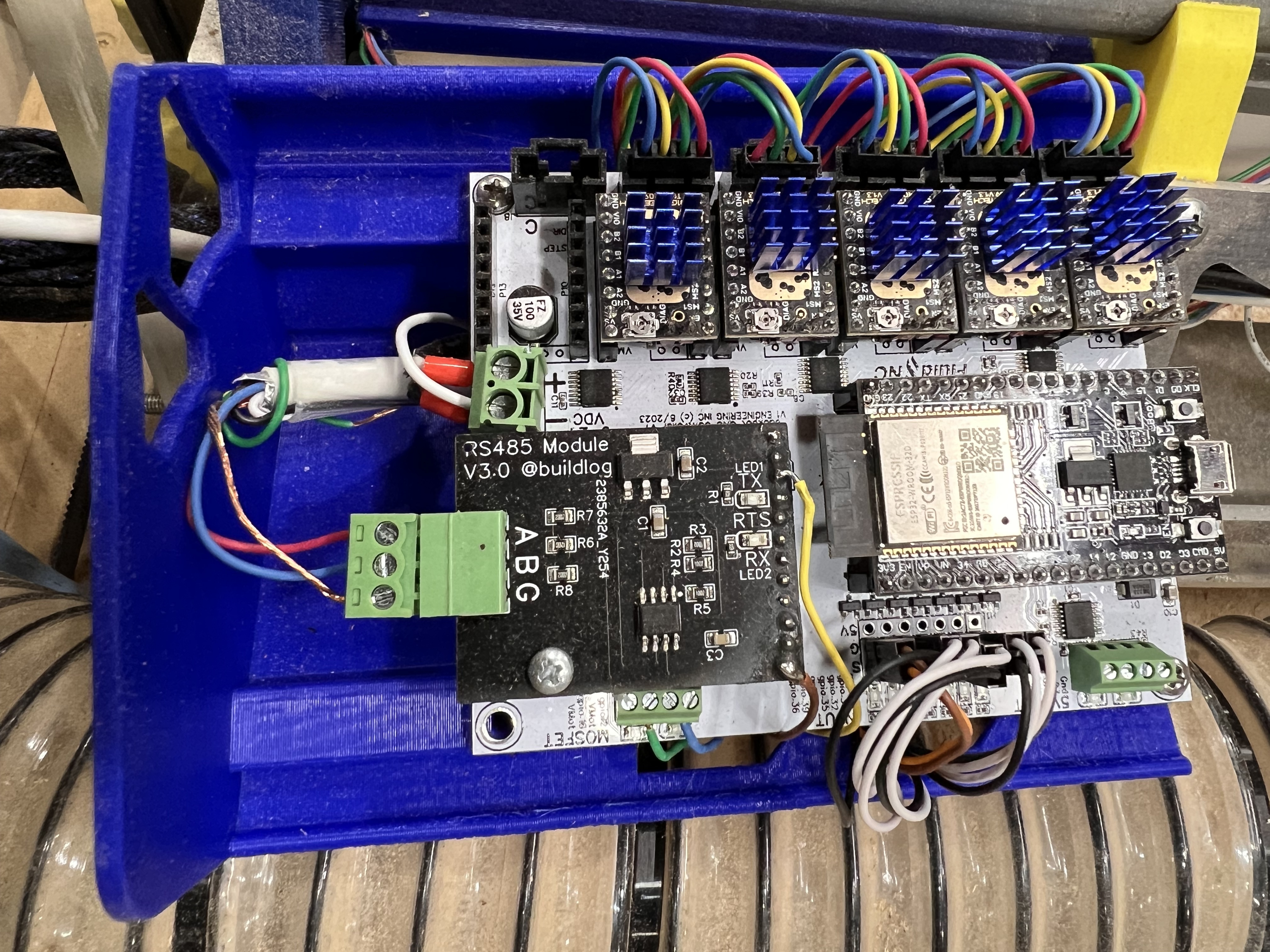

Ok @vicious1 i just brought a ground wire from the negative side of the 12v power supply for the LEDs and tied it into the negative side on the jackpot. The ESP32 already shares a ground with the jackpot since it gets 5v and ground from there to run. The only other thing I’m wondering is should I tie the ground from the RA485 wiring to the jackpot ground. That ground wire is terminated at the house ground on the other end along with my vac hose.
Not 100% sure about that. Those VFD’s can kick out some weird stuff.
Try a regular router and the LED fix to eliminate the VFD as a possible issue. If nothing goes wrong you know it is the VFD, then we can try some things. Currently, you have too many variables.
Man that’s a LOT of work to change over to regular router with how I have everything set up. I just started it up for the first time today (without that last ground, didn’t want to hook that up till you said. It all went smooth as can be. I’m going to run it and see what happens. Last night was the first time it ever did anything weird during a job. It was always just when jogging before. But it stayed until i power cycled it. If it does anything weird ill report back what it says in the terminal. If it keeps acting up I will change out the router to this new shiny Kobalt I have and see what that changes.
I did find that my shielded cable for the spindle wasn’t hooked to ground. That’s fixed. Setting up Estlcam now to make some cuts so we will see how it goes.
One thing I don’t understand is how can it be the VFDs/Spindles fault when none of that was running for all the other problems? Just this once during the cut it messed up but everything else has been during a jog with the spindle off. Not trying to argue with you just trying to understand
Too many variables. I just take guesses based on how many times that has previously been an issue for someone.
Well I just pulled the RS485 Board and its running good. Dark but running good so far. Went to probe and the z motors were running different speeds. Some weird stuff. That really sucks though cause I really liked having that. One thing I might try is some shielded twisted pair. All I had on hand is the shielded wire I bought from you so I ran that. Going to amazon some shielded ethernet and see what happens. I guess it communicating even when the spindle isn’t running was causing problems
Maybe we need to swap the esp32…
