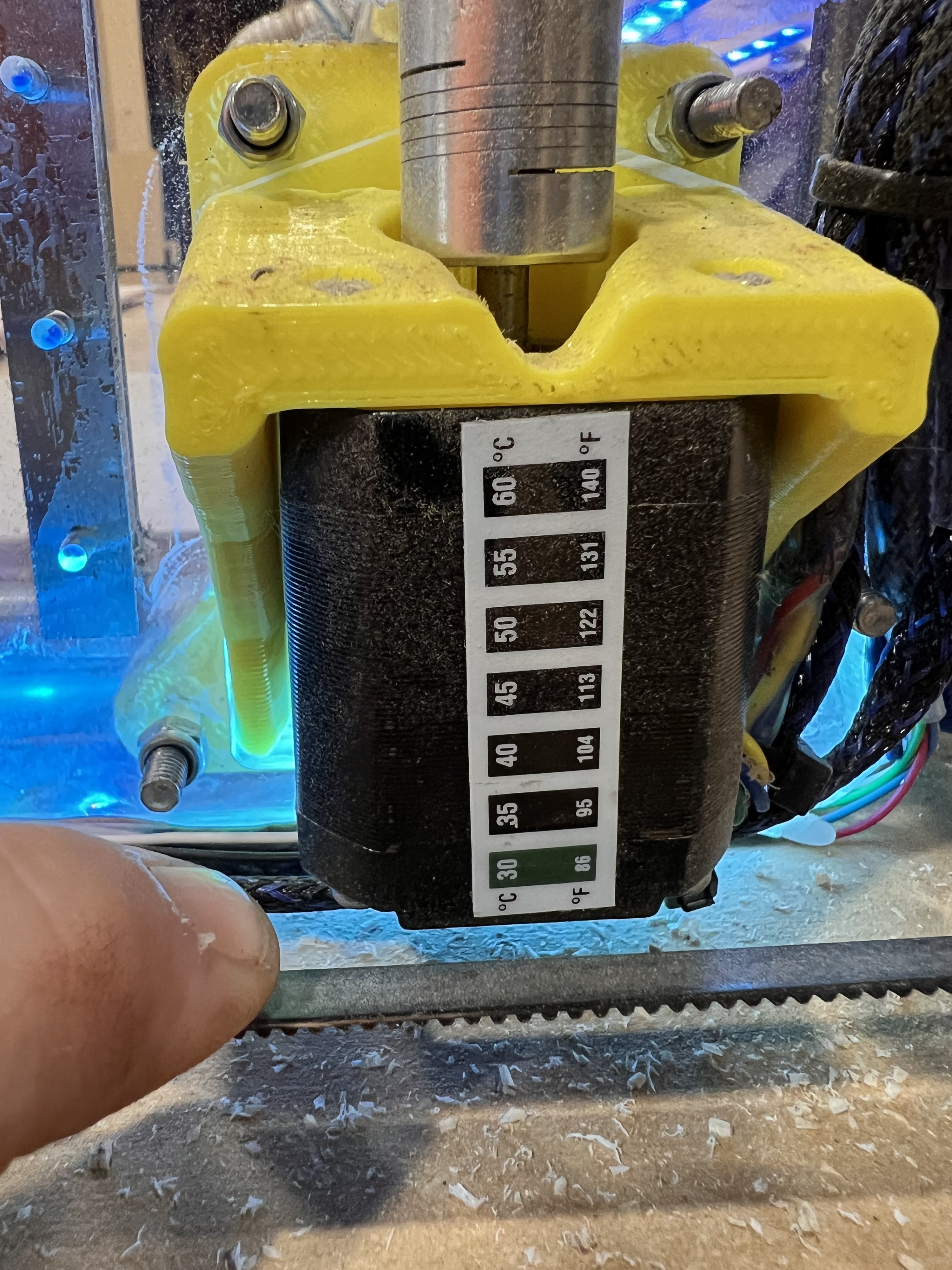

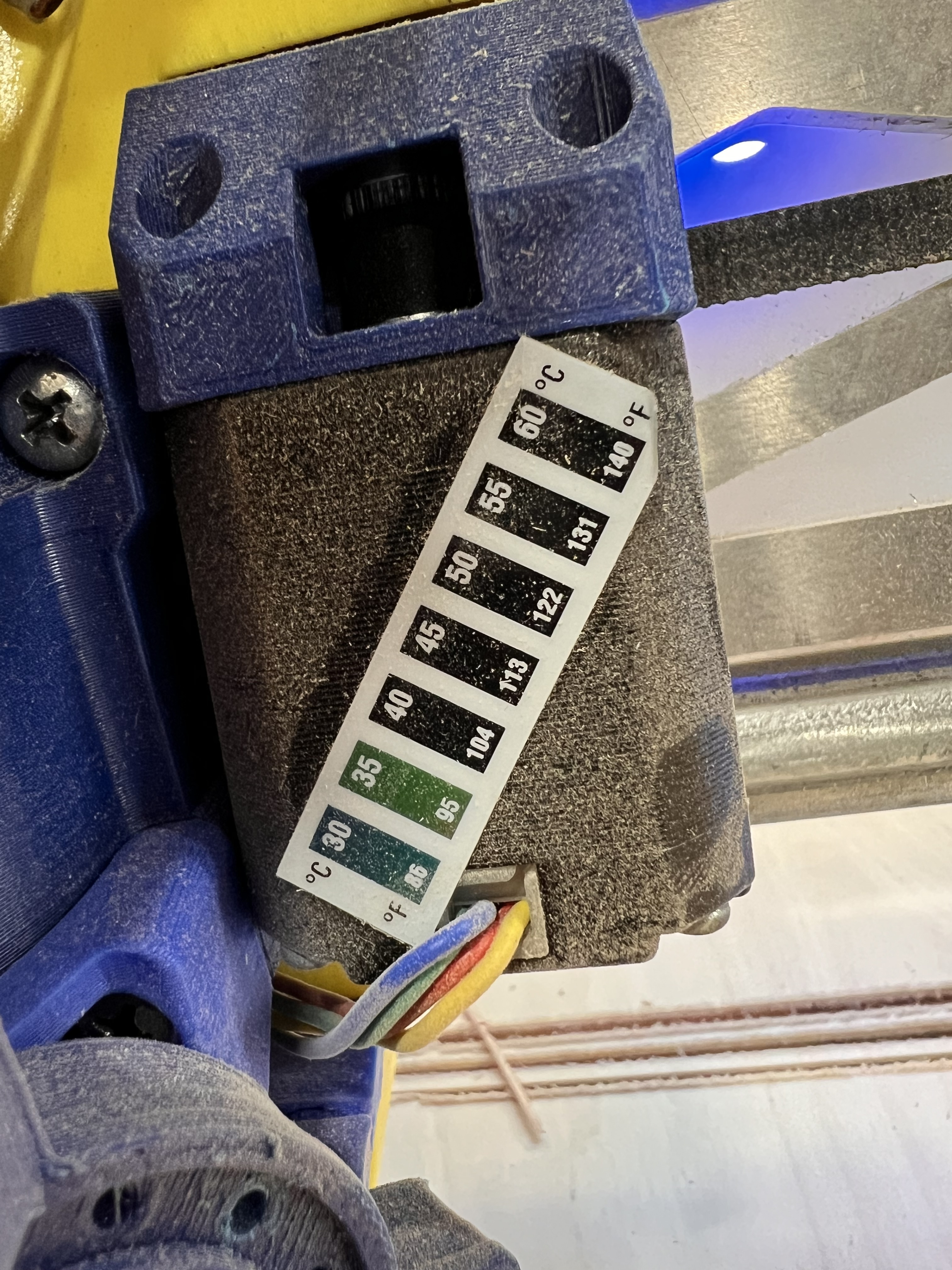

Made an hour long cut with it last night. All steppers around 35°C according to the stick on temp gauges and by touch I agree with them. Noticeably cooler than with the SKR and them running around 50°C

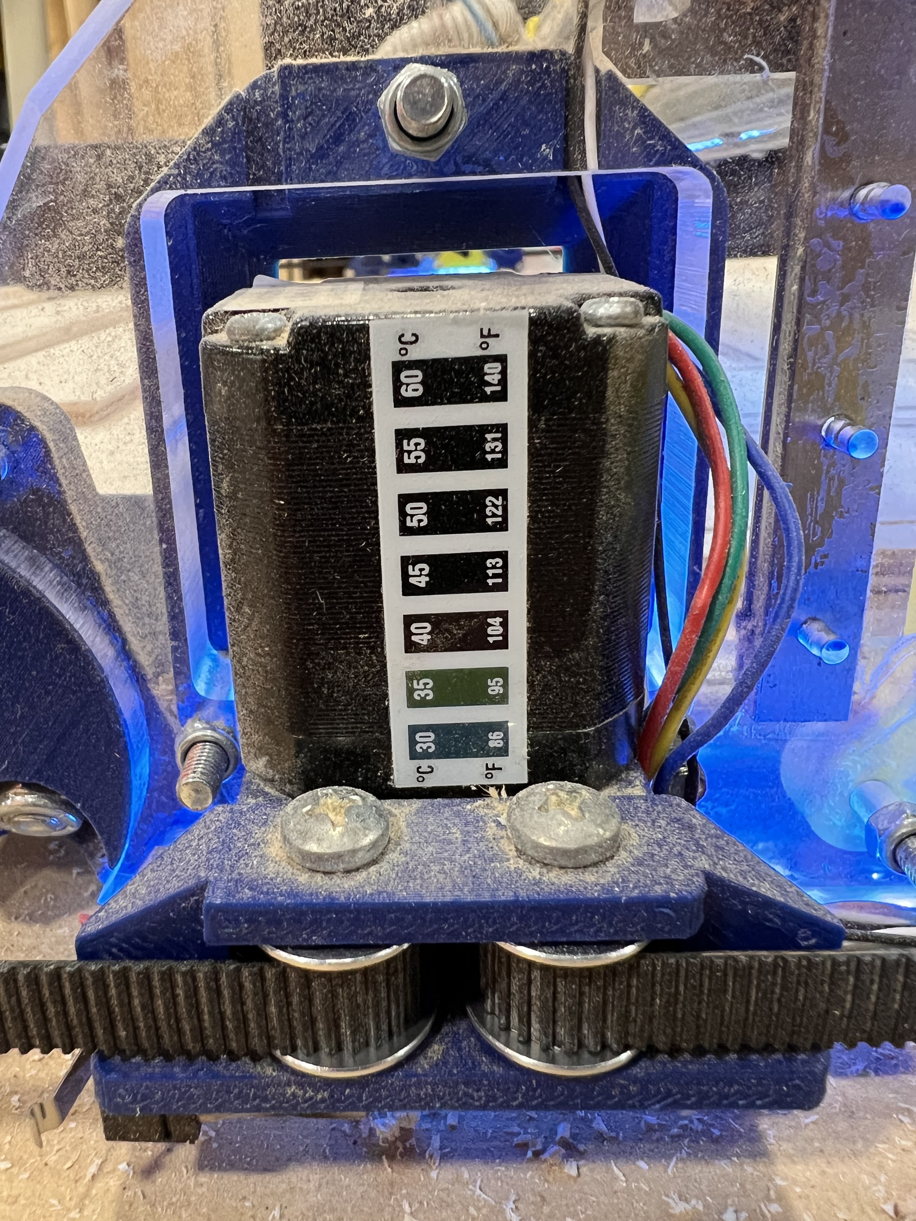

Here is a pic of the steppers after 1 hr cutting…
Y1
Z1
X
Current temp 7’ above the CNC
Y2/Z2 were the same.

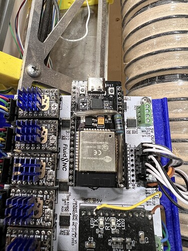

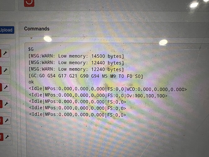

Ok I’m leaning towards a bad ESP32… Just ran a job with the original, job went fine. Went to jog to the next start spot and Y2 ran normal speed, Y1 half (guessing) speed. Rebooted and homed. Then it jogged fine to the spot, got ready and started the Gcode, it showed where I started it in the terminal then 2 low warning messages and that’s where it froze. I never had that issue when I had the other ESP32 in it with the exact same config file. I have these USB C ones I bought from you, thinking about throwing a resister on one of them and swapping it in and see what happens. @vicious1 your thoughts?
Edit to add…
This is directly after a reboot…
The USB-c need the pullup resistor for sure on any version before the v1.2 that just arrived.

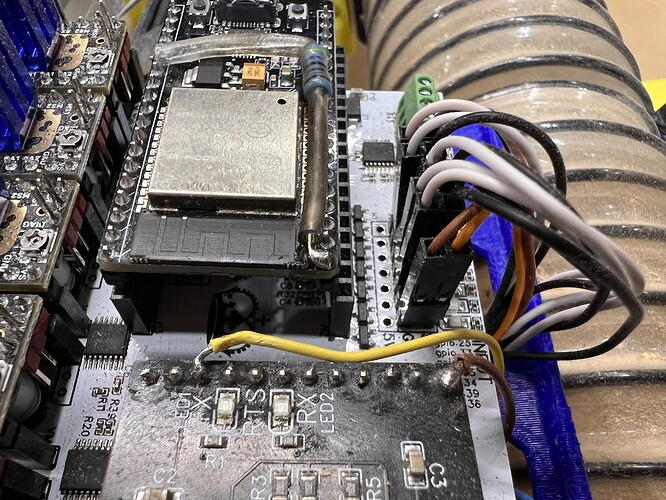

Found a 4.7K ohm resistor and soldered it on just to find out that the usb c board is narrower than the micro usb one and I didn’t want to bed it up to make it fit. So I grabbed the one out of the other machine again.

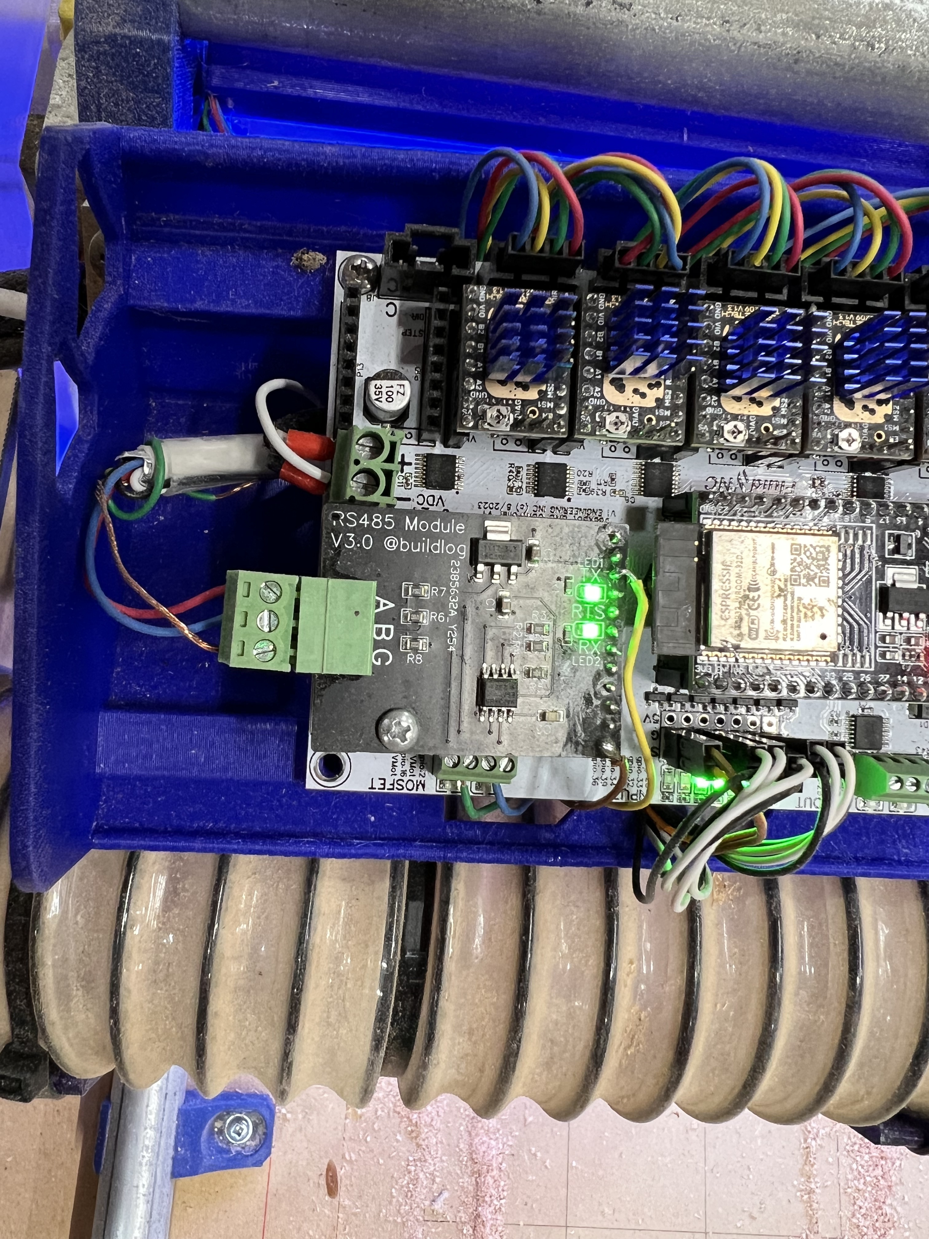

And it’s now confirmed it’s not the ESP32. Just had it mess up on the one from the other LR3 as well. So it’s got to be the RS485 board. That’s the only difference between this machine and the other one. And I know I’m not using the right wiring for it. So I’ll take that off until I get the shielded cat6 in later this week. Then we will see if that makes any difference lol

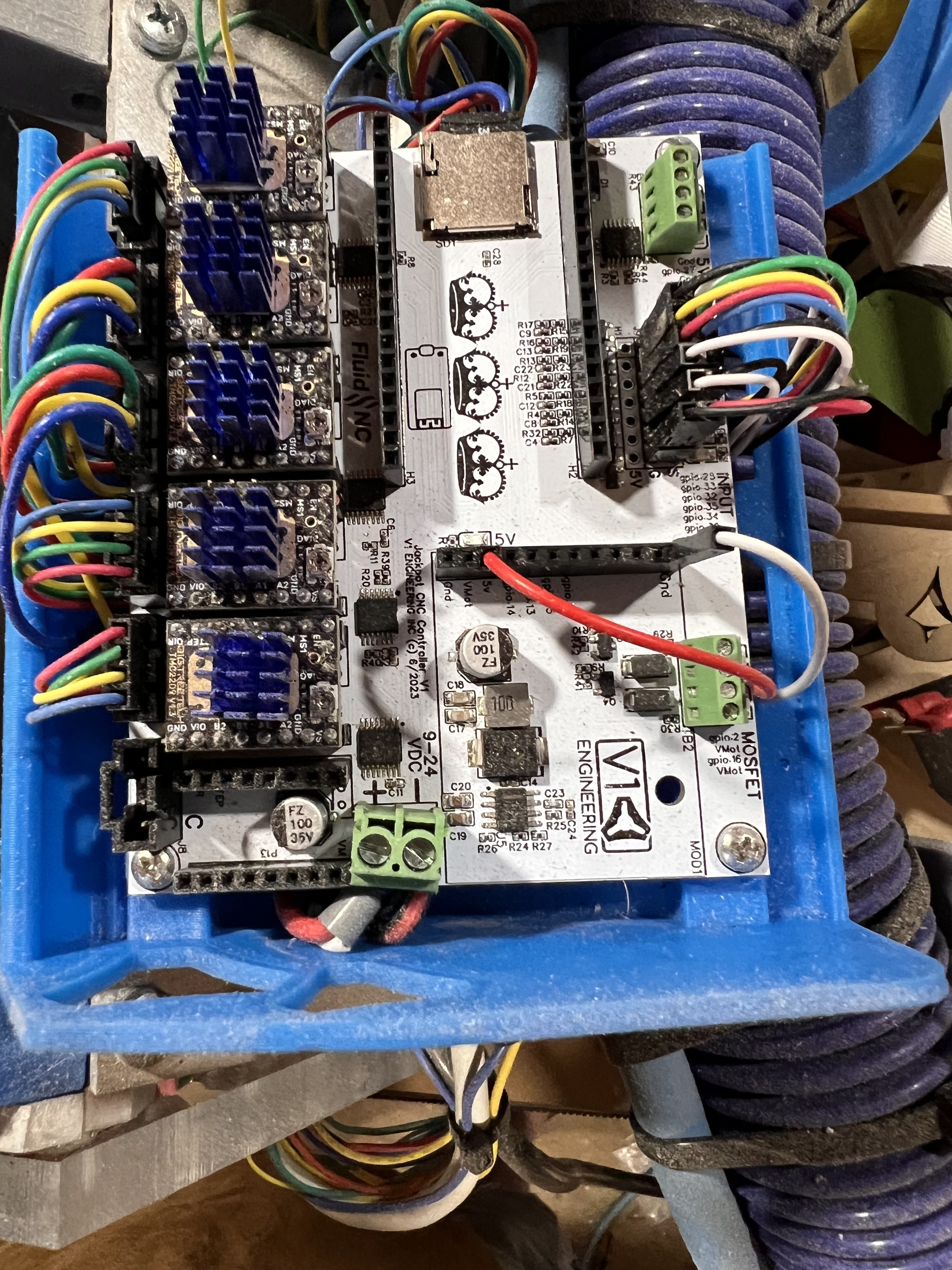

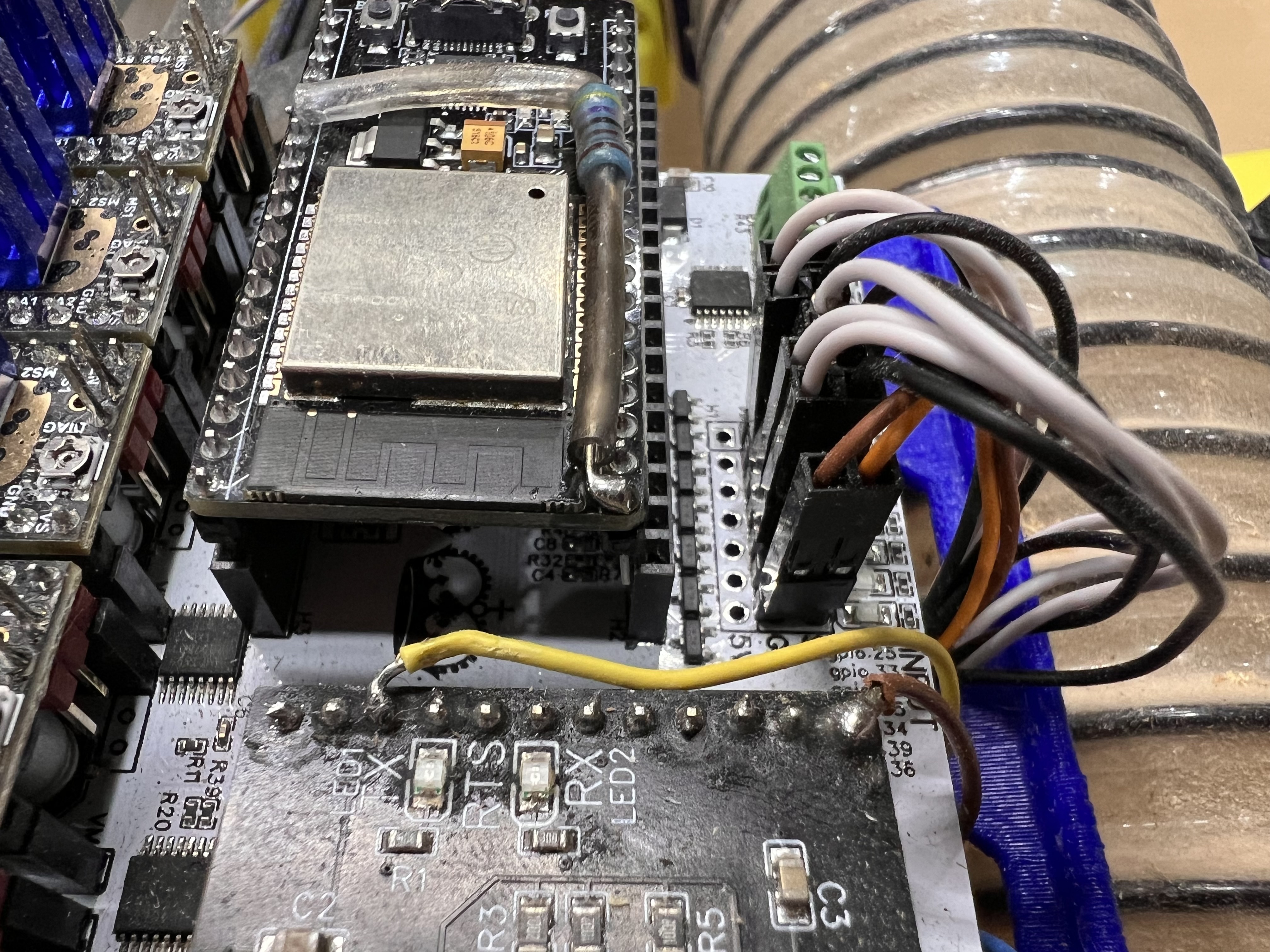

I’ve always been curious about this part of your build- why are spindle wires soldered to the expansion connector header instead of being landed in the RS-485 connector on the outputs of the expansion board?
Just to keep you guessing! LOL I’m just Joking.
Those aren’t the spindle wires. Those go to the second ESP32 for WLED. I needed 5v from the jackpot and that’s the easiest place to get it. On my other machine i just have dupont wires in those locations.
How far is the power run to the 2nd ESP32 you use for LEDs? That seems like it could.be.a source noise/resets/dropouts. Best practices would be to twist the wire pairs together tightly, and use some decent sized capacitors at both ends of that. Or use VMOT and have a DC-DC buck converter at the 2nd ESP32 if the run is very far.
Your motors going crazy seems like the steppers are beng reset, so even if the ESP32 isn’t resetting, maybe the 2209s are. If one resets at any time, it may default to different steps/mm and drive current than was loaded by FluidNC.
So your issues seem to me like one or more of the TMCs is gettng impcted by noise from either the spindle or the LEDs or both.
I have read that can be a problem with the wiring coming from the RS485 if its not shielded twisted pair. While I did use shielded cable its not twisted pair. And it runs underneath X Y1 and Z1. Y1 and Z1 are the steppers I’m having trouble with. I’m going to try changing the cable routing to get it away from those drivers and see if that makes a difference. And my shielded Cat6 should be here Wednesday so that should hopefully take care of it as well. I never thought about the power coming from there for the second ESP being an issue. It hasn’t caused any problems on my other machine. Its about a 2’ run from the jackpot to the second esp in the beam. And its not twisted at all. I will look at changing that to something better. I’m not using the 5v outputs but I wasn’t sure if they would supply enough for it. The others are being used to control presets on the ESP so cant pull from there. The other option would be take 24v from the main power in and then use a buck converter down to 5v for the ESP.
Maybe just pull that wire out of the box and run it out the logo port. Seems like that could be an easy thing to try. From there try not to route it tightly with other stepper wires that could pick up noise.
