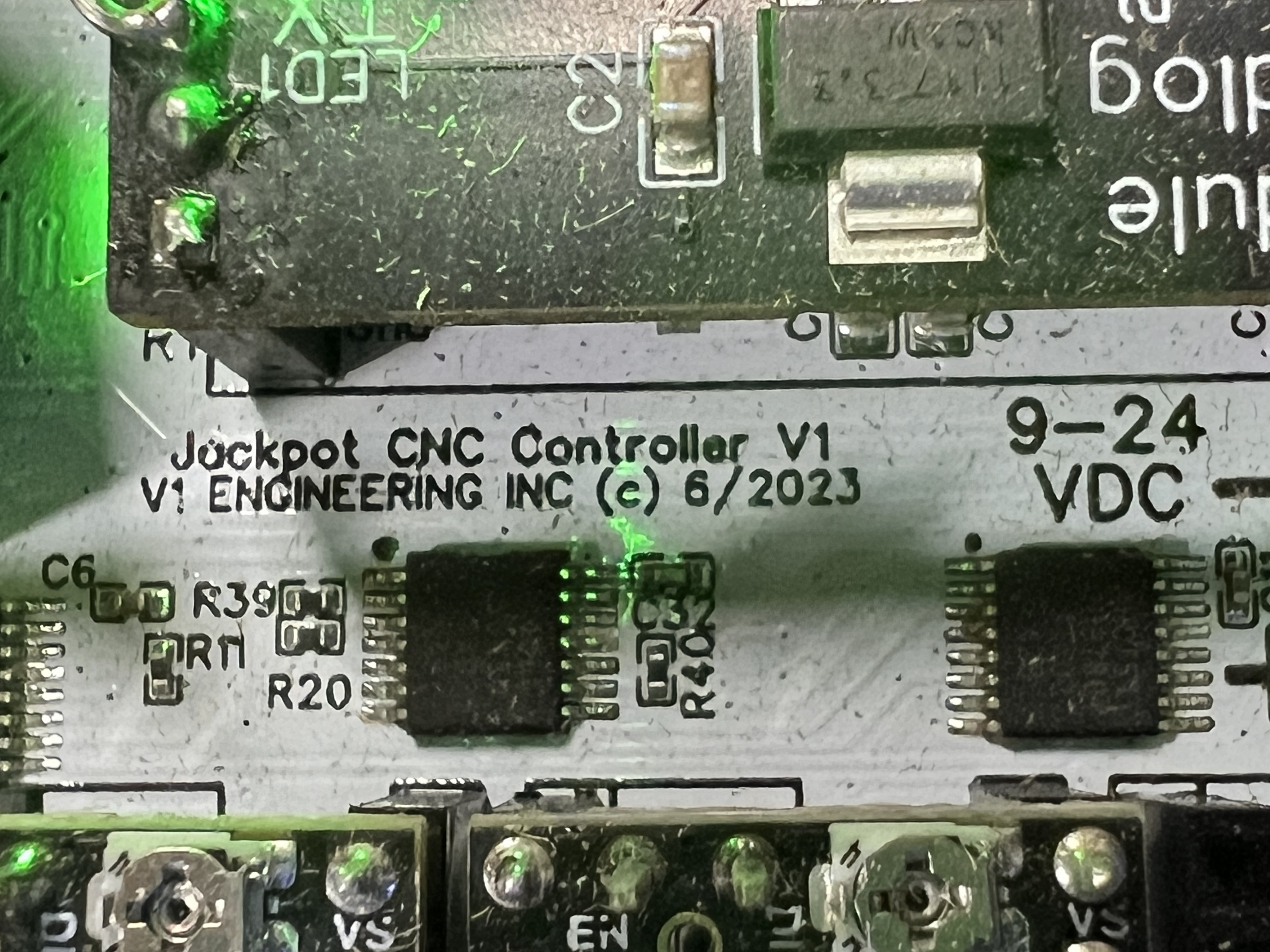

Jackpot only moving one stepper
Lately I’ve had random issues with only one stepper moving when jogging Y or Z. It only happens in a jog, never when running a job or homing. And its completely random so far. I haven’t figured out how to make it happen. Just wondering if anyone else has run into this and if so what did you find?
Running fluidnc 3.7.10 and @vicious1 config. Only changes were I bumped the driver current up and changed the pins for WLED. Its been running fine. Did it once the other day then today its done it 4-5 times. But hasn’t in the last hour and I’ve been running several small jobs back to back with a lot of movement
Does it go away when you power cycle?
Which version of Jackpot do you have?
Which ESP-32 (MicroUSB or USB-C)?
Does your ESP32 have a pullup resistor installed as an add-on?
I ask because we’ve seen a few instances where some ESP32s don’t boot properly, and if FluidNC doesn’t properly set up one or more of the steppers, then weird stuff like that happens.
I’m curious if it happens to you during a jog, and you power cycle the Jackpot, if the problem goes away (another indication you may have one of the ESP32s that needs the pullup resistor added)
I also have not tested 3.7.10, I still use 3.7.8.
Seems to, for a little while. But its not usually fresh after a power cycle when it happens. Y I’m forced to power cycle. Z I just home again and all is well. Like I said its very random
micro usb. No pull up resistor.

What ESP32 is on your board?
Still using the spindle?
thats happened a few times when FluidNC didnt boot properly…
micro usb

But not in the middle of a cut, that part is really odd. How do you lose communication/settings with a driver mid job?
Have you changed the driver current from stock, any chance of them overheating and one not moving?
Does FluidNC spit out any error messages if a TMC driver goes into thermal shutdown? Where is that displayed on the GUI if it happens?
In the terminal, you will see something I would guess. If you do not reboot, you can scroll up to see it.

I did bump the current up a little bit. It couldn’t home Z at the settings it was at. And I have your temp gauges on all of the steppers and they are WAY cool compared to when I had the SKR on there. Next time it happens ill keep an eye on the terminal and see if it pops up anything. I didn’t even think to check before.

More than the current on my newest configs? How much? Do you have a fan in your case or a lot of room for airflow (tidy wires)?
Hmmmm also you are running LEDS…maybe dissconnect them to make sure they are not interfering, or messing with the power supply.

Also it didn’t stop running the stepper. They were both running, just at different speeds. Even after i canceled the job and tried to home the Y1 stepper was outrunning the Y2
I will give that a shot. I’ve been lazy and still haven’t tied the grounds together so that could be part of it. They are on a separate power supply from the jackpot if that matters
Absolutely. A voltage differential can do all sorts of odd things. This is suspect #1 for me right now.
