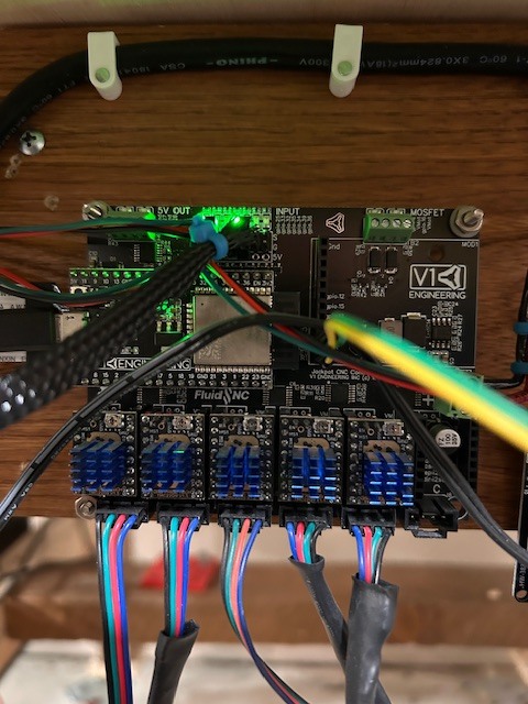

Which version of Jackpot do you have? If not sure please post a pic of it. And just to make sure you are running this on a Primo not a LR correct?
I’m running a Primo. I believe the controller is a V1.
What are the green and yellow wires connected to?
Also, the 2 black wires and the red and green wires need to be moved. They are going directly above the wifi antenna. This will effect your ability to connect to the Jackpot V1.
WIFI signal is strong. I don’t have a problem there. The green and yellow wires are 5V and ground. I use them to signal a relay for my cooling fans. This has worked very well in the past and I have no issues with that modification.
You still need to move them you have them directly over the wifi antenna. That ESP could become unstable because of it.
You need to use a 5V output, tying directly into the 5V rail is not a good idea. You can have them trigger at boot or anytime you want. The outputs are the safest.

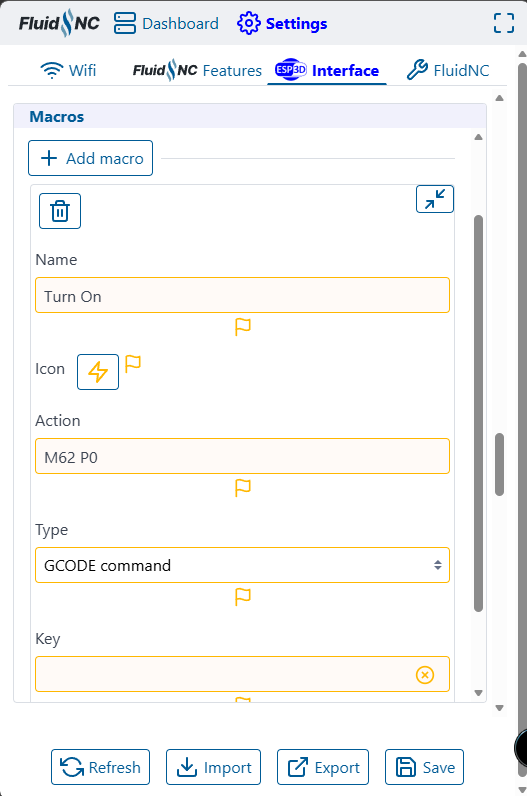

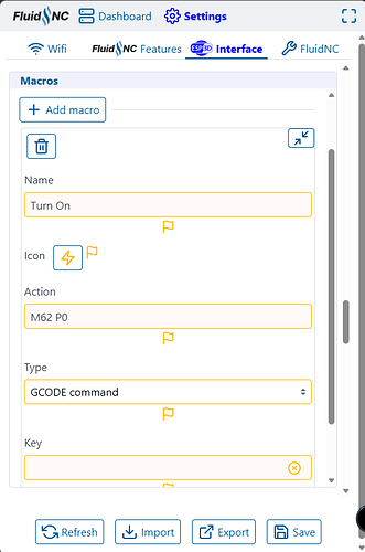

Ryan, I have made all the changes. The M62 PO works well. I just don’t nknow how to create a macro. However, after installing the 3.9.9 I’m back to the old issue. The controller des not respond to commands. I see the G code scrolling but the machine doesn’t do anything. I can’t figure out what the issue is
What version of the WebUI do you have? If it’s v3, go to Setting → ESP3D Interface → Macros → Add macro. Enter the details similar to the example below and click the Save button at the bottom.
Also, make sure you have these selected so the macros display on the Dashboard.
