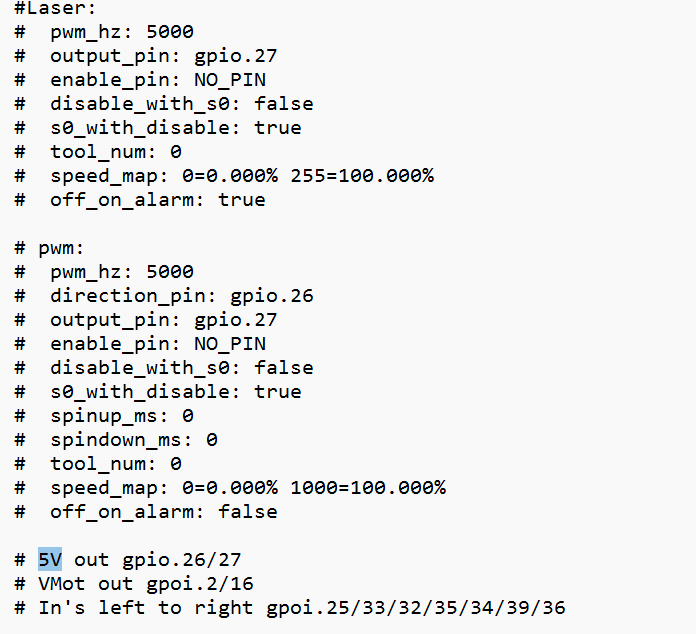

My lights on the 2 5v out terminals won’t come on, the mofset lights come on when I press the mist or flood button, but the 5v out not working.
Show that section of your config.yaml.
Most likely you configured the board to use the VMOT outputs and not the 5V outputs.
Also, take note that the VMOT outputs are low side switched (The VMOT+ is always present, it’s the ground that gets switched on/off).
This is what is commented out
#Laser:
pwm_hz: 5000
output_pin: gpio.27
enable_pin: NO_PIN
disable_with_s0: false
s0_with_disable: true
tool_num: 0
speed_map: 0=0.000% 255=100.000%
off_on_alarm: true
pwm:
pwm_hz: 5000
direction_pin: gpio.26
output_pin: gpio.27
enable_pin: NO_PIN
spinup_ms: 0
spindown_ms: 0
tool_num: 0
speed_map: 0=0.000% 1000=100.000%
off_on_alarm: false
5V out gpio.26/27
VMot out gpoi.2/16
In’s left to right gpoi.25/33/32/35/34/39/36
