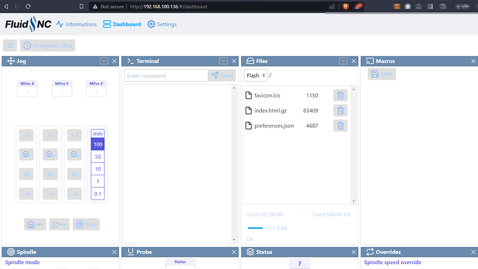

Thatā€™s it running on the ESP32 directly talking to FluidNC now. Iā€™m working through adding support for the new protocol to the firmware.
Iā€™ll have to work on SD card support last since these donā€™t have an SD card slot to test with. Iā€™ll need to have it working pretty well before I put it on my Jackpot directly.
But Flash access works, a lot of the commands look like they work, and Iā€™m working on getting the Settings page stuff together right now.

Whatā€™s this then? Are you updating FluidNC UI to have ESP3Dā€™s 3.0+ Web UI? Until now, I thought FluidNCā€™s fork was based on some ESP3D 2.1 build?
Havenā€™t used FluidNC yet, so I have no opinion on that. I do like ESP3Dā€™s 3.0 Web UI, especially macro and custom keyboard shortcuts. Have used ESP3D 3.0 on a ESP8266 wifi module connected to SKR, and also on a ESP32 module plugged into Octopus. Cheers!
Kinda both. Working on adding WebUI3 support to FluidNC, and FluidNC support to WebUI.
FluidNC guys have been talking about it for a while but donā€™t have time. Their goal is to not have to manage their own fork anymore. Mitch added his own revamp fork of 2.1 just so he didnā€™t have to bother Luc and interrupt them from making progress on v3.
Neither of these things are under my exact area of expertise, but I have enough experience across a lot of different development technologies to be dangerous enough that I can probably make it happenā€¦weā€™ll find out soon enough :slight_smile:
That sounds awesome. Would be great for Fluid easily pickup all the updates going into ESP3D WebUI 3.0. I successfully submitted some minor edits earlier this year, and then tried submitting some other convenience items, but lost interest (or got distracted) after encountering unexpected resistance for this change. Will look out for your edits, hopefully others here interested in this might be able to support you if needed during pull request discussions :slight_smile:
