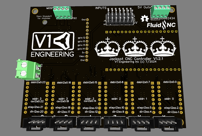

Does 9% overall cost increase (inc pcb+assembly) for rear mounted terminal connectors sound right? For the BackJackPot edition?
Think I messed up the BOM, some parts out of stock, just threw something together to understand rough cost difference. Didn’t move expansion connector back, or make 5V or MOSFET terminals inwards, this is just a rough concept…
No that sounds way too cheap, $1 more per board probably what I pay for the esp32’s/
Make sure the one side is economical and the other is standard two side.
If it is only a $1 that is wild.
Remember there are probably nearly a thousand of these out here. Any board edit means I would now need to make a second jackpot board box as well. Accessing both sides to wire it up means you have to remove the board to do that. Makes wire management a bigger pain.
Yeah, variants for something like that can slowly bury you.

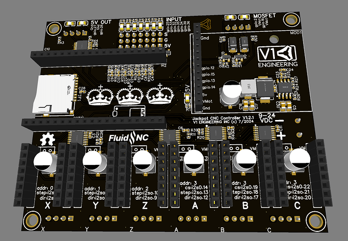

If you’ve got 2-sided PTH parts then typically one side gets wave soldered, one side gets hand soldered. Hand soldering ‘should’ be ok, but you’ll definitely see a higher failure rate over time on those parts. It’s plausible that with high enough quantities or by specifically requiring it you could specify a selective soldering process but then you’ve gotta be careful of respecting courtyards to keep components away from the terminals that are being soldered relative to the dimension of the selective solder nozzle.
That said, I wouldn’t expect it to be much more than $1-2 per board for 24 terminals. I think I’m paying ~$20 USD an hour total for hand assembly/testing time and it’s probably 2-3 minutes for stuffing and soldering those parts.
There shouldn’t be anything preventing you from desoldering and flipping the connectors, either, from what I can see? That’s a pretty straightforward mod to do if it improves your specific setup.

Personally wanted to explore and experiment with this concept/approach, but, I have no idea if anyone else would want this?
If offered, I’d happily purchase a Mostly Assembled JackPot SYOWC edition (solder your own wire connectors). Which comes with the connector parts for power, endstops and steppers, but the Maker decides if, and how they want to connect. Some makers might decide to use the connectors provided, or, their own 2.54 pitch connectors, or, just straight up solder wires directly to PCB (I’m looking at you Dupont haters :-).
Either way, JackPot SYOWC edition would be cheaper to fabricate and partially assemble for fussy pants makers like myself?
Ended up using dual row 90 degree dupont pin connectors for the endstops, bent slightly less than 90deg before soldering, to help connectors clear adjacent solder joints. My thinking was to help the endstop wires stay within the confined braces (RC2).
Have no idea if being so close to the router will be a RF issue at runtime, will see…
