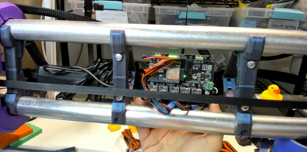

Making JackPot edits? Was going to try the following, and report back on results, but am sharing now incase you want to include some of these edits in your next batch…
Already considered moving terminal connectors to bottom of the PCB? i.e Move end-stop, power and stepper wire connectors below.
Why… For in beam jackpot setups…
  • Helps keep wiring clear of the tiny ESP antenna easier.
  • Helps direct uninterrupted air flow over the stepper heat sinks.
  • Enables operator to see endstop LEDs and misc controller lights.
  • Clear, or windowed front strut with relatively clean JackPot PCB will look awesome.
  • Smaller enclosure potentially for non beam installs… Mounting terminal connectors underneath also means some could potentially be flipped facing inwards helping reduce overall width/length of enclosure, e.g. Bottom inward facing power connector.
  • @ RF experts, would running wiring under PCB (wirh a ground plane) help shield and preserve wifi signal transmitting on the front side?
