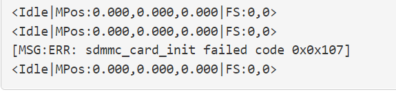

Trying to load squaring gcode on the new Jackpot board on my LR3 but i cant get it to read the SD card.
Card has been formatted and verified FAT32
Card works no problem in the computer, and worked fine in the SKR before now
Tried a brand new card, also formatted FAT32
When I hit refresh on the SD Card section on the Web UI I get this error in the terminal…
Any ideas??
Tagging @vicious1 because I know he likes to know about problems with the Jackpot
Try using this
See SD Card Formatting in the FluidNC wiki for details
" Some people have trouble when SD cards have been formatted by Windows, but were able to solve the problem by formatting with SD Card Formater"

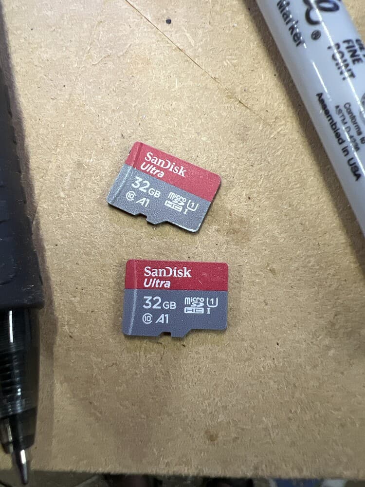

Class 6 or slower.
I have one of these
  • Class 10, U1 speed rating, with read speeds up to 100MB/s
  • Class 10 - UHS-I, U1 speed class performance allows for fast and smooth continuous HD shooting and full HD video recording
Have had no issues using it.
Maybe it is the A1 A2 designation to stay away from? Those seem to indicate a minimum speed rating, I can see that being a problem?
Possibly. The FluidNC wiki only mentions size and formatting as issues.
To be honest, I normally just buy whatever. Buying these cards for the Jackpot was the first time I ever went and did any research into what any of those symbols mean lol.
I bought those just because they were the cheapest 32GB ones I could find on Amazon. I think I got 3 for $11 or something like that
Same. The ones I have I got on sale from Amazon to put in some Reolink cameras. Just have been too lazy to take the cameras down and install them lol. So instead of buying more I thought I would just use them in the CNC. They worked great with the SKR/TFT. Never once thought they wouldn’t work with the Jackpot. Ordered 2 more from Ryan today.
