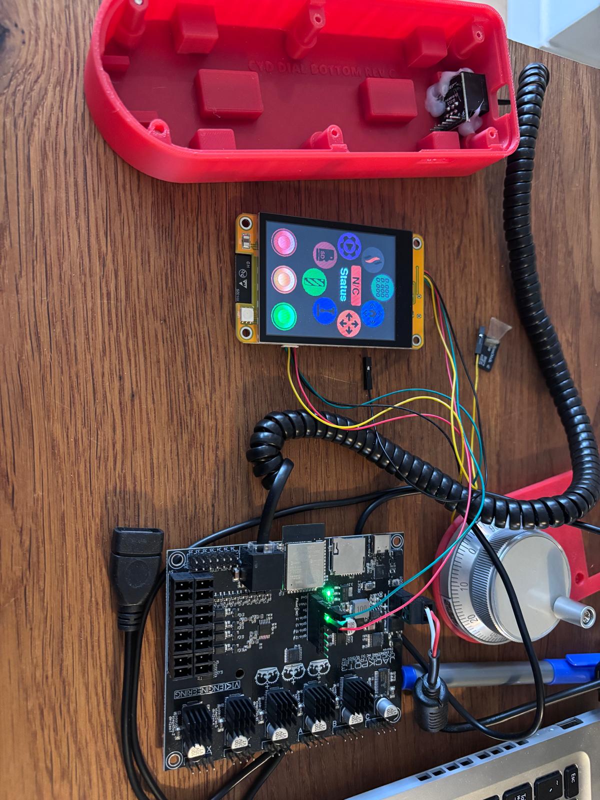

Ok I did some more testing.
The good thing is the CYD is still working. I connected the gnd and V5 of the CYD to the gnd and v5 of the pins of the expansion module, and it booted up normally.
Next I did some continuity and Volt measurements with my multimeter.
All connections are still working. When I power up the Jackpot I have 4.9 volt at the RJ11 connector of the pendant!
However if i connect the CYD to the rj11 of the pendant the CYD will still not boot up. I measured the voltage and it is only 4.5V. Could this be the reason it does not boot?
When I connect the same wires to the jacpot 5v directly I get 4.9V at the CYD and it does boot.
I try switching the wires but keep getting the same result. So in the last step from the pendant RJ11 to the CYD I have a drop of 0,5V.

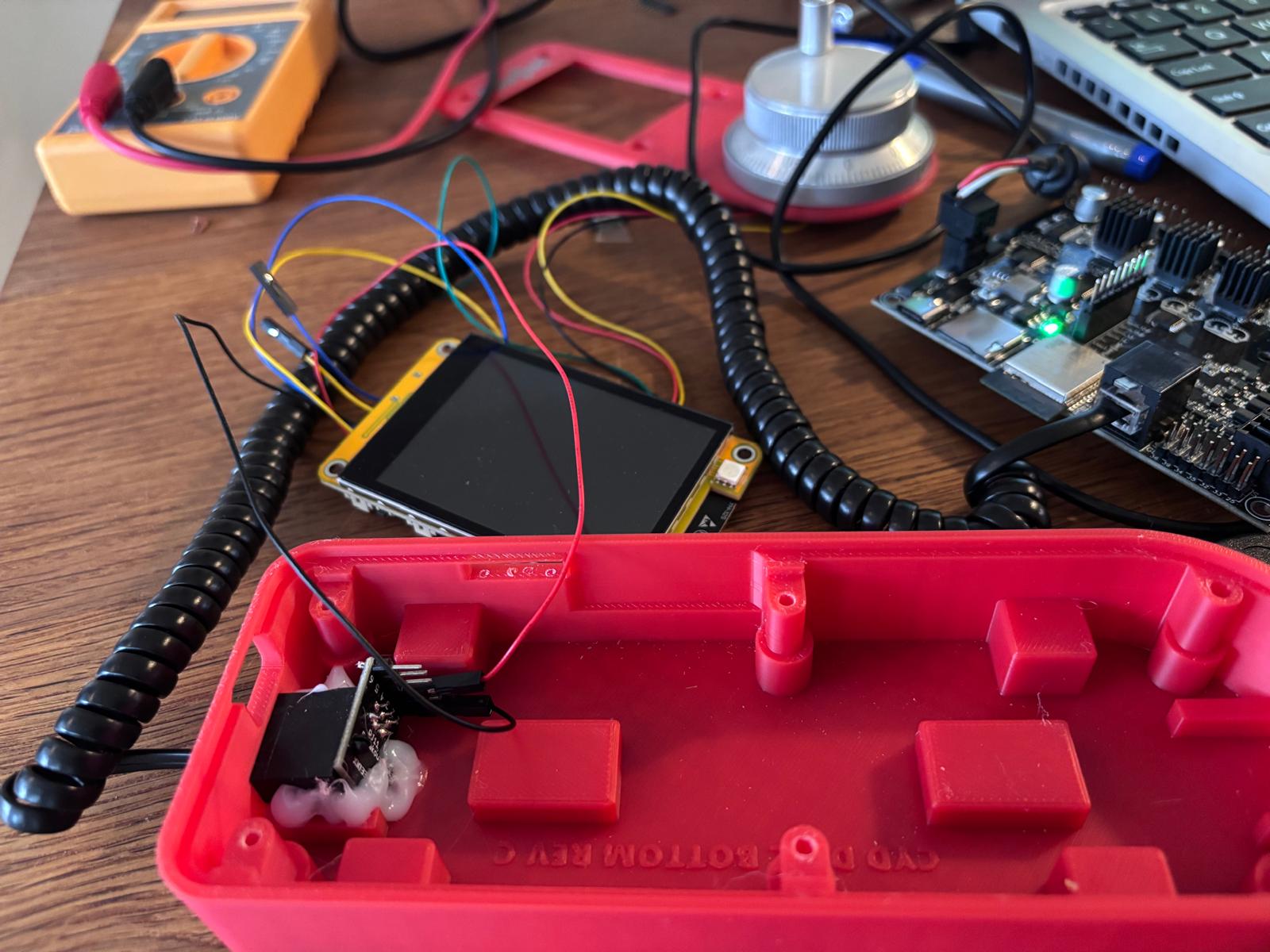

(last picture I used another wire set, where black is now ground)
I guess this would be a solution… But still strange that it does work for others, but not for me.
Hmmm, there is not much in between the 5V module output and the 5V pendant output. Does your coiled wire have a lot of resistance?
Is it still 4.5 at the end of the coil without the pendant plugged in? What is the voltage on the bottom of the board at the pendant plug 5v soldered pin?

I have 4,5 volt on the CYD board through the coiled cable, and 4,9 volt through the coiled cable without the CYD attached. Swapping the wires from the pendant to the CYD does not help.
Yes, IR drops and loading of the 5V rail means that a CYD will be marginal without using a DCDC converter and powering with VMOT.
It varies by the cables, and coiled cables have much more total length in general so your IR drops are relatively high.
Repeat your test with a non-coiled cable and see what you get.

When the CYD is not connected I have 4.9v at the end of the cable.
When the CYD is connected I have 4.5v at the end of the cable. I just measured and it is already 4.5 at the pendant RJ11 connector. It still is 4.9 on the Jackpot, so before the cable.

Or I might order some MP1584EN buck converters and use the VMOT. There is plenty of space to add this in the pendant.

I just tested with a normal not coiled cable and it is booting up fine. I guess the coiled cable is of a low quality. Thanks for your help every one. I now need to connect the board back to the cnc and see if it also actually works with jogging etc!

I installed the jackpot back in the cnc and the pendant is working! (For now without the buck converter) I’ll keep it this way, when I have issues I can always try to add this. For now I will also stick with the flat cable. If in the future I run into an old free coiled telephone cable I might retry that.
