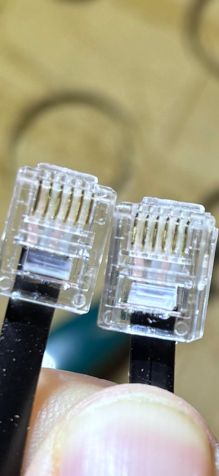

Ok, I think I was not clear. I have a 4 wire cable. I cut of the RJ11 connector and crimped a new 6 pin RJ12 connector to the cable. With the wires in slot 1,3,4 and 5.
You custom crimped your own 4-wire cable into an RJ12 connector? I think I want to see pictures of both ends at this point, of the individual terminations at each end of the cable and the connectors looking into the jackpot and the CYD.
The other reason to not do this is the RJ11 connector can bend the pins in an RJ12 and if you bend or short those there’s another way to damage things.
yes, I custom made it (because i wanted a coiled up wire, which are usualy 4 wires). I tested the cable with a cable tester, confirming the connection is continous for channel 1,3,4 and 5. So no wires are switch or crossed. I cannot take pictures right now, I will have a look again tomorrow. I will also inspect the RJ11 on the jackpot for visual damage.
Good plan. If you can custom crimp your own RJ11, you’re mostly there to custom crimp an RJ12.

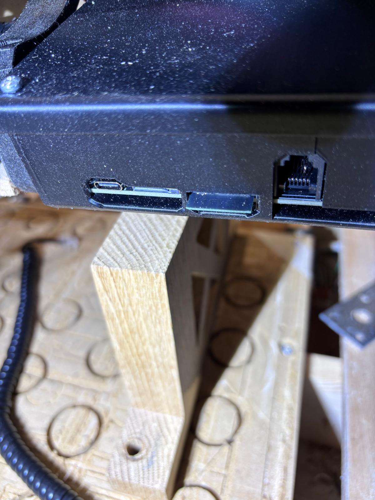

I was also able to visualy inspect the RJ11 connector on the Jackpot3 and pin 2 (second from right), does seem affected. There is a little spot on the pin, and the pin is a bit bended downwards. It defenitely took a shock. However this is pin 2, which is not used. Not sure what it is connect to on the board though. I will try if I can get my hands on a 6 wire straight cable, but not sure if this will make any difference.
That’s not good. Pin 2 is VMOT. So if it touched any other pin or connector it fried it. I know from experience. I was testing a different RJ11 connector and accidentally touched pin 2. I fried my Jackpot 1. It sounds like the built in RJ11 connector saved your JP3, but may have fried something on the CYD.
The pendant was not connected when the initial shorting happened. However I might have connected it with the same faulty cable and the jackpot at a later moment. Not sure anymore. The CYD still works when connected to usb c.
