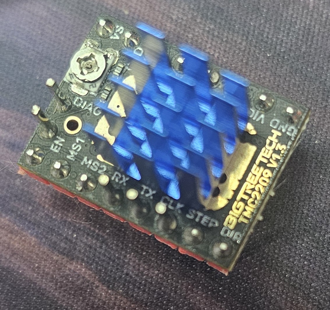

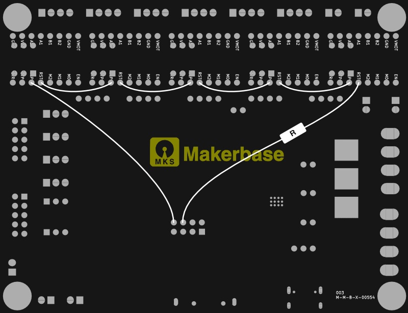

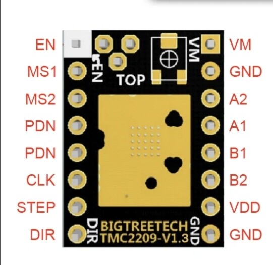

I’m not an electronics guru by any stretch, but I like to think I’ve got a few brain cells to run together. If anyone had noticed this, no one has posted it. On the FluidNC wiki page regarding the TinyBee, specifically where it covers mods to be done for UART, there is a rendering of the bottom of the board, showing where to daisy chain the GPIO16/17 wires. I followed all of this, gotout the meter to make sure no bridges or bad joints. Everything looked good. No UART communication when booted. My questoin/issue comes with… why is the CLK pin on the driver involved in this at all?? The 3rd pin over on each socket is the CLK pin on the BTT TMC2209 V1.3 drivers. On the bottom of the board, it’s simply labeled at “P”. I’ve included images of the rendering and the driver. Am I missing something, or is that wiring mod just wrong? Normally a TX line runs to RX and vice versa… never seen one go to CLK! I’m still working on it and where the wires should go, but was thinking maybe I stumbled across a reason so many people have issues with this board with these drivers in UART mode.

You haven’t posted high resolution pictures of your as-modified tinybee, nor of your modified TMC drivers.

WARNING: depending on the drivers you are using, you can destroy your board if you don not set the third DIP switch on every driver to OFF
At first glance at the FluidNC wiki, I don’t see where CLK is involved at all…
For reference if others want to take a look, I’m including it below since you didn’t link it.
