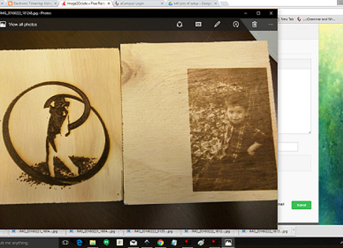

I’ve released version 1.0 on GitHub (https://github.com/Uthayne/3dpBurner-Image2Gcode)
This update includes:
-New optimized raster algorithm. Skips white space in the image to prevent unnecessary travel moves. This includes getting rid of all the extra move commands. This feature is currently only available in horizontal scanning mode. On the attached picture, this resulted in a file memory size decrease by 42%! (11 MB to 4.6 MB) and an estimated time savings of over 36 minutes (1:21 vs :45)
-Optional decimal precision on laser power levels. Still undetermined if this matters or not, but the feature is here by request from @Leo69.
Pictures and evidence below:

Ok, it’s been a while, so time for some news from my end:
Will test the new version on the weeken - if I manage to fix the Marlin code to my liking.
I was able to find the algorithms for the laser power in the Turnkey release and to my surprise all previous postings I read about it failed to state the right facts.
According to the algorithm used the output is regulated between 0 and 100% - just like on the analog/digital panel running the original controller.
But to make things worse everything above 100 is simple cut off!
That means you get true percentages for the laser power - guess that’s why there are several safeguards to set all values above 100 down to 100.
Problem with this approach is that no only the bandwidth of the PWM signal is limited but also the available output.
I guess some people here are using these chinese K40 clones, so I will upload the hex file of my firmware once I got working with a more defined PWM system.
It is for the standard conversion using two pins, one for laser on/off, the other for the PWM signal.
Let me know if anyone wants to test it once working and I will include the basic shematics and pinouts just to be sure we are on the same project here.
Can’t wait to test the new software with proper PWM levels, although it will take me a while to modify the safeguards and change the algorithm.
Means I have to connect all to my oscilloscope, check the original PWM signal and compare it to the modified version.
What I want to achieve (if possible) is to increase the limit to 1000.
Meaning 1000 is full power, 500 equals 50%, 250 25% and so on.
Based on my tests with the previous I2G version this range should be sufficient for 8bit engravings on our CO2 systems.
Also found some code bits during my search in regards to the buffering of the movement commands.
Have to see if I find it again but it looked like everything was modified so that only G1 and G7 moves end up in the buffer - but not single M or S commands.
This explains why there is always a stop when speed or power levels change - the buffer is emptied with the last movement command and being filled again with the next set of movement commands.
But before I even start messing around here I will do some more tests with all commands integrated into the G1 and G0 strings.
Ok, looking very good so far :slight_smile:
The first try with the changed firmware seems to overburn in the dark areas but that will be addressed with lower power levels for the next run.
For the first time ever I can control the laser power with around 13byte accuracy, yes had to adjust the available power levels from 0 to 10.000 in order to get the control range required for these insane power levels.

Apart from being burnt deep in the dark areas the engraving so far has a never seen level of detail.
Will see to get the power parameters optimized so I can do a proper engraving on 3mm plywood.

Here are some of the test engravings so far:
old firmware
This was done with the original Turnkey Tyranny firmware, as you can see there was no chance to get results.
New firmware before clean
This was the first engraving with the modified firmware but the power settings were far from good.
after cleaning
Same one but with the burnt stuff removed.
better settings
Here we are with the final firmware mod and some more defined settings for Image2Gcode.
after cleaning
And here afer the cleaning…
So who said 8bit photo engravings can’t be done on a CO2 Laser machine?
All it takes is the great guys here giving us a fantastic tool and some Arduino with the tight firmware.
No expensive 3000$ machine or Picengrave, just chinaware combined with good freeware :slight_smile:
Like Hannibal always said “I love it when a plan comes together!”

Image size is about 60x73mm.
Resolution 300DPI, estimated time in pronterface was 13minutes but took 42minutes to do.
And done just with standards, not the optimized rastering, this will come in the next testrun.
Will also fiddle with the threshold to check how it works.
But as said, so far I am impressed.
Guess it means you have beaten Picengrave on all accounts here :wink:
Not sure if you can spot the bright areas left of the chin and under the chin - they are actually toally black in the original image but for some reason did not get any laser power during the engraving, like being reversed out.
And as requested with optimized rastering, set to 1% as everything higher will ignore too much image.
Maybe finer settings here would be nice.
optimized rastering
Estimated time in Pronterface: 8:07, real time 35:50min.
But this time I used a resultion of 0.12 to see if there is much difference in detail, also power was between 560 and 815.

Almost how I would like it:
glass2
I noticed some coding issues in my last test, apart from the ones mentioned above.
When setting the resolution to 0.12, 0.13, or 0.14 with a bigger engraving I got a lot of weird Y-axis moves before the actual job begins.
Like as if it is trying to engrave the first line vertically instead of horizontally.
There is also often a massive difference in filesize when going up or down just 0.01 for the resolution.
As if sometimes mostly lines instead of dots are used.
This last one made me think again about experimenting with the code to combine the movements and later to include the power settings into the movements as well.
On a simple calibration graph the time went down from 11minutes to just over 3minutes.
But for this to get the same result I had to increase the power levels manually to adjust for the higher movement speed.
The current way of generating the G1 moves blows the files up too much.
As long as there is no change in power all G1 commands before the last can be deleted to create a single line instead of dots.
Currently I have to set the resolution to 0.2 and the image DPI to 100 to be able to engrave a 23x17cm image, would be great to try that again in a much finer resolution :wink:
