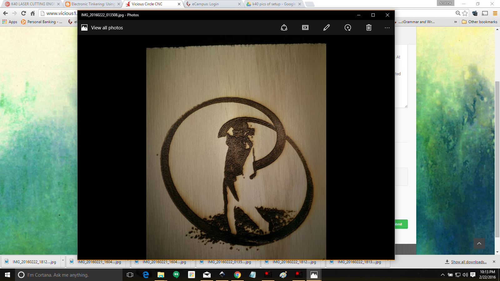

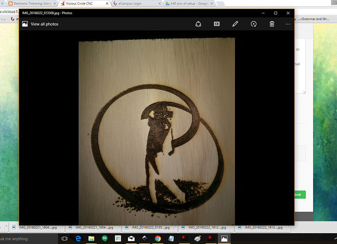

Here is the last engraving, which was totally overburned.
Done on hardwood (has too much resin in it too) with the power levels between 6 and 16.
Before cleaning:
On hardwood before cleaning
After cleaning:
On hardwood after cleaning
As you can see there are also pinholes burnt into the wood, this happens almost every time the power changes or the head stops.
Seems to be a problem in the Marlin firmware too or at least related to the slow processing of all the code.
Bit longer and the other engaving is done for comparison.
And here we go:
Power between 6 and 8
As you can see there are no 256 shades of grey, just next to nothing for withe and three more - everything from 6 to 8 in solid numbers only :frowning:

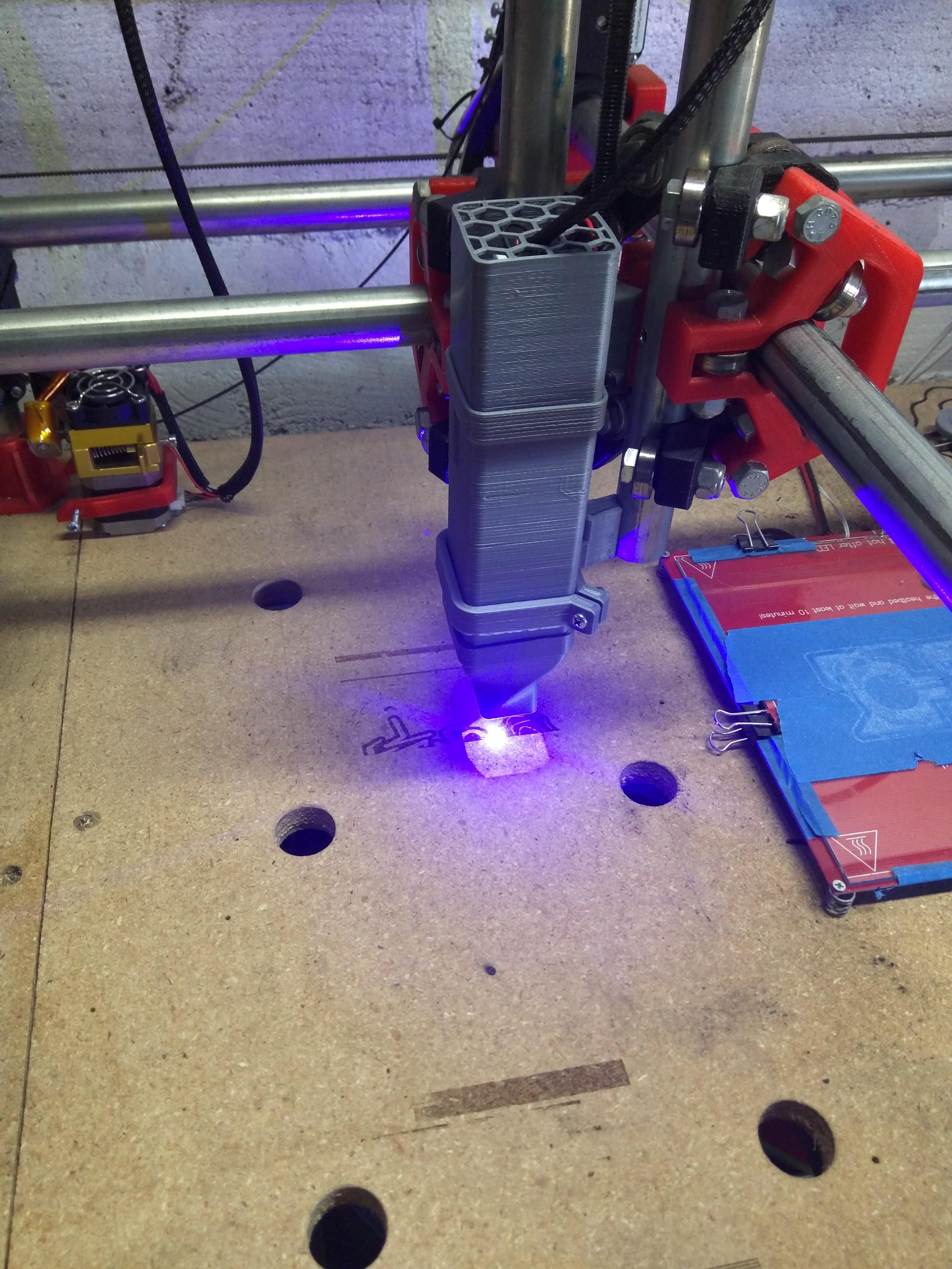

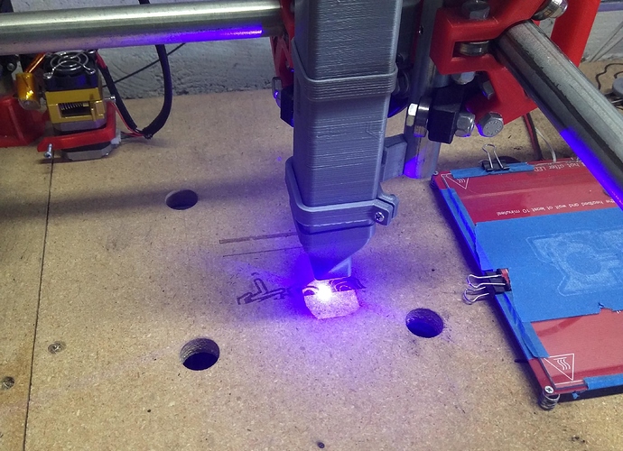

Things are working pretty smooth on my end. I did a nice portrait as a trial but The subject didn’t want her picture up here…bummer. I am having some small glitches that didn’t show up with some different software but I want to do some more tests before I say anymore about it.
I did a little focusing script for repetier, I’ll do a separate thread for it.
I like the honeycomb fan grill and that cool vortex twist on the end of your housing.you gonna post that design? If glitches seem speed related then it may be my fault for adding a bunch of decimals that Marlins 8 bit pwm can’t even process. I’ll make them optional on next revision.
