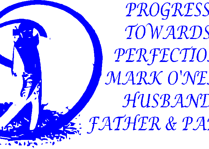

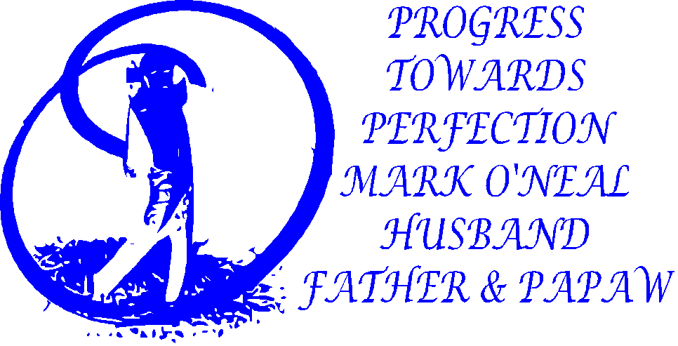

Man I cant wait for diagnal to be added to the newest version, for example in this acrylic job which I created in image2gcod v4, there was so much space in image that was not lasered at all due to white background after I removed original background in inkscape to seperate it from the image I wanted. Trace bitmap multi scan tool, so freaking awesome lol. Your program works so awesome man, seriously crazy sick man. I wonder a couple things though again knowing nothing of code writing lol. It possible to perhaps create a few general shapes that could be used to size around an image such as this one I attached in order to cut project out after print is done? Another question is could you possibly allow for dither to spread from 1 to say 5? I did check my marlin code as well as included it in a post last week and could not find where my feed rates were maxed out. I can only attach images here where others are able to include embedded in their post. Also tested on glass, tile, and metal but found that most use a laser marking material called ceremark, which creates like a printed ink design with no etching.

Great work! I really like what you’ve done. At some point, I would like to add vector engraving to the tool. With that, you could easily do what you want.
I can look into varying the dithering setting too.
Are you referring to line after line of simple G1 Y moves with nothing in between? I am aware of that, and I haven’t had the time lately to fix it.
Filesize increases exponentially with increasing resolution. So it’s to be expected.

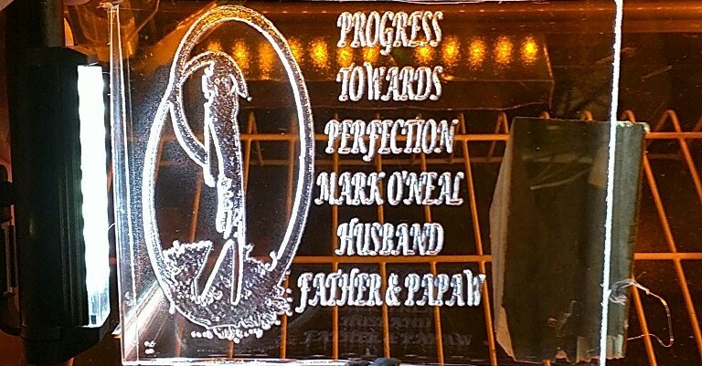

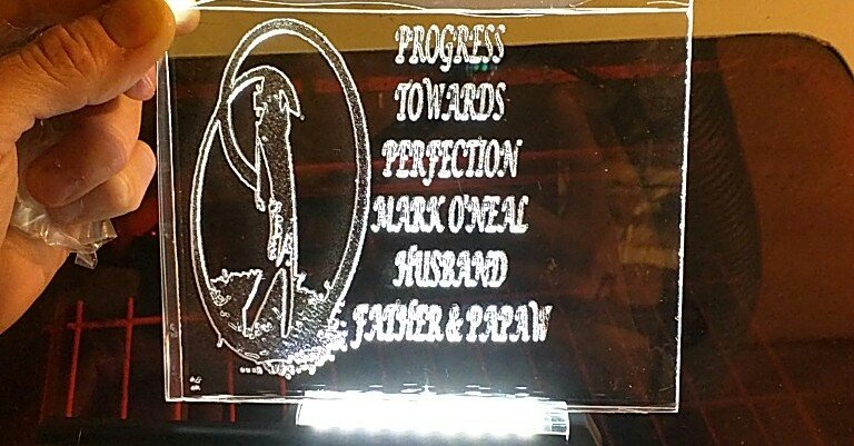

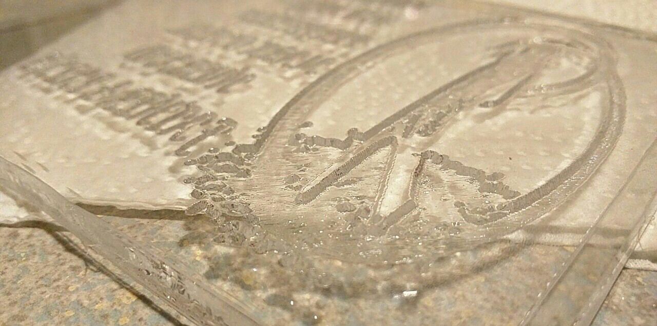

Man your my new hero lol, the wood engravings I have done also turn out awesome again all done with v4 of image2gcode, the image in acrylic was done at level 63 max 0 min feed 5000, which I can adjust on the fly via turn knob to faster or slower feed rates. At max 63 my amp meter on laser doesnt make it to mid point, which means the laser would burn at twice that value to hit 100% max laser power. which explains allot if you think about it because at 255 or normal max output for most in this group, I would be 125 or so above my max.
This image took about an our since it had to scan/print even the areas that were white in the image at 100mm by 100mm So when ever the diagonal option comes back into play in the new version of software I will be all over it lol to cut that time in half. There is so much that goes into getting an image ready to print and that is with using a tool that does the majority of the hard stuff for us, cant image what it is like to create a software to do the work like what you have done with image2gcode, absolutely amazes me. Thank you again for all your efforts man, have I asked you before if you have a donate page? to help further the process of development from folks like myself?
