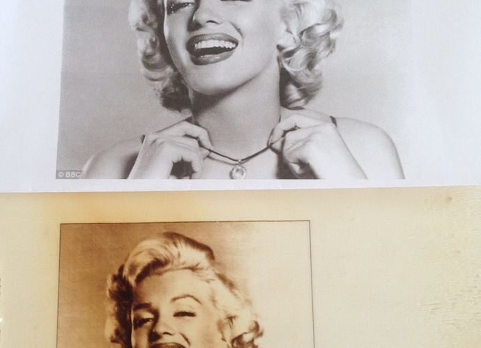

Yes i have done this too on back of a mirror, it is really really nice, better with diagonal engraving !!

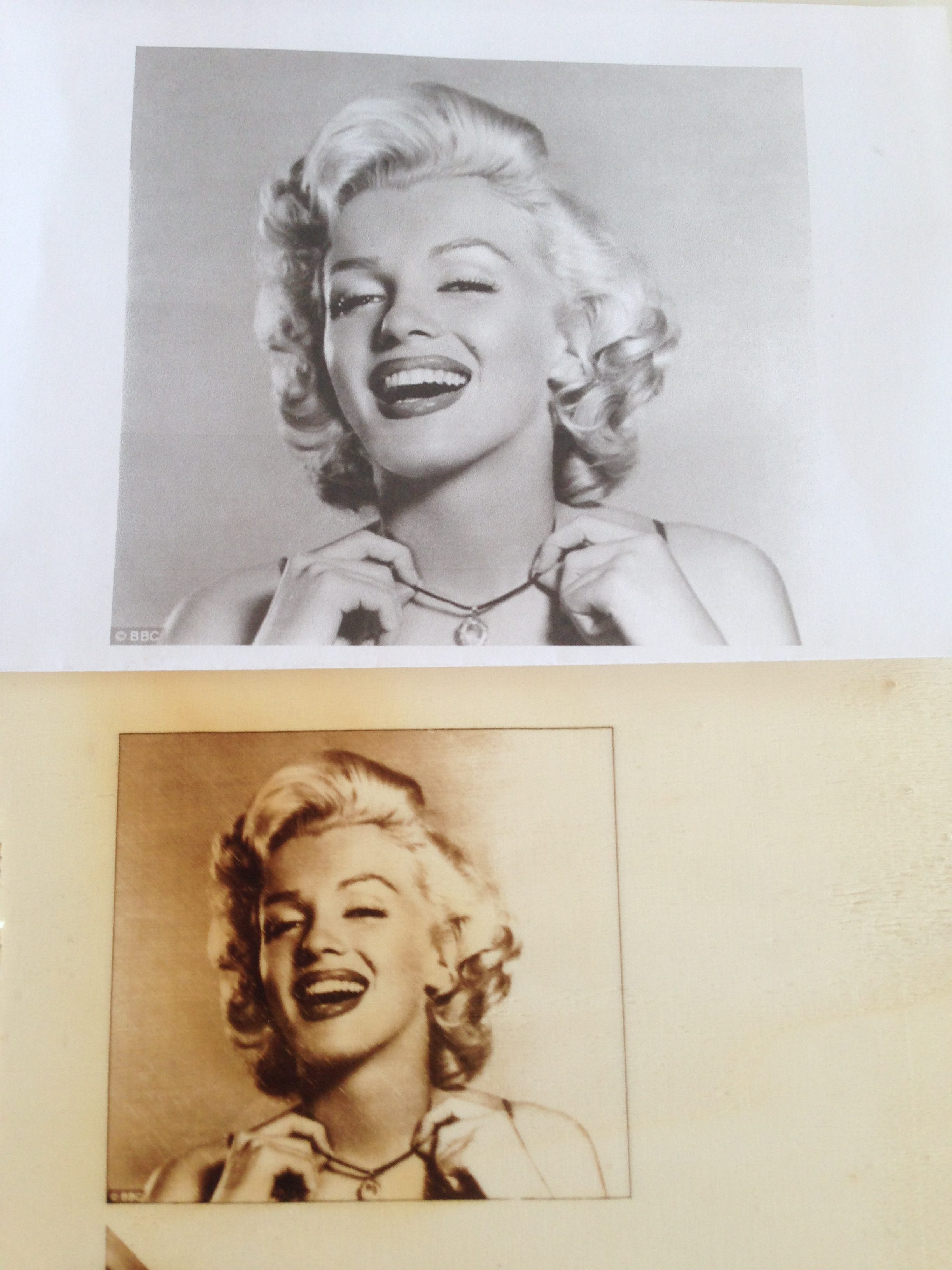

Looks really good.What laser are you using?
Thanks, Leo! For both answers.
This is a 1 watts single mod diode built as tool for my Stepcraft CNC router.

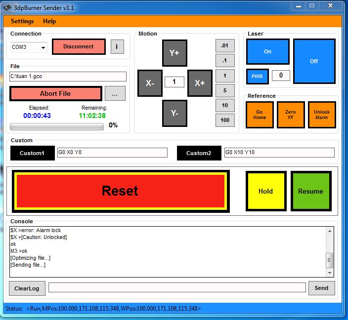

I created file NC by Image2Gcode v1.1. after that I load by sender v1.1 but it have error and Arduino card have beep
please watch image …
The sender software you’re using was developed by Villamany for GRBL based laser engraver running on Arduino Uno board. We’ve modified that software to run on Mega2560/Marlin based hardware. You’re not providing enough information about your hardware for me to even guess what the problem is.What exactly is the error message? What firmware and hardware do you use? What command activates your laser? I recommend posting your question on the 3dpburner site for a quicker response.
