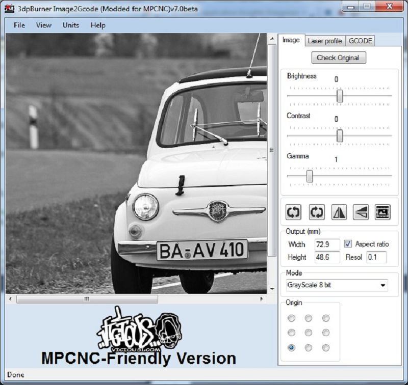

I ve made some changes to Image2Gcode,
because I need 0.0000 value for Laser min and 0.1024 value for Laser max Power.
At this point it don’t run well.
There are many Bugs, so I can’t set min Laser Value higher than 0.
The Funktion private float interpolate(float grayValue, float min, float max) makes not what I want.
The Orgin Funktion have also a Bug if I have a decimal value of picture width or high, then I got a “,” and no “.”.
I ll make more test to set it up.
The only thing I found is why the will be a “,” and not the “.” at some generated G-Code lines.

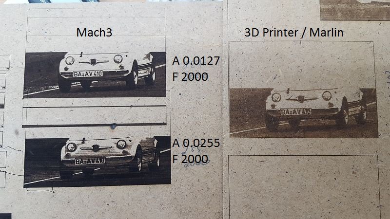

today I do some tests with PicLaser.
It’s at this moment the best Way to test out my Laser settings and my Step/Dir to PWM generator.
After some Tests I reduce the PWM resulution from 1024 to 256.
Now I drive my A axis from Laser off, 0.000 mm, to Laser full power, 0.0255mm.
After some more tests I found out, my PWM is to fast for the DTR Driver.
I use lower frequenzy and an other PWM mode on the Atmel MCU.
At this point I can engrave pics with PicLaser Demo nearly my 3D Printer with the same Laser Module.
Laser Tests shows my test today.
Mach3-A127-F2000 shows the best result at this time.
Mach3-Marlin shows the different between Mach3 and Marlin.
In Marlin I used only 1/4 Laser Power, at Mach3 I used 1/2 of Laser power.
Tomorrow I ll use 1/4 Laser power at Mach3.
Now, I know my Laser and Mach3 works well, I ll do changes to I2GC.
Regards Toby

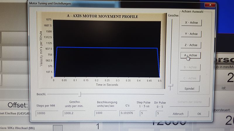

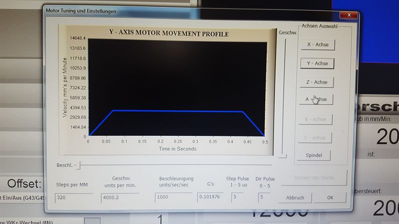

Since 2 month I use the “XHC MK4” USB motion controller.
Before I used a parallel port breakout.
I think, I also get success with parallel port, but thats an other story. :wink:
I also use an Arduino Uno, but I ll make a PCB with Atmel MCU and Optocoupplers.

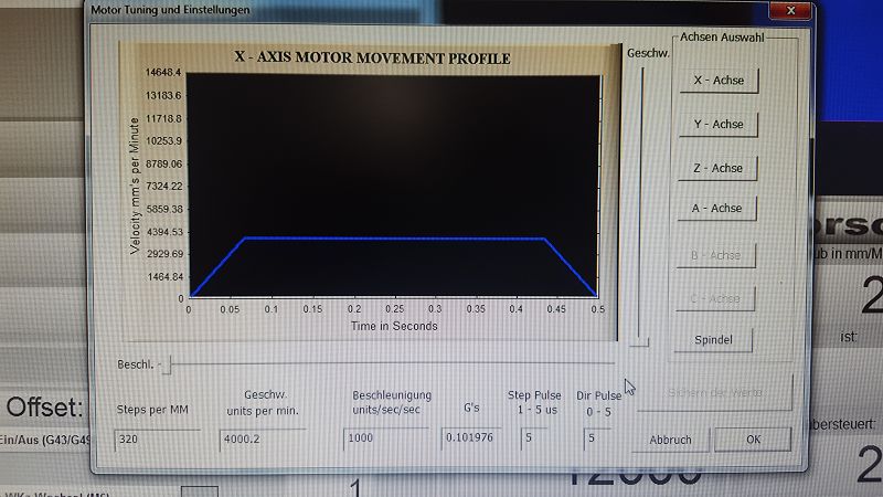

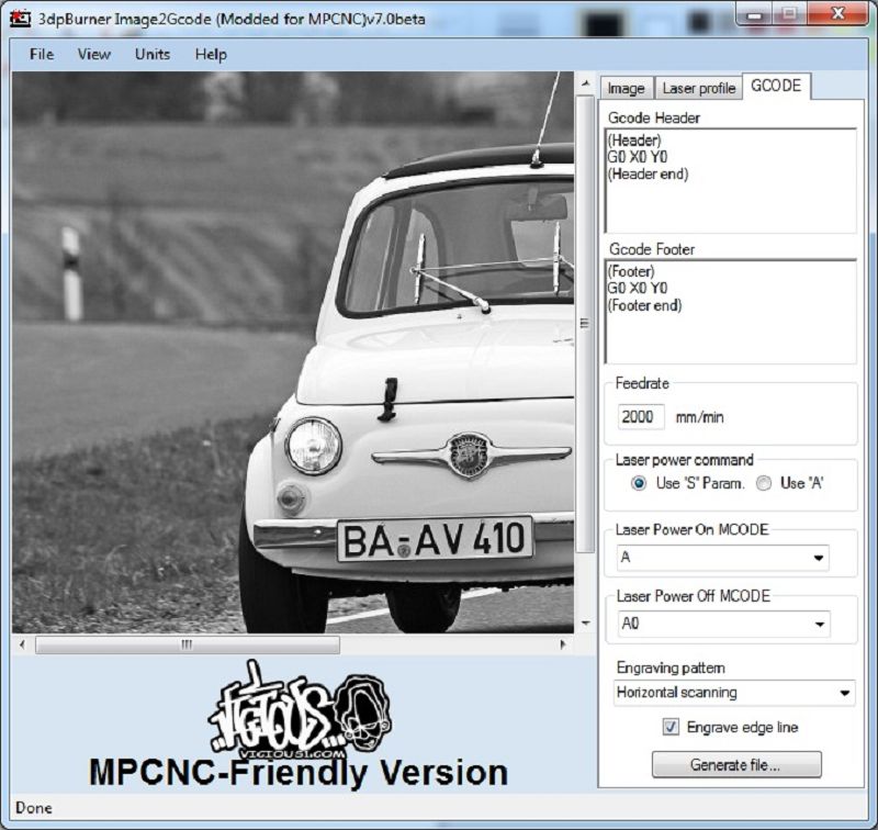

For my Mach3 Acceleration values see pictures.

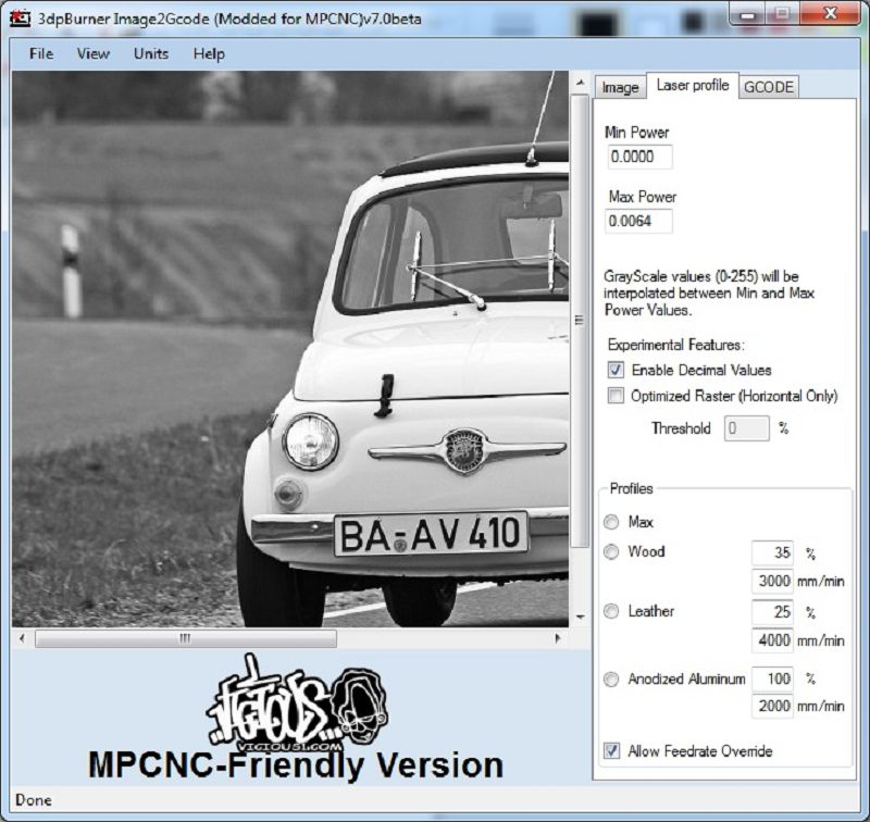

Today I made some changes to I2GC to get it Mach3 friendly.
I add “A” to “Laser Power On MCode” and “A0” “Laser Power Off MCode”.
This was the easyes way at this time. :wink:
Then make changes by the generated GCode, I set the Power values behind the XY Codes.
Deleted many clear lines, add some Header lines.
Now it looks like that:

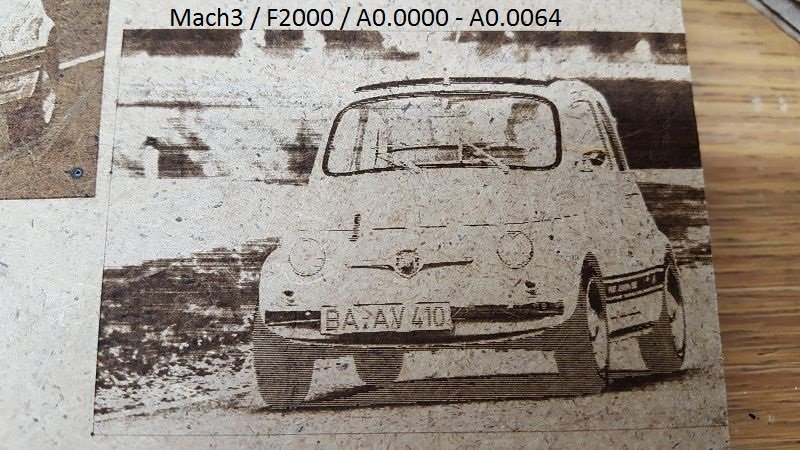

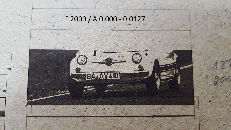

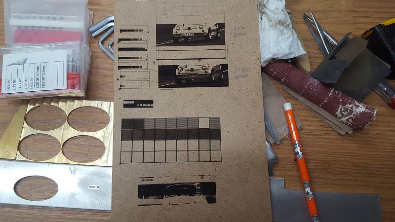

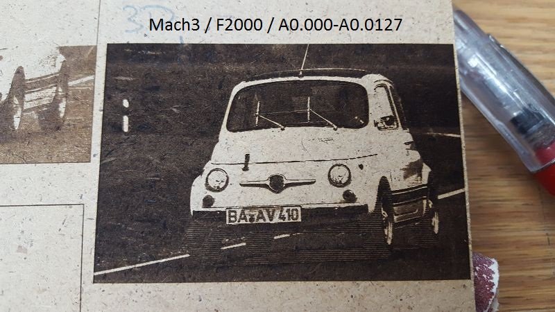

The first try makes some trouble.
X forward it runs well, backwards it run only in 1/2 speed.
I forget to make some Code changes.
The next Try give me a good engraved picture.
I set 1/2 (Max Power A0.0127) Laser Power, but its a little bit too much.
The 3rd try I set 1/4 (Max Power A0.0064)Laser Power, but it’s to brightly.
I ll change the following Code line to the older version I have.
“if (cl.R < 0.15 * 255) { sz = 0; }”
to
sz = 255 - cl.R;
Regards Toby

At least there are my Mach3 X, Y and A setting.
Regards Toby
