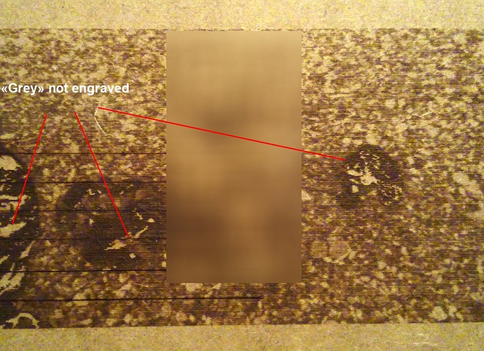

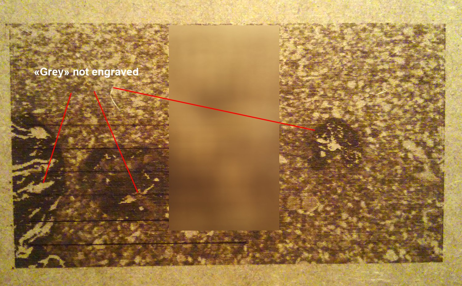

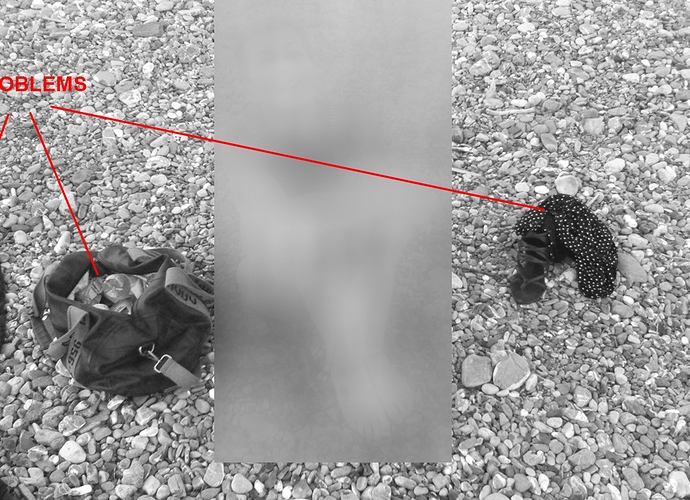

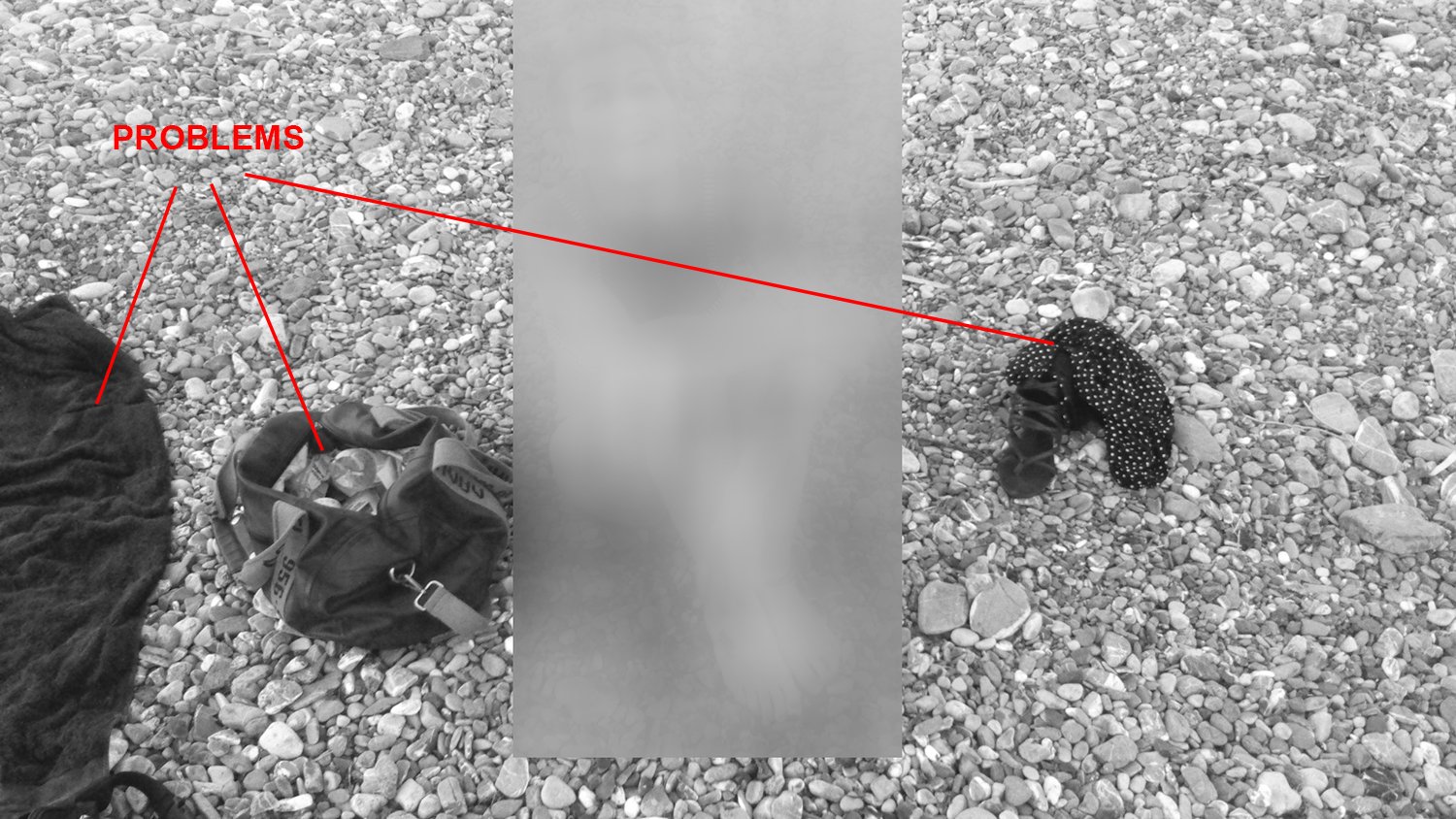

Hi everybody, so for now i have my laser and i engrave pictures :). @leo69 this work well, just need to modify the two comma at the beginning, but i don’t know why, in some “dark” part of my picture, the gcode generated put M106 S0, so it is… not engraved. maybe I missed something ??
@Didier post pic and describe settings used. I’d try etching without doing any adjustments like brightness, contrast, or gamma , and also without any experimental features. I seem to remember another post about that issue where this was the solution.
I’ve been meaning to fix that comma bug but haven’t had time.I’ll get to it though:)
@Leo69 Eheh thanks for the comma :slight_smile: So i tried with profile “wood”, on wood, at various speeds (1000mm/min is the maximum for me, 600mm/min is acceptable) without adjustment, so i join you pictures but with a blur because this is my girlfriend on the beach so :slight_smile: For the engraving picture forget about horizontal lines that was an other thing.

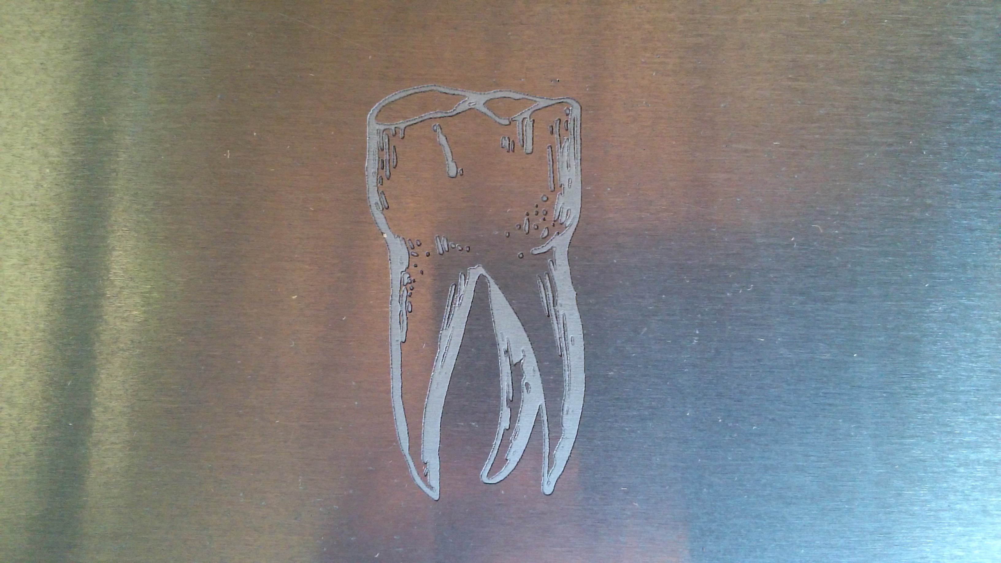

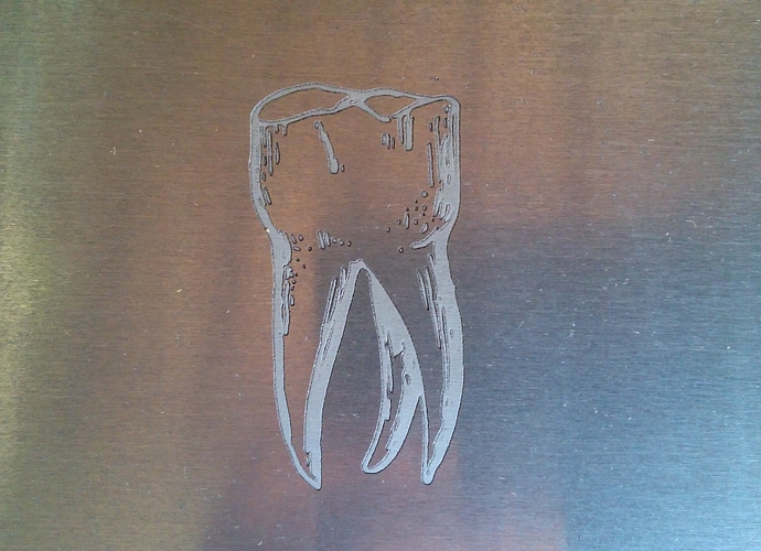

@Leo69 Hi Leo, thanks for taking time to modify your software. I was happy with the first version, i checked this one and the gcode seems to be ok. And thanks for the G1 :slight_smile: Decimal also are good now. For the moment i’m working on classic glass engraving, but look at the picture, i used Image2gcode to engrave aluminium (not anodised, engraving the picture in paint on my aluminium and after classic engraving with “Edimburg” method). I’ll try later engraving with the patched version and now i can play with the added features. Thanks again for your work, have a nice day !!
And the quality on the picture is not really good, sorry for that, but the engraving is really accurate. The size of the “tooth” is 65mm x35mm
