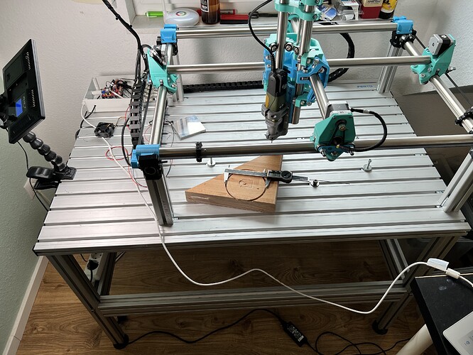

I good my hands on a very nice aluminum profile table base from Item and Festo parts. So I rebuild my little MPCNC after I haven’t touched it for a year after we moved house.
I think it’s a little beauty and sooo sturdy. I had to design new leg holders for it to fit the 40x40mm profile with a M8 screw in the middle.
Today I wanted to cut with it for the first time and had some problems.

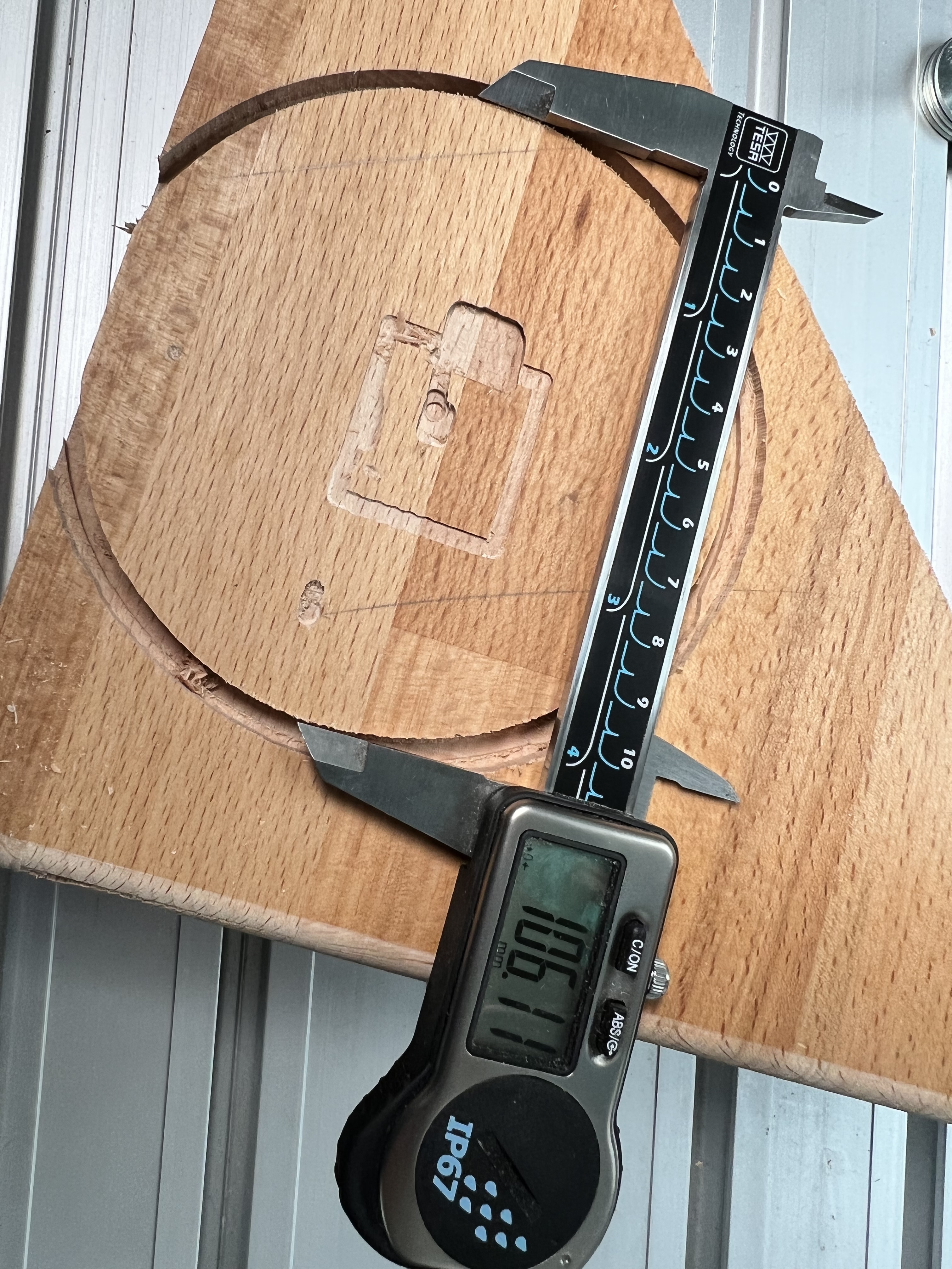

I need a 40mm circle cut in the top of the plastic case. So I drew a 40mm Circle in Adobe Illustrator, Exported it to DFX, opened it in Estlcam and the machine makes a much bigger circle out of it. Why? What’s to change?
Here I tried it in wood:
Bildschirmfoto 2020-01-04 um 20.39.40
Maybe it’s a problem with Illustrator?

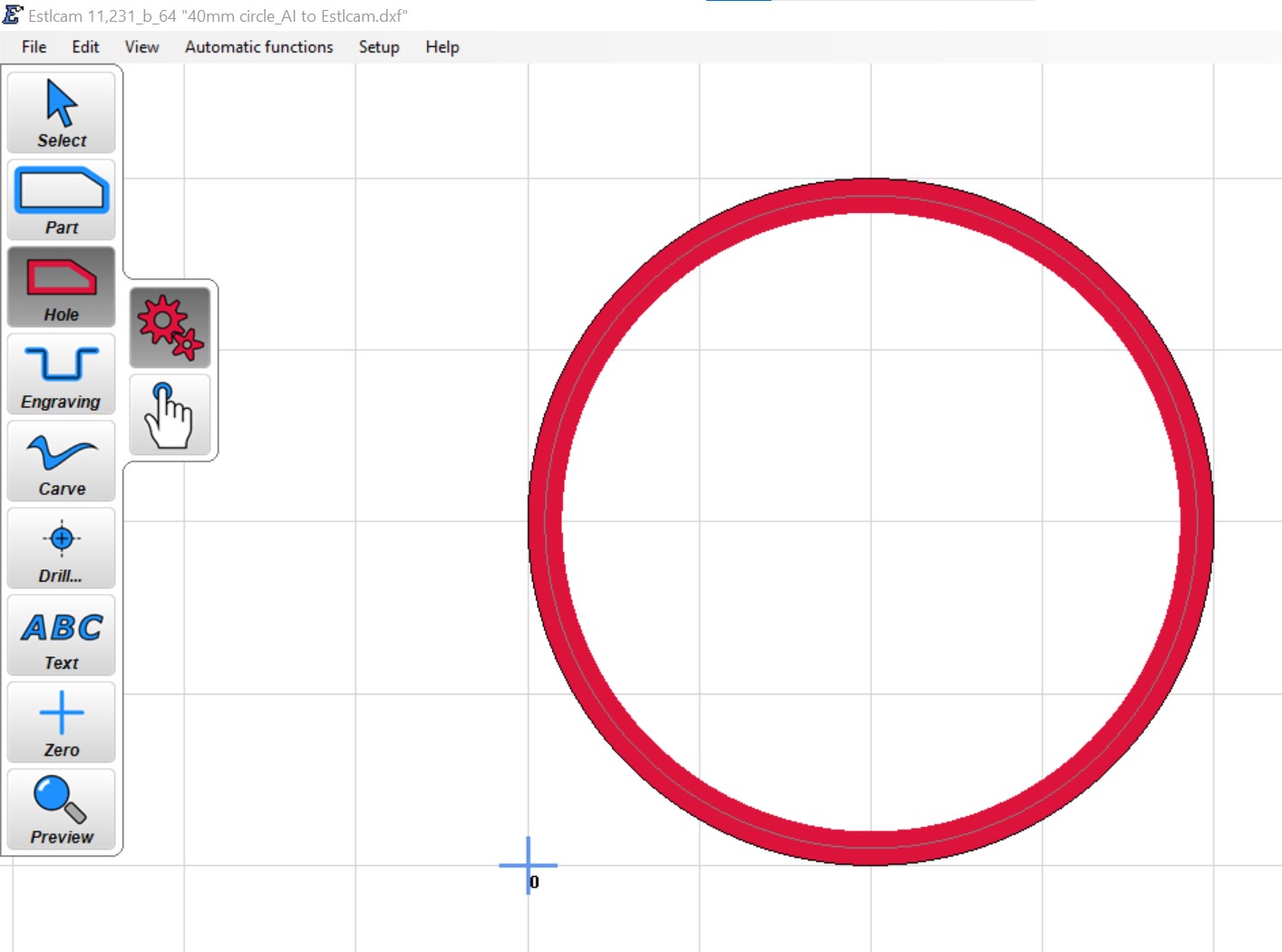

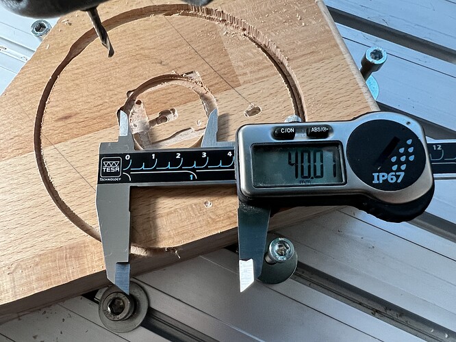

I found a solution for my Illustrator to Estlcam export problem. Looks like it´s important for scaling 1:1 that the resolution of your Illustrator file is 72dpi, even when it´s vector.
My working workflow for export files from Adobe Illustrator 2020 to Estlcam 11 in millimeter is (I didn´t tried it in inch but should work, too):
New Document → Units = mm, 72dpi, then draw what you want and with text Choose Type > Create Outlines to convert the text to paths → Export to DXF for AutoCAD 2018;
in Estlcam: open file and choose mm for units
Perfect 40mm circle on a 10x10mm grid
