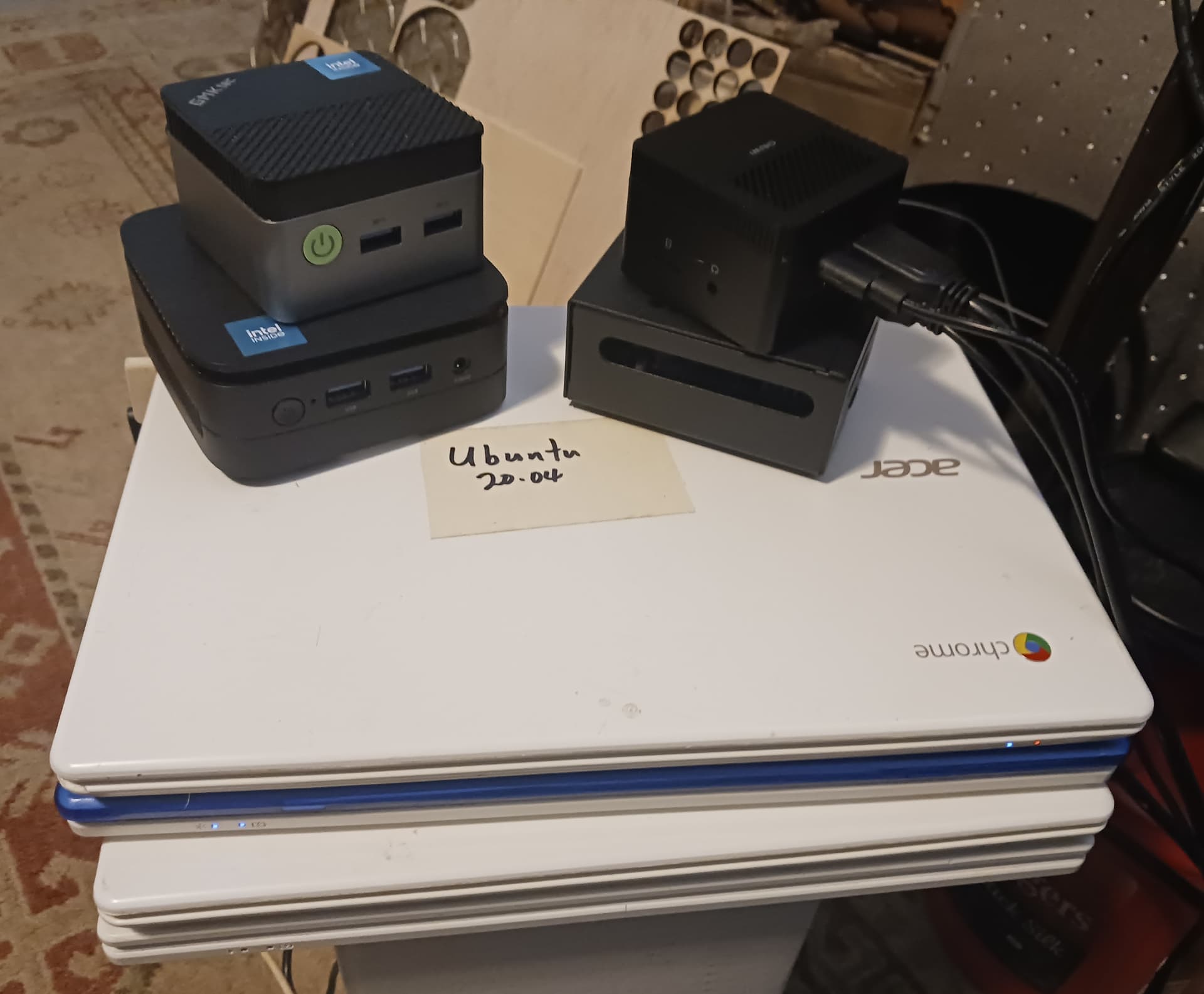

I bought all my grandkids Chromebooks when they first started using them in school. Seven for them and one for me at the time IIRC… and I only asked that they return them if/when they ever no longer needed them. I’ve now got four (photo above) and they all run some flavor of Linux… either Ubuntu or LMDE, headlessly (lid closed). The two minipc’s (GMKtec and Kamrui) with the blue Intel sticker are running LMDE and Debian13… also headlessly. That is a RPi 5 in the case with the long slot for size comparison… it runs, headlessly, but is “laggy” when running anything other than Jeff’s V1Pi/CNC.js image.
The smallest of the lot is a LarkBox Pro minipc that I received yesterday and I’m about to return if I cannot get it to boot from USB… it is being extraordinarily stubborn and is useless to me as is. Sadly, I actually broke down and booted it up in the installed OS just to make sure that the hardware actually works… what a POS with all the ads and restrictions! IMO, of course…

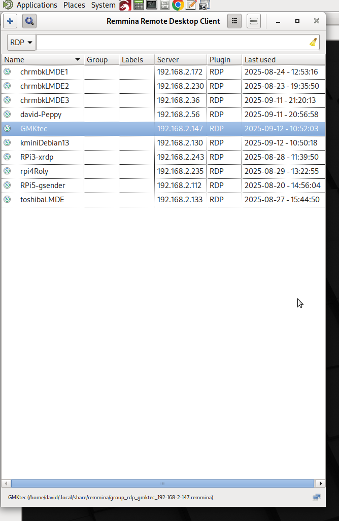

My main laptop is an Acer Aspire 3 running Debian13 “trixie”… I’m using it now to type this and access and control all of the headless machines through Xrdp.

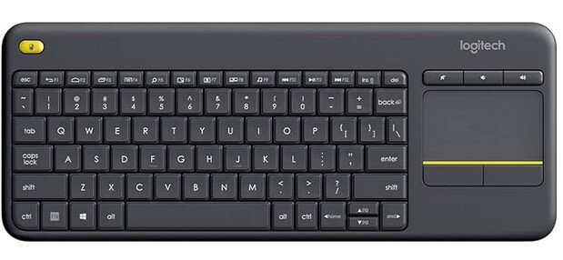

I use one of these because I end up doing all sorts of random searches. But I think I need to try this little guy that I never use much on the LR4.

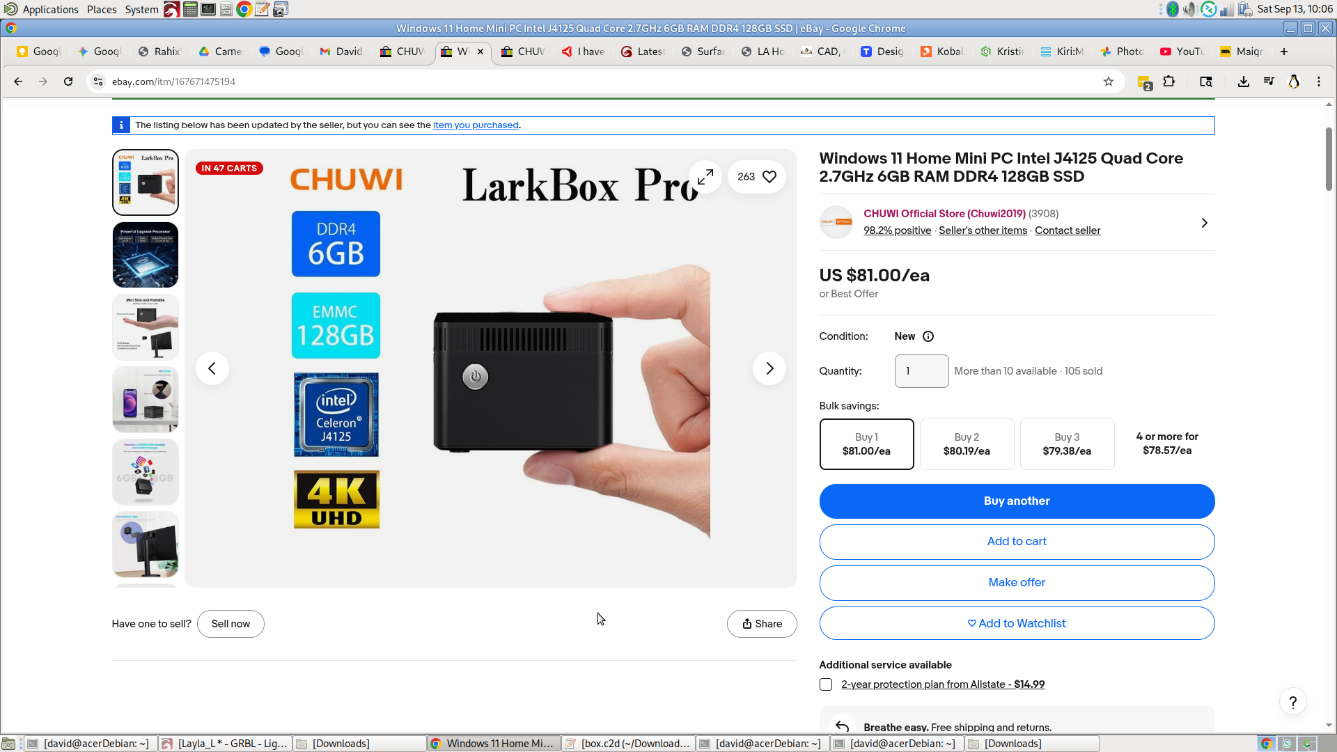

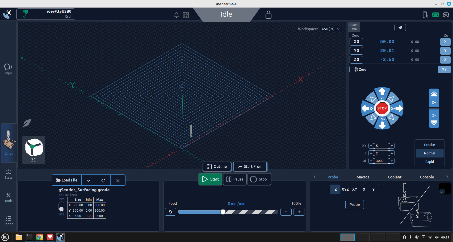

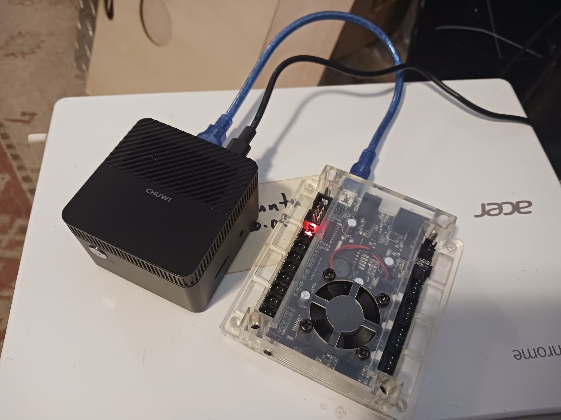

I’ve been able to boot the LarkBox Pro mini PC from USB and successfully installed LMDE 6. With all the abortive attempts to boot from USB, I apparently corrupted the Linux install media that I had used many times previously. I created a new bootable USB stick and it was immediately detected with my last tried BIOS settings.This incredibly small machine runs the full LMDE desktop and gSender (or UGS, CNC.js, etc.) quite nicely; i.e. far better and more responsive than the originally installed OS… or RPi5! And it had no problem detecting the GRBL controller seen in the photo below…
At $81 USD and free shipping, this very compact little computer is about the same $$$ as a barebones 8G RPi5… and far less than one with accessories. The only issue beyond setting the BIOS to boot from USB is that being so small and with so few ports (2 USB, 1 HDMI, and SD slot) you may need to use a USB hub to attach a keyboard, mouse, and bootable USB stick all at the same time to get it initially set up.
To their credit, Chuwi (the manufacturer) did respond within 24 hours when, in my initial frustration, I contacted them and said that I was having trouble getting the BIOS set properly to boot from USB… not realizing at the time that my bootable media had also been corrupted. Their initial response was to ask for the serial number on my purchase… and there’s no telling how helpful they might have been had we had to correspond further about my “issues”. But they did reach out to me… so that’s “something”.
