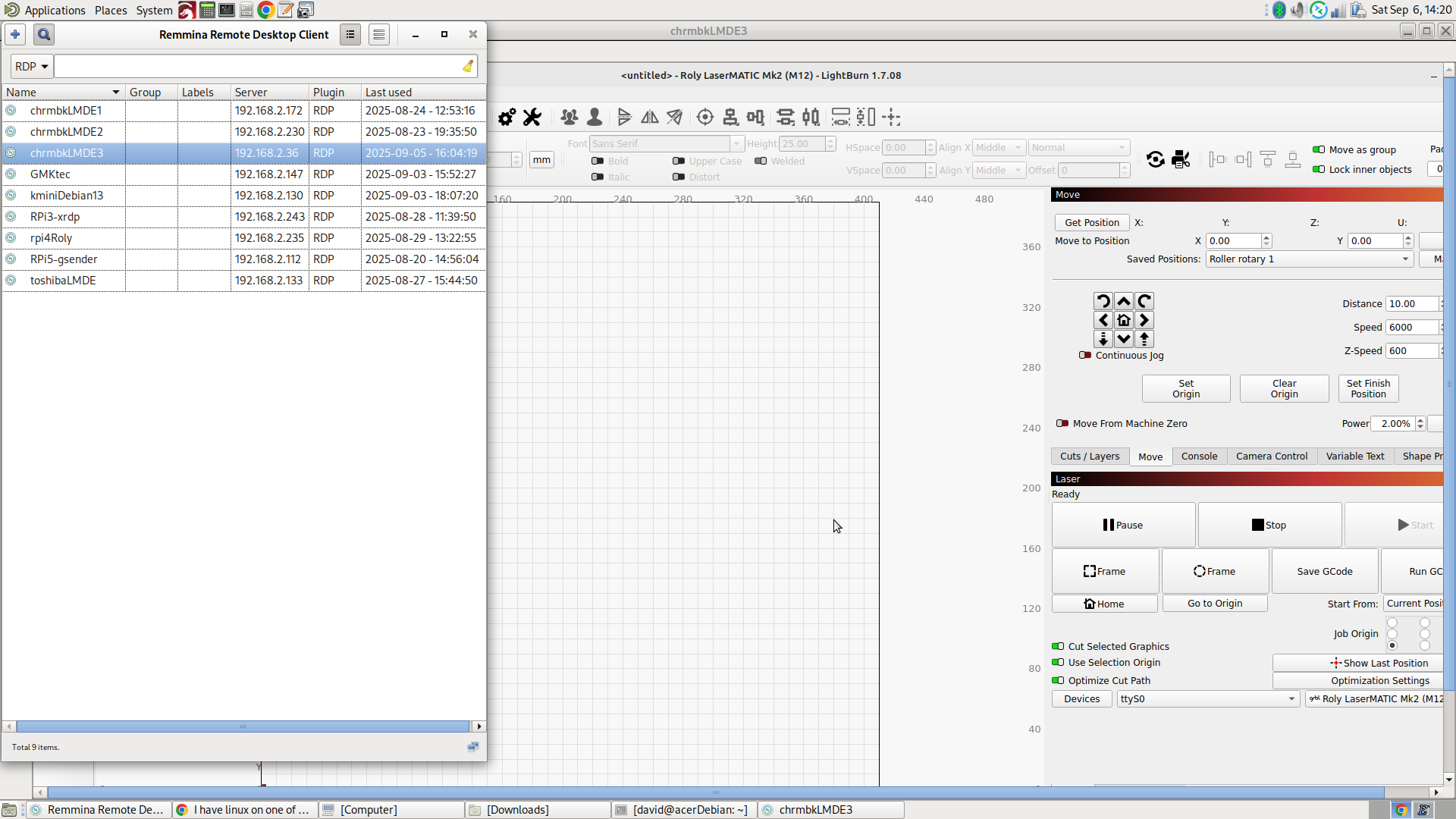

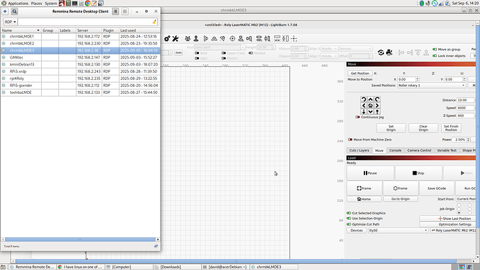

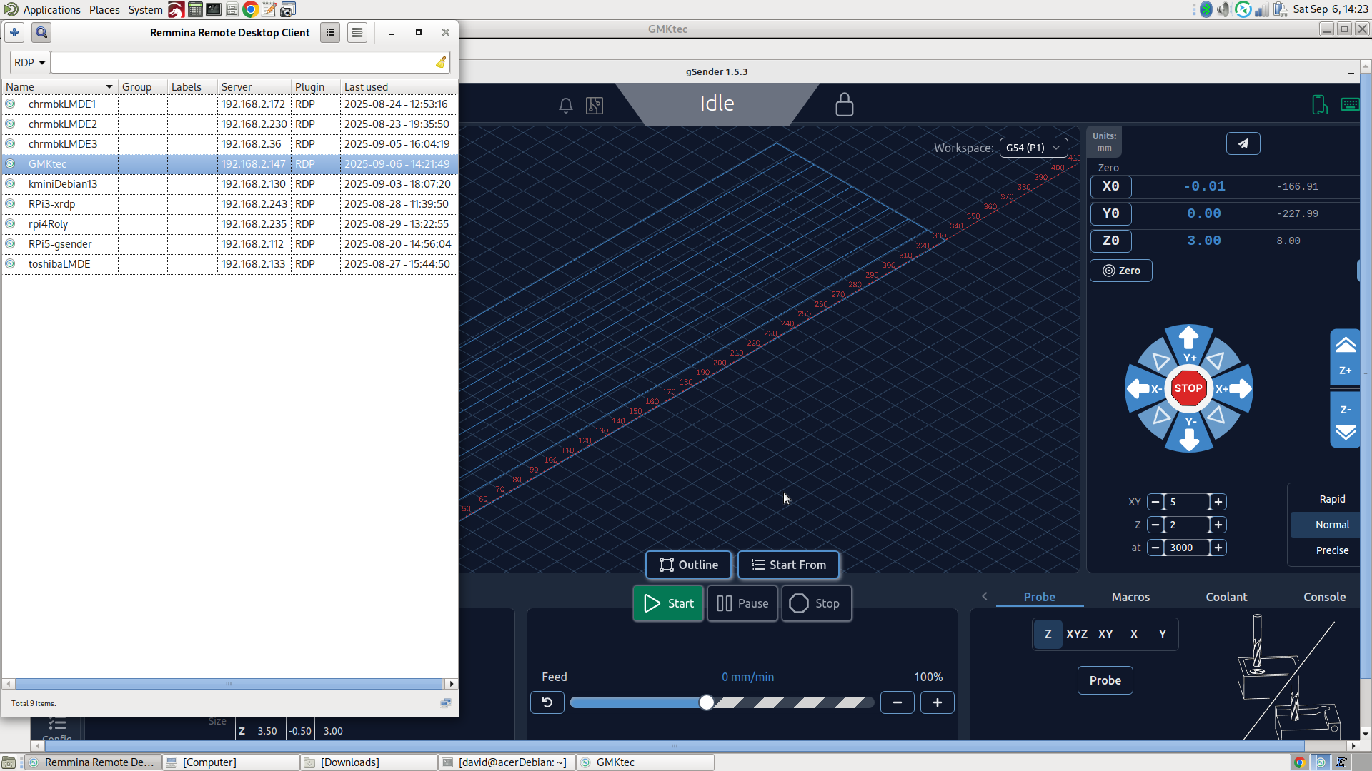

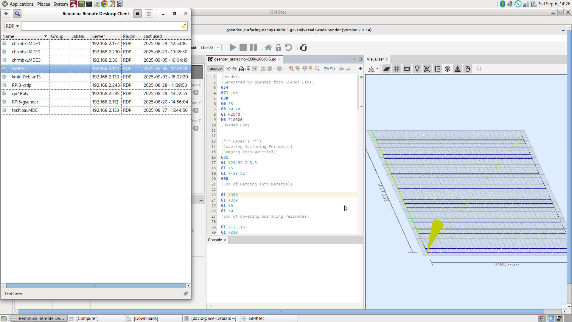

I’ve recently loaded a bunch of miniPC’s and obsolete Chromebooks with LMDE (Linux Mint - Debian Edition) and set them up to be “headless” replacements for the machine-local Rpi4/5 CNC/“gcode sender” units I prefer to use instead of carrying my good laptop into the dusty CNC environment. These miniPC’s and ex-Chromebooks are much more powerful than the RPi4/5 and capable of running CNC.js/GSender/UGS/etc. quite nicely. I’m using Xrdp to remotely access each of the “headless” units… all of which are easily organized and accessed through Remmina Remote Desktop client running on my main laptop.
Lightburn on old Chromebook now running LMDE… interfaces Roly laser engraver…
UGS running on miniPC… interfaces MPR&P…
GSender running on same miniPC…

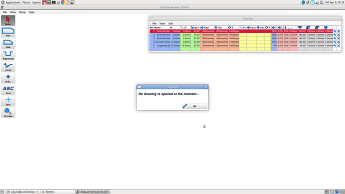

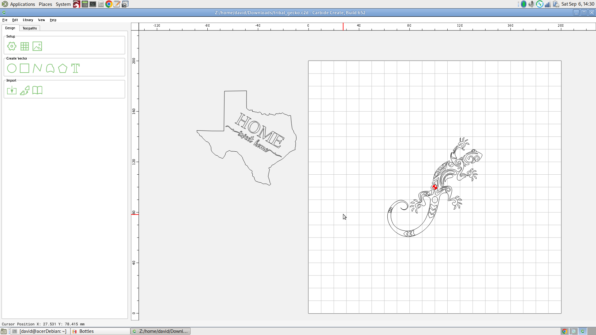

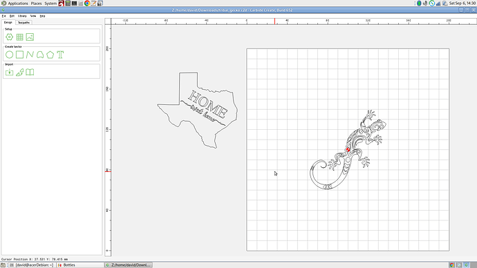

On my main Debian13 laptop I’m also running Carbide Create 6 and Estlcam 10 through Bottles… many other Windows apps supposedly run as well.
All of these machines/applications are running simultaneously and kept in the four individual workspaces I’ve got set up on my Debian laptop… all readily and quickly accessible. I’ve not had to leave my recliner to compose this post and access any of these machine/applications.
TBH I’m not – and will not – be running multiple laser and CNC jobs simultaneously… I’m only accessing the “headless” units that interface the machines.
