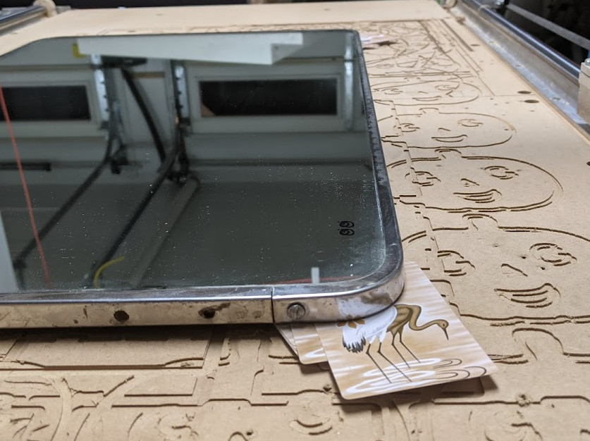

My steps were as follows.
  1. I used a magnetic base dial indicator, took it apart and played with the different clamps until I got a combination that would allow one end to clamp onto a 1/4 endmill and the other would hold the gauge.
  2. I used an old vanity mirror because I needed something completely flat and smooth. I put this on the spoilboard and probed one corner with the dial indicator. After setting Z to zero and the dial indicator to Zero I probed a square and shimmed the mirror with playing cards until all corners were reading Z on the dial indicator. Note: Don’t drag the dial indicator as it will spin the chuck and then your runout/angle of spindle will come into play.
  3. I then set the router to the middle of the mirror and spun the gauge and boy was mine out of wack. I was reading a 0.050" deviation from one side of the 7" swing diameter to the other. I loosened the four screws that hold my router to the 611 plate and noticed one side was not able to clamp all the way down. After some messing around I fixed the gap. I still had some deviation when swinging the gauge so I loosened them up again and then used aluminum foil (the stuff you bbq with) and folded little strips together to make shims. I over compensated where needed as there would be slight compression when tightening the bolts again. After a bit of messing around I now have a deviation of 0.001" on a 7" swing diameter. This is well within the margin of error of this process. Also a light touch on the top of the router can swing the gauge quite dramatically.

Well that really improved my cut quality and noise! Just knocked out this cabinet door with a 1/4 endmill and there are no ridges! Also much quieter
I surfaces the spoilboard with a 19mm cutter I had around. 2mm deep at 40mm/sec. Didn’t even complain.
