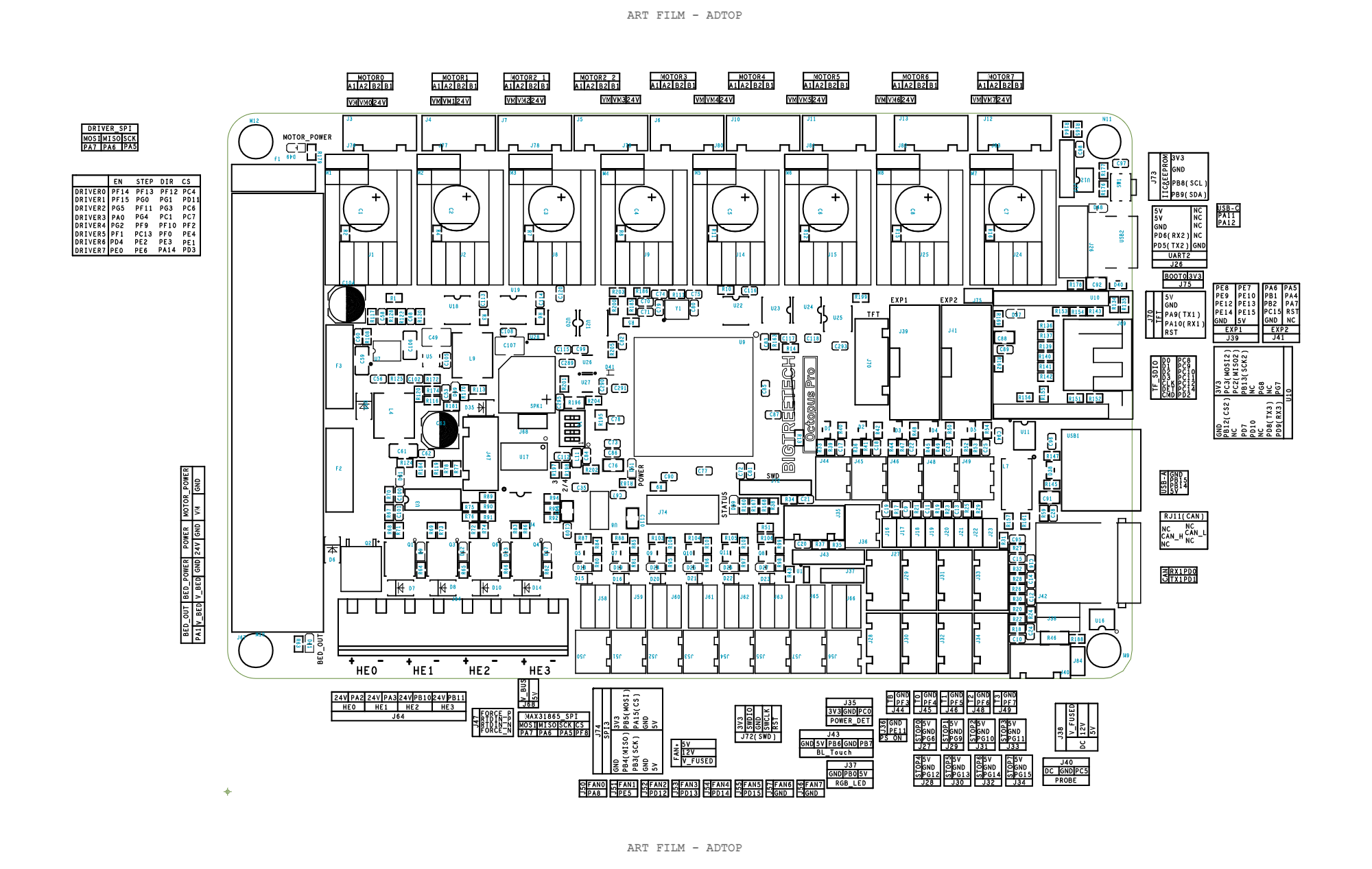

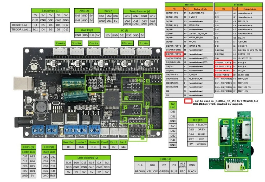

  • Pinout diagram(s) for your board(s) with the pin labels for configuring your printer.cfg file. This is the tedious part requiring patience and some time, but it isn’t terribly difficult.

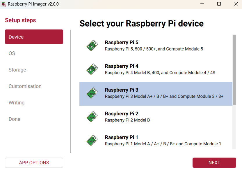

ok. first is setting up the raspberry pi or the linux control PC.

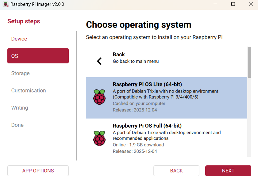

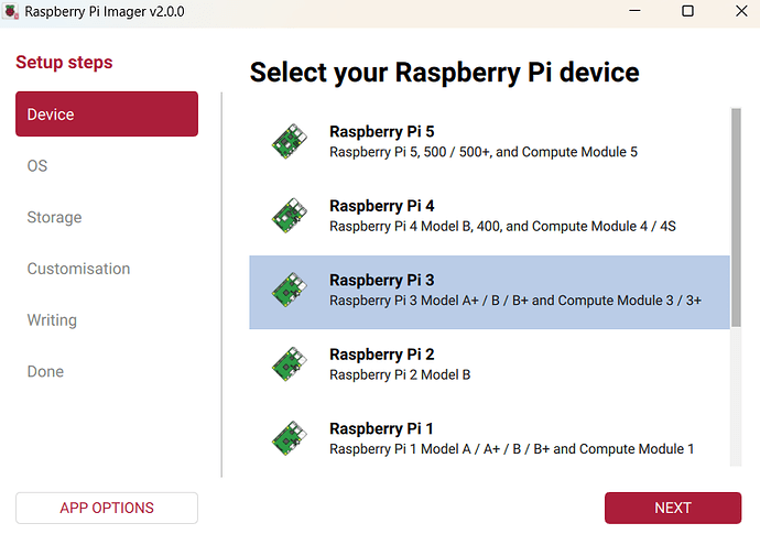

  1. pull your distro and load it on the sd card.
    For the pi3, I used raspberry pi imager:
    and continue through the setup. Be sure to enable SSH as well as enter your wifi connection information and user name and password, then write it to your sd card. I have a USB to SD card adapter, but my laptop also has an SD card slot that works.
once it is written, you can either hook it up to a tv to continue setting it up or connect to it via a ssh client app such as putty or smartty. I used to use putty for everything, but I like smartty a little better because it has a text editor option and allows scp file transfer with its menu plus you can spawn a new terminal or add a second ssh client connection quickly with a side or lower menu bar option.

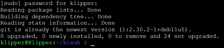

verify you have git installed
sudo apt install git
if it is already installed, it will say something like this. If not it will ask you if you want to install it. press Y

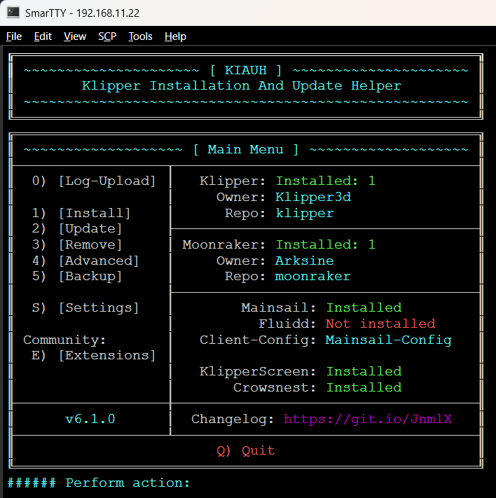

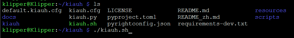

with a git command, clone the kiauh github repository:
git clone GitHub - dw-0/kiauh: Klipper Installation And Update Helper
then move into that folder and run the .sh file

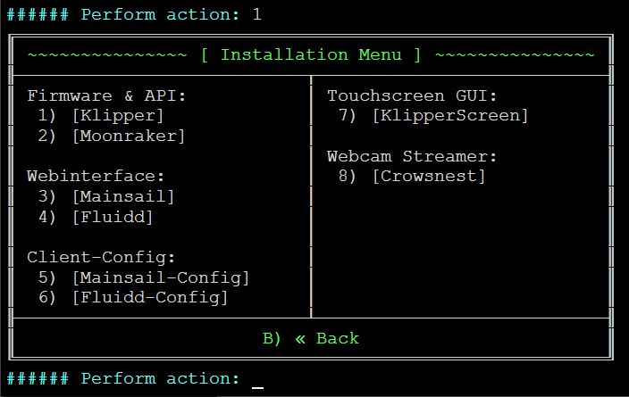

and it will open the kiauh installation menu system:
step through the menu by selecting 1
then install 1, 2, 3 and optionally 7 and 8.
Only install 7 if you have a touch screen connected to the raspberry pi. I don’t for my cnc, but you certainly can if you want.
Install 8 if you want to add a camera for remote viewing or timelapse video with the understanding that you should be in the videos it takes, not watching them while it makes them. If you have concerns about that, search fire on this forum.

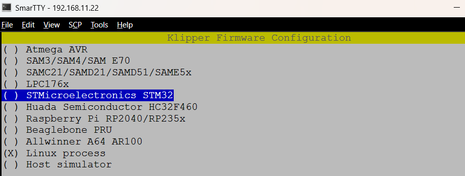

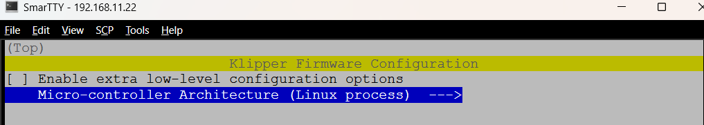

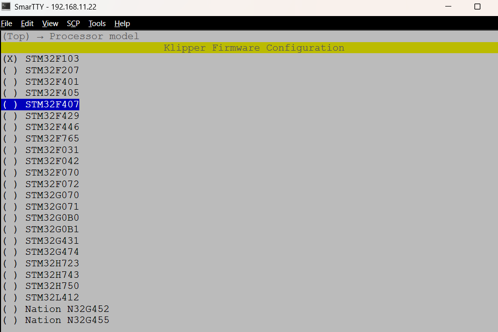

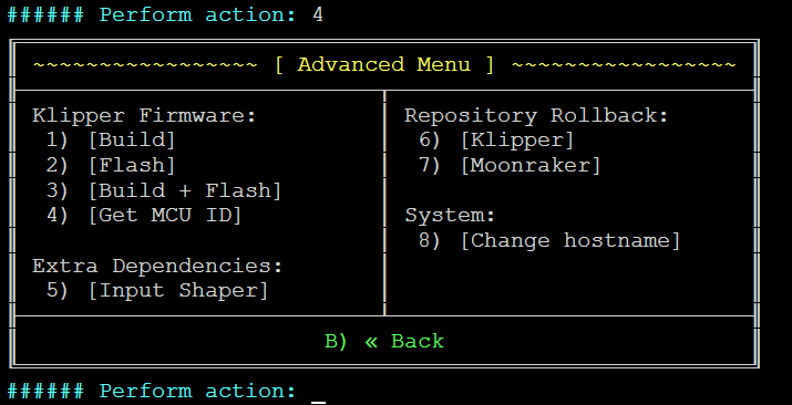

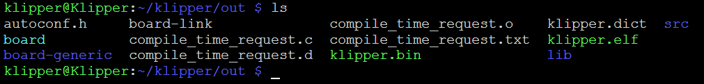

the last thing you need to do in kiauh is make your board firmware. it is an advanced option selected with #4.
if you have a BTT board that flashes with an SD card, you will want to just build. if you have another board like a mega or one that flashes over usb, you can build and flash.
just arrow up/down and press space bar to select…

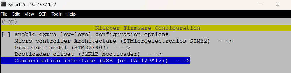

select microcontroller architecture
If using a BTT SKR pro 1.2 then select STM32
with a magnifying glass, verify the processor label matches the option (should end in 407):
bootloader is 32 and communication interface is usb
you can set the crystal speed to 16 MHz

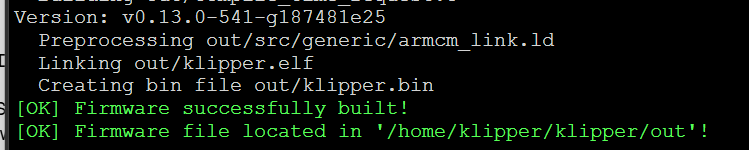

then press q to back out and it will compile after giving you the option of saving the configuration. Yes and give it a name, or no and it will then start the compile.
in that compile step, if you don’t see the klipper.bin file name before it says SUCCESSFULLY BUILT! then you need to update klipper and recompile.
The file can be found here…
using smartty, you can scp transfer it back to your host machine, rename it to FIRMWARE.BIN and flash your controller board with it.

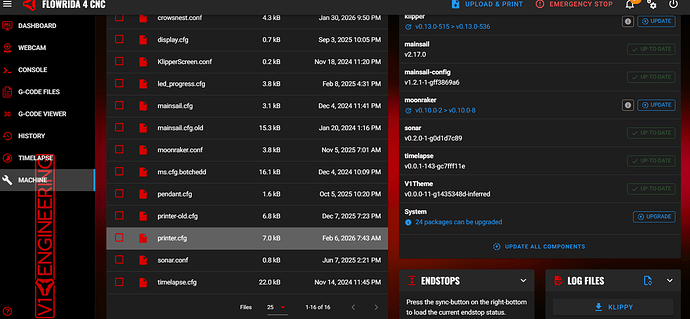

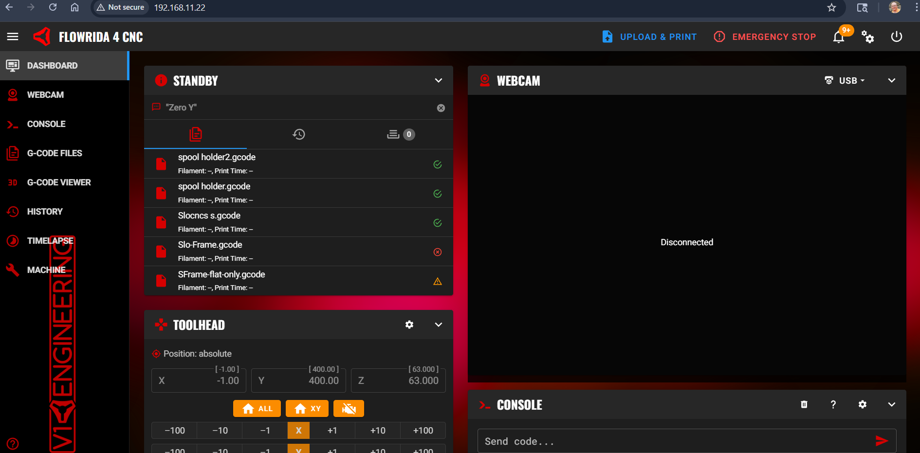

    once you have klipper, moonraker, and mainsail installed, you can finish configuring your system via the web page. since you ssh’d into the system you know the system ip address or if you are at the terminal, you can
ifconfig
to get the ip address. Simply enter http:// in front of the ip address in your web browser to open the device web page.

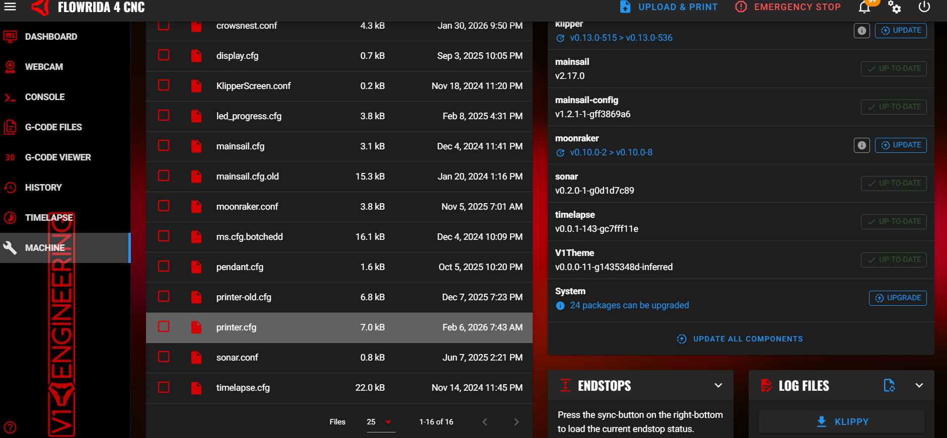

This is my cnc web page. The camera stopped working for some reason, but the device still works.

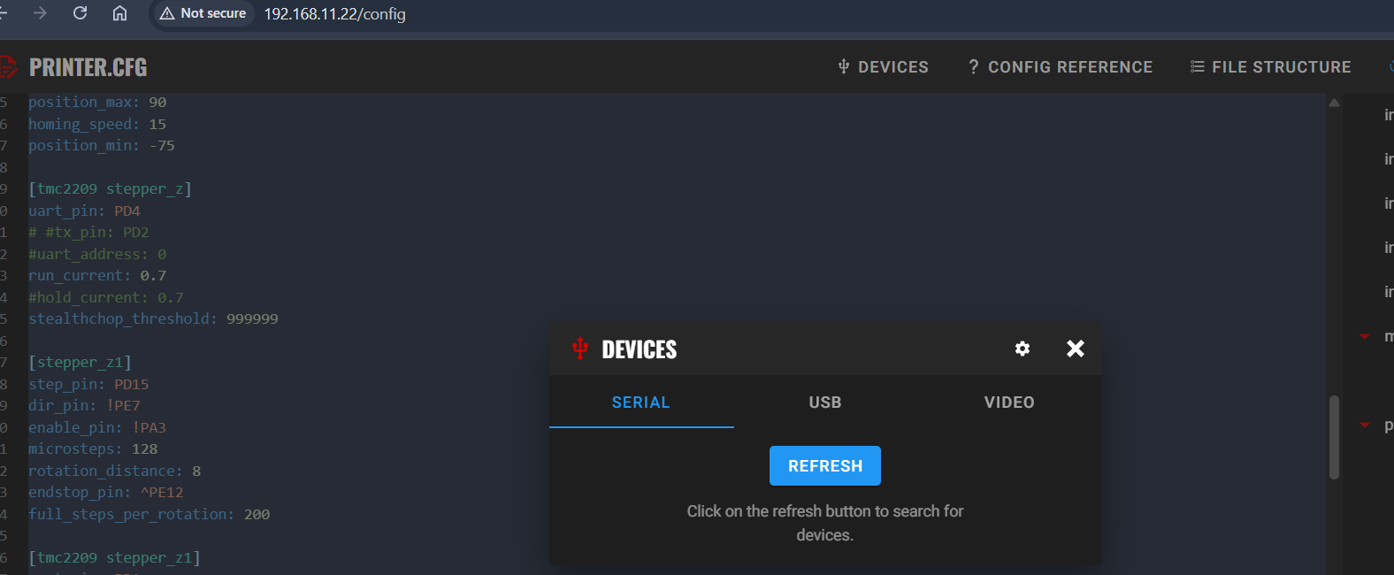

click on machine on the left menu:

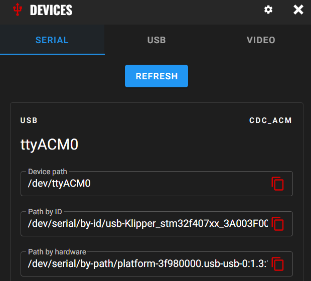

then click on the printer.cfg file. If you device says ERROR, this is ok. It is because your printer.cfg isn’t correct and you don’t even have the USB to your controller plugged in yet. with nothing plugged into the control board, plug it in to the USB with the USB jumpered so it will power on and press the device button at the top of the page:
then hit refresh
your device should show up. press the copy button to the right of the “by ID” line and paste it into your cfg text in the [MCU] section similar to below but without the ******
[include mainsail.cfg]

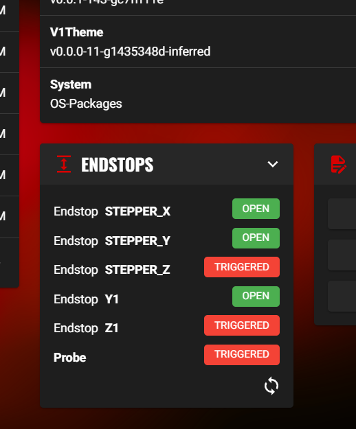

Those are the basic settings. You will need to verify your pins with the pinout board for enstop assignments. You can test the endstops on the web page in the machine section by pressing the refresh arrows
hold them or change them and press refresh to verify they work.
If it reads triggered and it is open, change the pin name to have a ! in front of it or remove the !
If it is the wiring is swapped, you can either change the wires or change the pin assignments and save and restart.

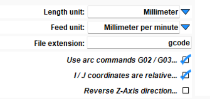

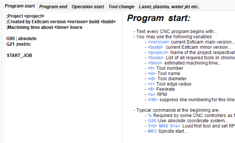

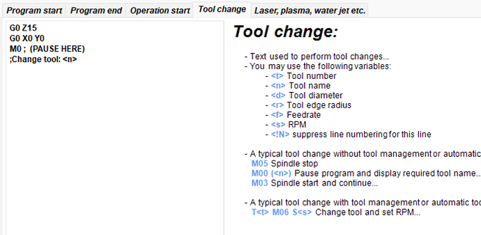

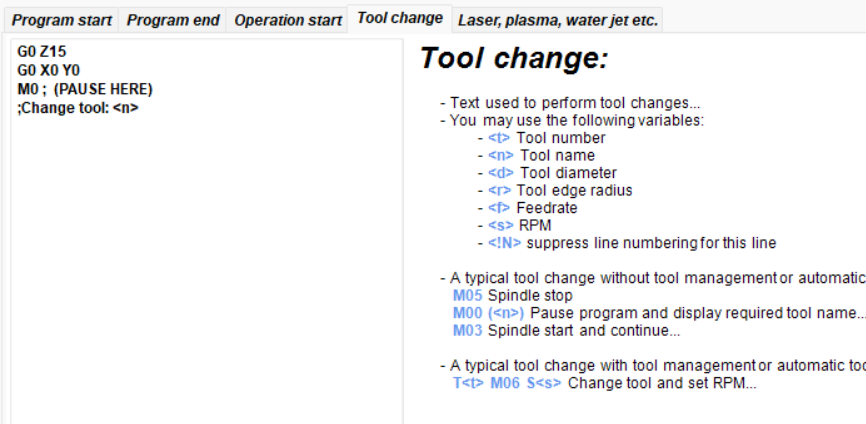

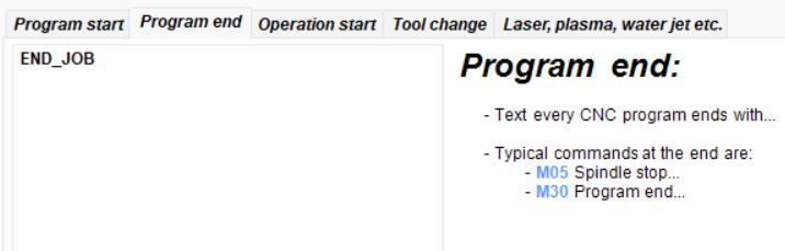

  1. Estlcam postprocessor
    Klipper gcode is most closely related to Marlin. I here are my settings for Estlcam 11:

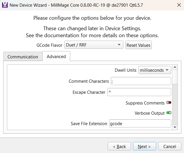

  2. Millmage setup:
    save gcode file and transfer via web gcode file. I just looked and it may have option to control, but I have not tested that yet via millmage RC14. Uploading files for me has worked ok. I’ve milled aluminum with it and it survived.

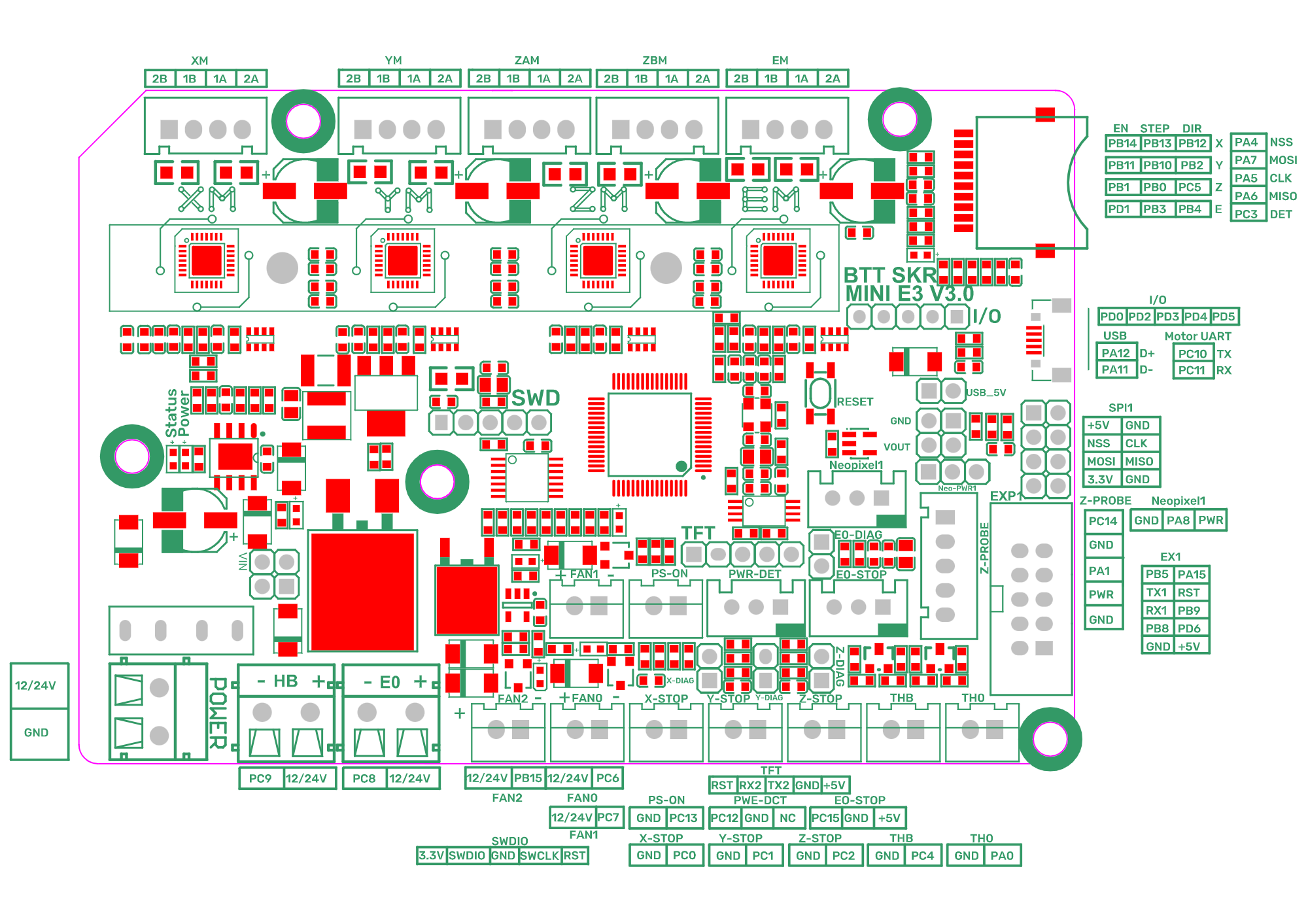

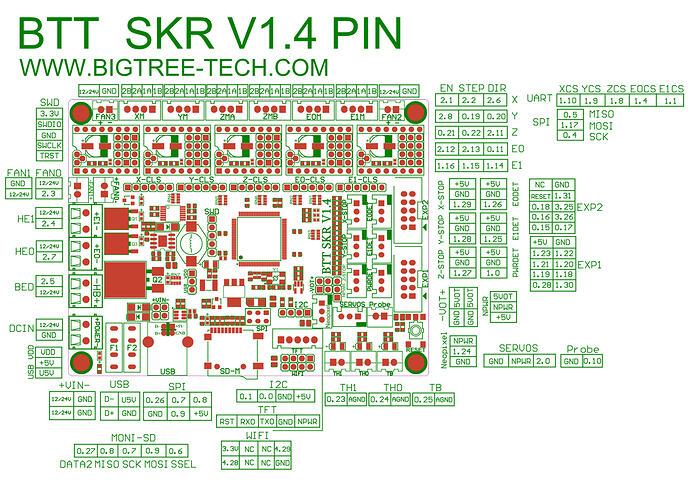

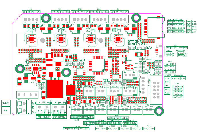

I have a pile of various old Marlin boards that I’ve been meaning to play with for my repeat as well as on a V1 or V1-esque machine or two.

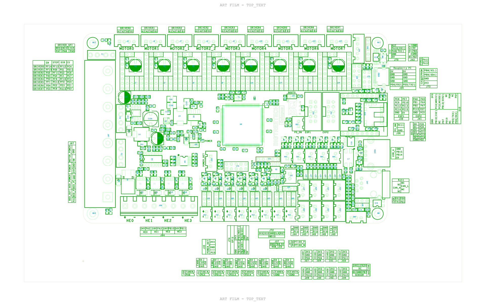

As a followup, I use google image search when I look for board pinouts labels, but they most often steer me to the reprap firmware site. I’ve done klipper setup on:
octopus
octopus pro
skr pro
skr 1.4
skr 1.4 turbo
mini E3V3
creality 1.4.2 and 4.2.7
  • for the number of boards there are around, I’m surprised it is hard to find, however if you use a default klipper profile for an ender 3, it should have everything mapped in there and you can just rearrange pins

trigorilla - a 5 channel board. if you use with tmc2209 chips from BTT say from an SKR board, you have to solder a wire for uart communication.
I have a stack of printed sheets I use when setting up the board pinout. As I wire the board, the printer.cfg file takes shape. If the motor direction is backwards, add or remove the ! before the direction pin label in the .cfg file and simply save and restart.
If you don’t have enough channels, you can plug in a second board and use that, but you have to give it a name and refer to all pins with that name. for example: if your main MCU was for the y axis and the z_mini is for X and z, you might assign the Y and X axis like this:
[mcu]
# for trigorilla board
serial: /dev/serial/by-id/usb-Silicon_Labs_CP2102_USB_to_UART_Bridge_Controller_serial number
[mcu z_mini]
# for BTT minie3v3
serial: /dev/serial/by-id/usb-Klipper_stm32g0b1xx_serial number...
[mcu rpi]
# for GPIO on the raspberry pi
serial: /tmp/klipper_host_mcu
# X Stepper Settings
#X axis on core is on miniE3V3 as E0
[stepper_x]
homing_positive_dir: False
step_pin: z_mini:PB3  #for mini e3v3 on channel E0
dir_pin: z_mini:PB4
enable_pin: multi_pin:z_enable # for a z brake that disengages once the x axis activates
microsteps: 128
homing_retract_dist: 10
rotation_distance: 32
full_steps_per_rotation: 200
endstop_pin: ^z_mini:PC15 #D2  ( must be pullup for nc pin)  the ^ makes it a pullup, so it puts voltage on the pin and when the switch activates, it goes high
position_endstop: -5
position_max: 533
position_min: -200
homing_speed: 50.0
[tmc2209 stepper_x]
uart_pin:  z_mini:PC11
#tx_pin: z_mini:PC10
uart_address: 0
run_current: 0.900
# hold_current: 0.90
stealthchop_threshold: 999999
[stepper_y]
step_pin: PF6
dir_pin: !PF7
enable_pin: !PF2
microsteps: 32
endstop_pin: ^PJ1 #D14
position_endstop: -19
position_max: 790
position_min: -300
homing_speed: 70.0
[tmc2209 stepper_y]
uart_pin: PE3
run_current: 0.700
hold_current: 0.70
[stepper_z]
homing_positive_dir: True
homing_retract_dist: 5
step_pin: z_mini: PB13
dir_pin: z_mini:PB12
microsteps: 32
rotation_distance: 8
endstop_pin: ^z_mini:PC0
position_endstop: 63
position_max: 90
homing_speed: 15
position_min: -75
[tmc2209 stepper_z]
tx_pin: z_mini:PC10
uart_address: 0
run_current: 0.7
hold_current: 0.7
#this segment is not complete as Y1 and Z1 channels are missing... for illustration only
Special note: for axes with 2 or more motors, be sure all motors of the same axis are on the same controller. For example Y and Y1 are together. Z and Z1 are together.
