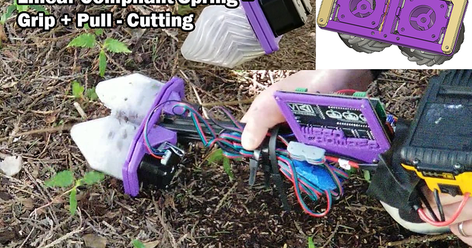

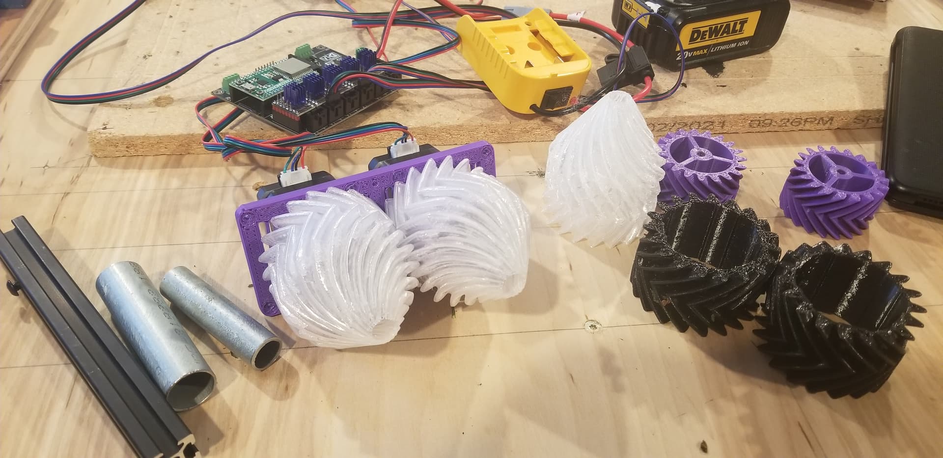

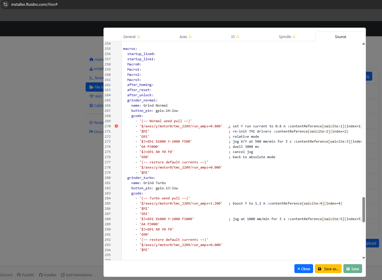

Switched to 2020 for now. Easier to mount things, will try EMT again later. Currently trying to figure out how to wire up and configure critical features like turbo boost button (temporary current and feed-rate spike), think AirWolf rather than KnightRider for ergonomics sake, since still need to hold trigger while engaging Turbo.
Currently using/abusing mostly stock FluidNC. Been trying to avoid… But may end up with custom firmware, I really don’t need gcode for a pet weed euthanizer, but… Who knows, maybe it could help do crop lawn circles.
This is awesome. A bit absurd, but I support this. :laughing:

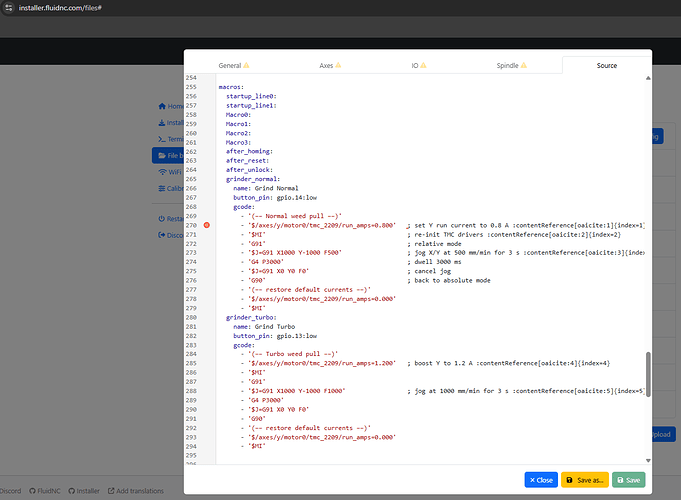

So, you’re running gcode to run this? I’m curious what that looks like. If you just need to change feedrates and even stepper amp settings changing based on input, I bet you can do this all with stock firmware with some creative gcode along with some FluidNC commands.
Thanks Jason. Also, thank you for the misc FluidNC musings and experiment topics you’ve been sharing, including the helpful related FluidNC doc links you shared…

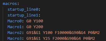

My first lazy AI vibe attempt convincingly suggested I could add arbitrary named Macros inline. Nope. Below doesn’t work, but does convey the gist of what I am trying to do…

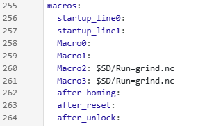

Currently reading Docs, V1E forum and discord. Looks like I should push logic to saved macro, so trying that, e.g.
Yea, I would try tying the macros that call a gcode file to button input with the standard functionality.
I’m not sure what the intention is for the dwell and cancel jog.
FluidNC config ended up being simple, but took me a long time to figure out…

Currently upgrading 60oz to 84oz steppers, full length shaft and other tweaks. Also need to wire up and write Arduino code to qualify for the Smart Pet Gadgets Printables contest, started sharing files/docs, will include details for V1E/Arduino based setups…

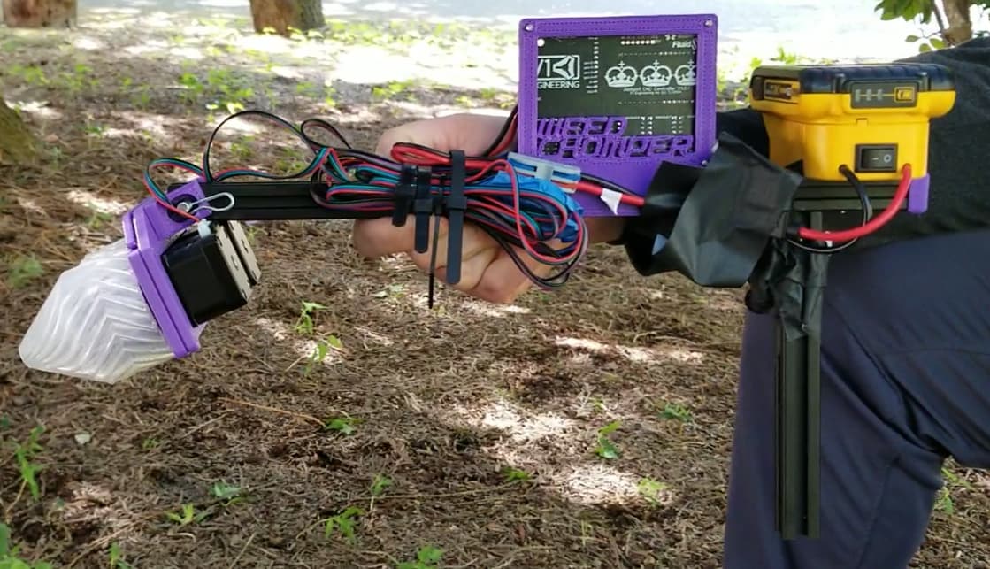

Did you consider a DC motor instead of a stepper? You could wire it to the battery through the button and skip the microcontroller altogether.
I guess it is a moot point now, since you’ve done all the work. But a heavily geared DC motor should have some significant torque.
You could even 3D print the gearbox and integrate it with the devil heads (Weed pullers)
DC motors would have been cheaper and easier to code for sure. Could’ve printed or bought gears that would be good enough, and yet… I intentionally wanted an excuse to play with steppers…

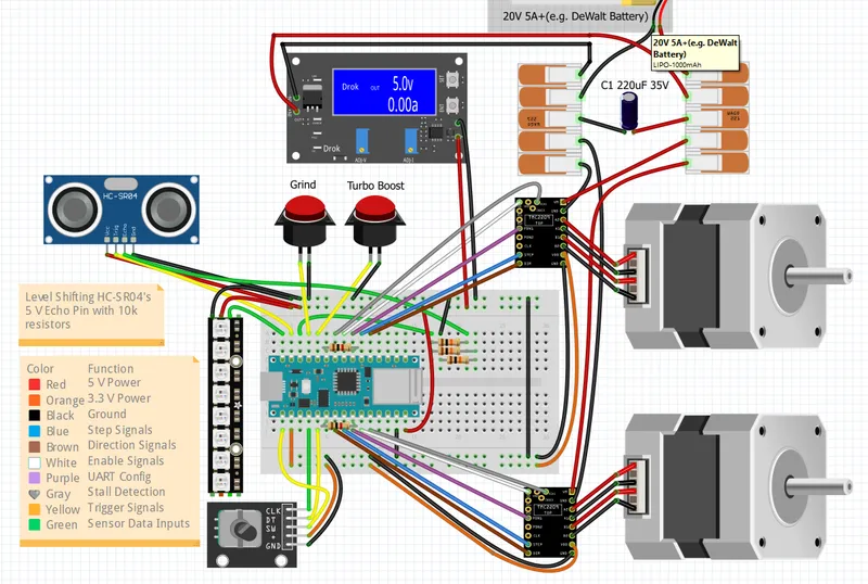

Getting V1E Jackpot running was way easier than trying to make an Arduino version. Am still not done, but this is how things are looking (my first fritzing diagram)… Suggestions/ridicule appreciated, cheers!
:rofl::rofl::rofl:
