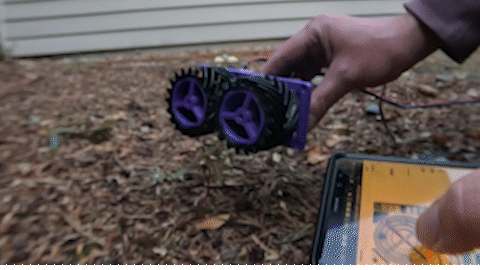

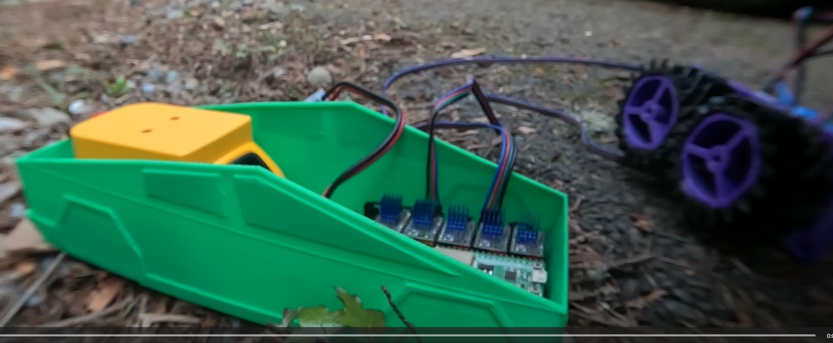

Guessing grub screws in the grinder hub will not hold onto the Stepper shaft’s flat face for long… Suggestions appreciated! Will set low current and feedrate to begin with, am using smaller NEMA 17, not the 84oz ones from V1E.

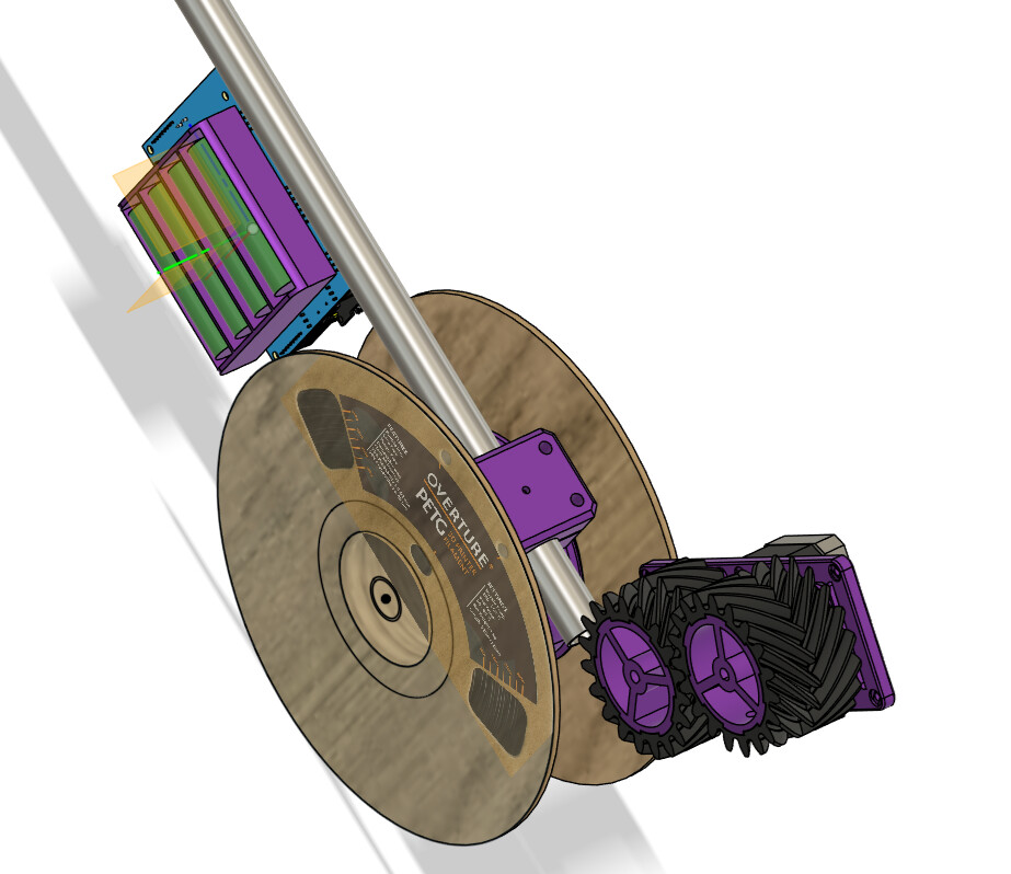

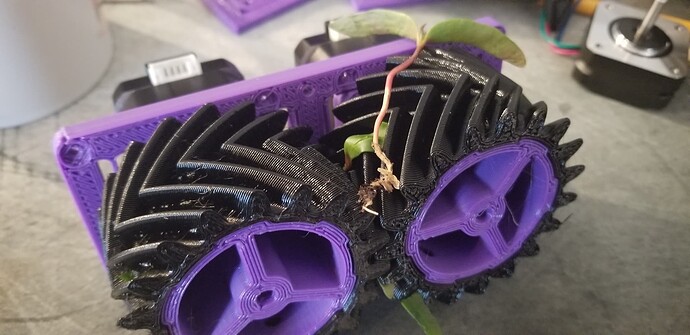

My first clean kill of a weedling via hand cranking. Many tweaks/improvements needed to improve clean kill-to-trim (KtT) ratio. This small win after many hours of messing with CAD makes me feel like it’s worth continuing further… Planning to attach jackpot, some power, and EMT next…

Currently using grub screw to fasten PETG inner grinder hub to stepper shaft, but that seems like the weakest link… Currently thinking something like a teethed Pulley without flanges so a printed hub could slide on.
Suggestions for more effective small weed pulling mechanisms also appreciated!

Before that though, I want to improve Kill-to-Trim (KtT) ratio metrics, the tires and/or mechanism needs improving. Suggestions appreciated! Idea I have for the next iteration is likely going to result in a lawsuit from Gaultier/Madonna.
Here’s what I’m seeing… Nice weed pull at 1:30, but rest of the attempts are mostly pants, SlowMo starts at 45s Mechanical Weeding ASMR, a Mostly 3D Printed Weed Puller, Test #2
Weed whacker string trimmers are way faster than this contraption at trimming. However, trimming weeds takes many cuts over a long time period to exhaust the root to death. So, feel like I need to improve KtT ratio for this to make sense as a manual stick attached tool, and/or, improve KtT ratio enough for an autonomous battery powered bot, ideally an existing design…
