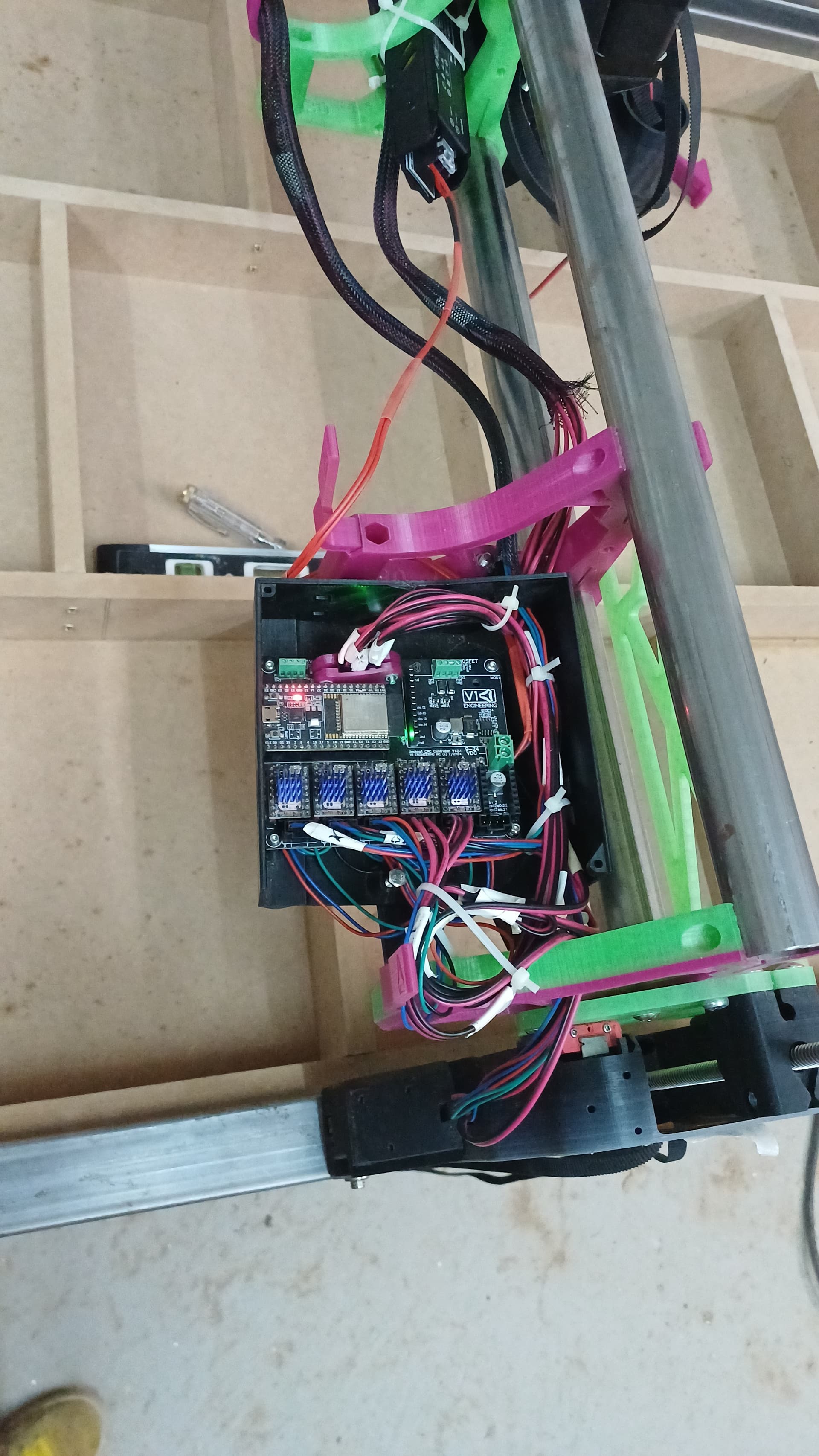

Hi, I’m Alejandra and I’m building a Lowrider 4. I bought the jackpot from Ryanair. But I live in Spain and I don’t speak English (this is Google Translate). I have a problem: I tried to make the crown with the pencil and the machine started going down and down, I had to unplug it. Now it won’t hom and it gives me the following error:
ALARM:8
Homing fail. Pull off travel failed to clear limit switch. Try increasing pull-off setting or check wiring.
I know absolutely nothing about programming, I just really want to use my CNC machine. Can anyone tell me what’s going on?

Most likely scenario is that when you unplugged the machine, one of two things may have happened:
  • The wiring to the end switch may became disconnected somewhere. The three likely locations for this to happen are:
    * at the Z switch itself (low probability)
    * at the connection to the control board (possible, based on your picture))
    * at the connection between the wire and the extension cable (IF you are using an extension . cable). (most common location)
  • The controller configuration file may have became corrupted. Re-installing (replacing) the config.yaml file as per the V1 documentation may be needed. I am told that this is a pretty easy process.
Before you start going down either of these paths, it is important to do some troubleshooting. Please do a $Limits command from the console, and post the results here. That might help us to help you.
Looking at your picture, it appears that the wiring connector that you have installed has the threads of the bolts protruding and possibly touching the control board. This may cause a short circuit. You may think about having the threaded end pointing away from the board.
It also looks like the connector may be misaligned (crooked). You may want to check that the connector is straight and is fully inserted onto the controller pins.
Most people don’t use that type of connector. Rather they just attach each switch wiring pair with a 2 pin connector.

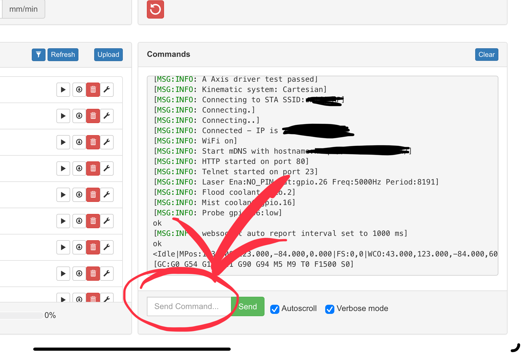

The only question I have left is where in the console (fluidNC) do I put the $Limit command? Sorry for being so silly, but this is my first time dealing with this.

That’s a good question. I don’t use FluidNC (I have an SKR Pro v1.2), but I’ll let some of the resident experts here guide you through that.
@CesarH (or anybody), can you please walk @Alejandra_Rodriguez through the FluidNC user screen, and show him where to enter commands?
Note also that it is $limits, (need the s as far as I know)
Thanks, edited my earlier post.

Thank you so much. I just saved the image to do it tomorrow in the workshop.:folded_hands:
Thank you much. Perfect
