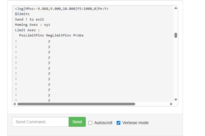

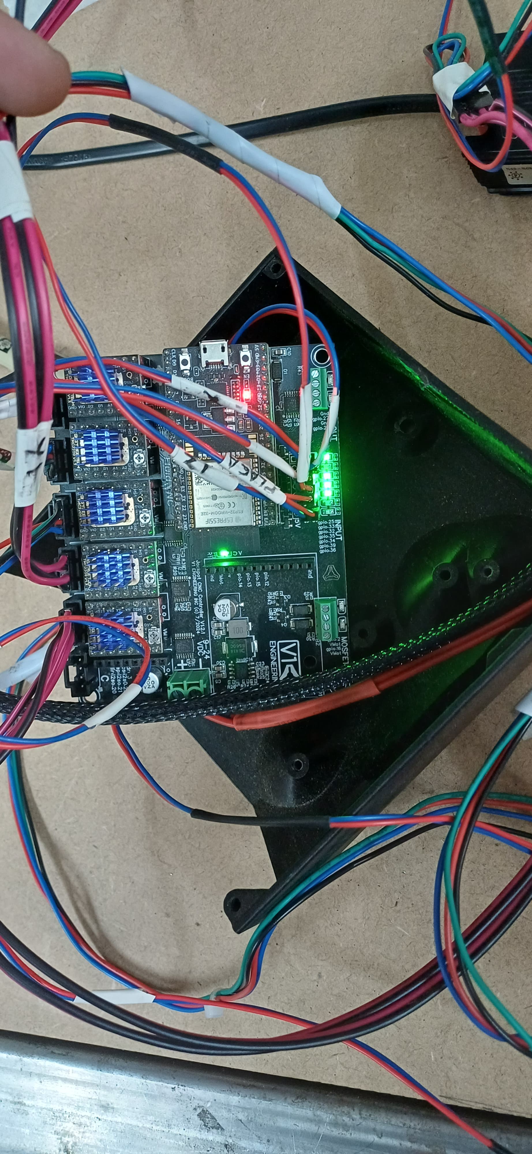

Guys, I replaced all the cables and Dupont connectors and used the $limits command. It keeps throwing a Y error; I’ve attached a screenshot. It also keeps disconnecting when homeing on any axis. It also disconnects after a while. I don’t know what to do. Another thing I’ve noticed is that several lights on the board are now illuminated at the limit switches (this didn’t happen before). All the lights are on except for Y0.
This is showing that your y0 endstop is triggered. If it is not actually triggered then you have a wiring problem. While that $limits screen is running you should be able to press and release each endstop and see it show up on the screen. That is a live view.
Okay, I’ll try what you suggested. Do you know what might be causing it to lose its Wi-Fi connection? Would I need to reinstall the build?
