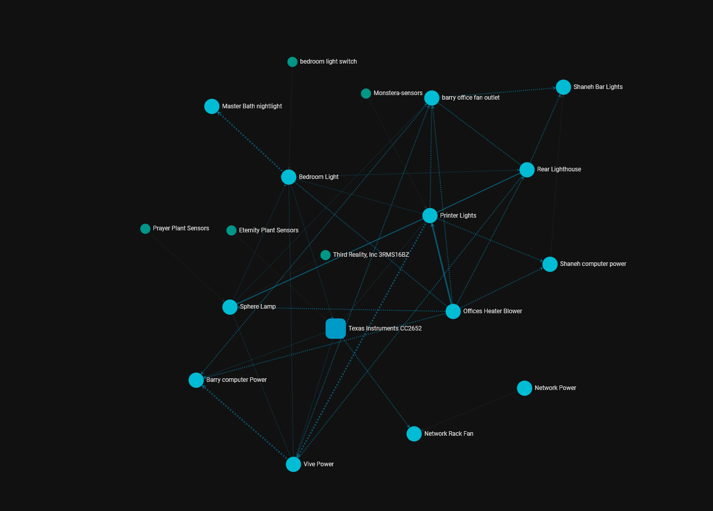

Where zigbee fits well is battery powered sensors like temp, humidity, vibration, door contacts and buttons.
You get faster ‘wake up’ and vastly better battery life than wifi and more data than 433 or 966mhz sensors. And it’s cheaper than z wave.
But that battery life comes at the cost of range so you need a lot more routers than you think if you want the whole house covered.
I use outlets with built in routers, just a few and of course it makes those outlets smart while extending the mesh.

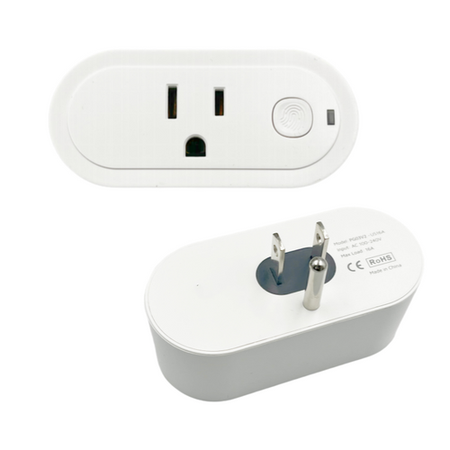

Smart plug with power monitoring:
You can usually save a few $ by not getting power monitoring but I think the data and ability to automate things based on power draw is worth it.

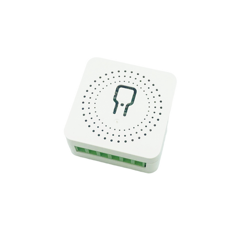

IR controller:
I use these for controlling our 2 heat pumps and they work flawlessly. Ultimately I might get another one for the lounge purely so the TV remote can be hidden away as all we do is use it to turn the TV on/off and very occasionally change volume.
IR Controller - https://www.athom.tech/blank-1/tasmota-ir-controller

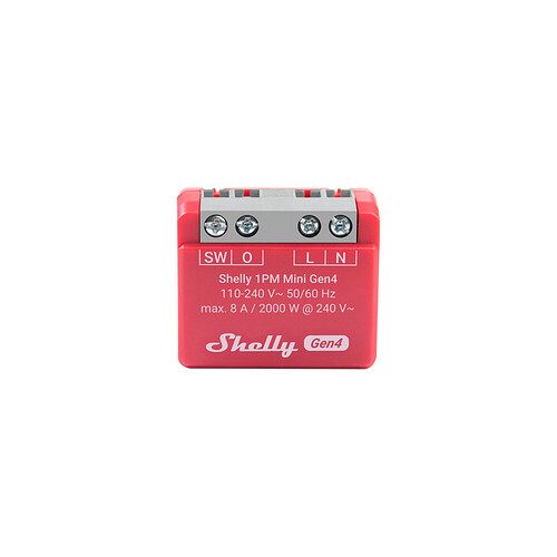

Lighting control:
There’s 2 approaches to lighting, one is leaving the switches on and using smart bulbs. I have far too many lighting points with things like decorative bulbs for that so I use just on/off control. For that I think Shelly is the best intersection between reliability, ubiquity and cost. They’re also tiny so you can easily stuff them in behind an existing light switch, even if it’s already somewhat full.
The 1pm mini (1 channel, power monitoring, mini size) is my standard go to. The 1 mini (1 channel, mini, no power monitoring) is a little cheaper and slightly more flexible in that it doesn’t have to switch mains. The 2PM is a slightly larger 2 channel version.

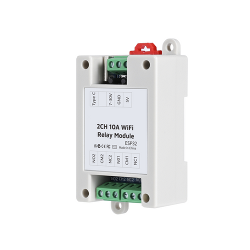

Larger Relay modules:
These are great for if you need something to be integrated into something else, or you’re switching DC instead of mains, or you’re trying to emulate a button press, that kinda thing.
I have the 8ch version of this as the controller for my irrigation setup. It works great. If I were doing the garage door controller over again I’d use something like one of these:
