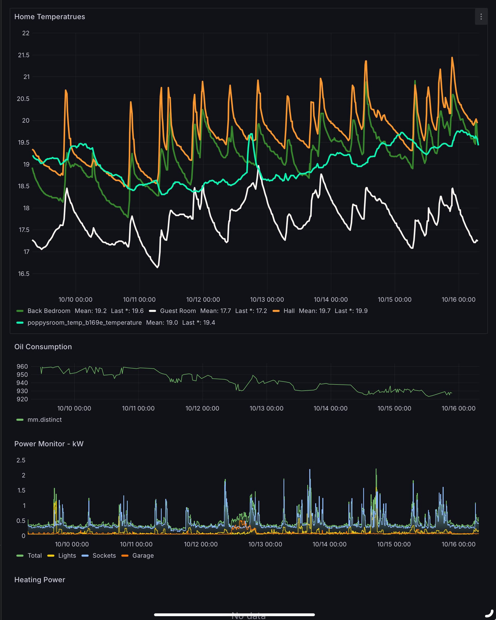

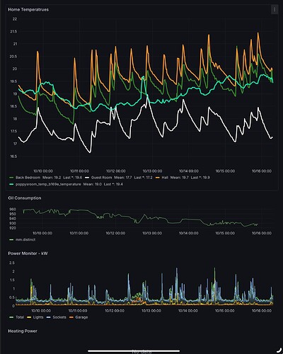

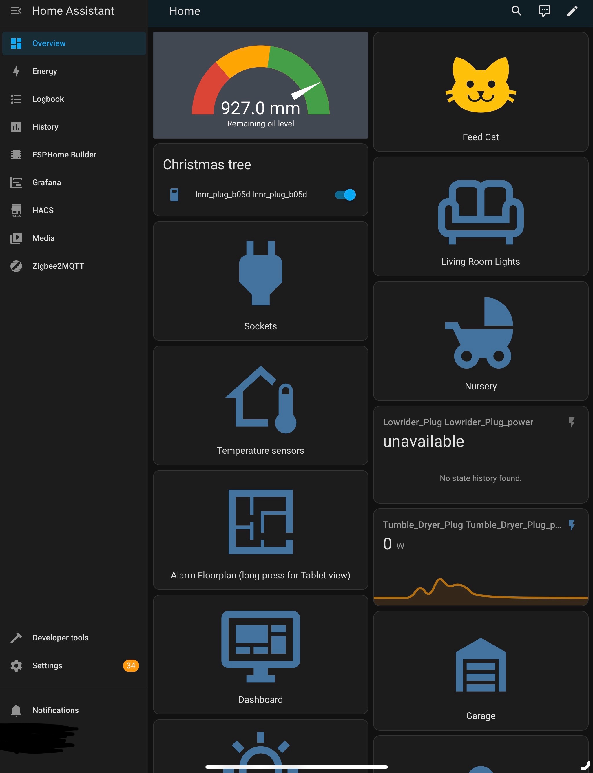

That’s the advantage of home assistant in my opinion, multiple device types all in one place. I have zigbee, lorawan, wifi, 433mhz sensors and buttons, all working and interacting.
And if you like data, you have data to play with
