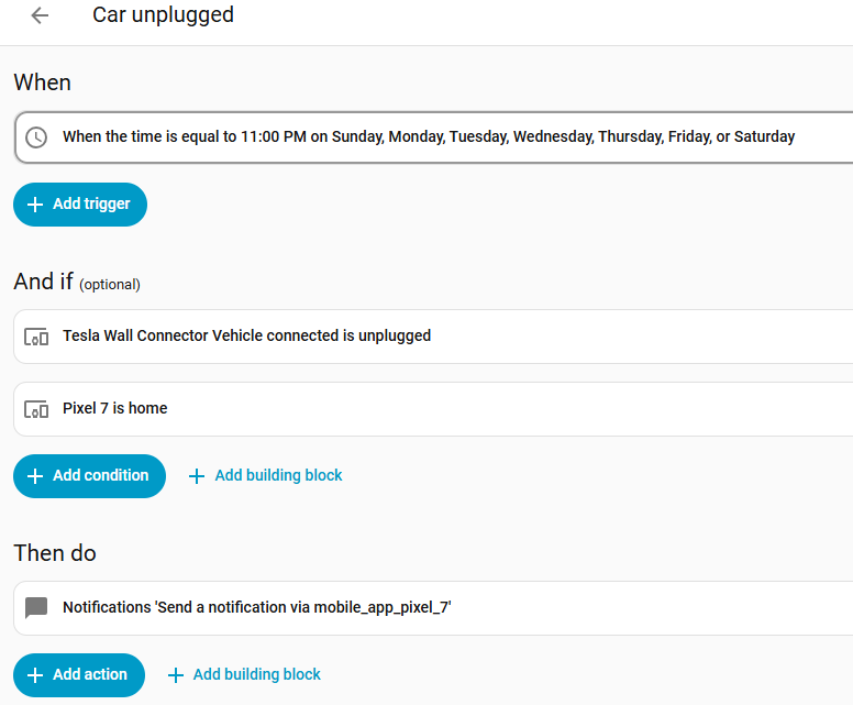

Just found a very useful automation (for me). Apparently Tesla powerwall charger is natively supported. It has kwh usage, way more than expected information about phases and voltages, temperatures, and more. It also has whether a car is connected. Its that last one that is most exciting.
There’s been a few times where I get back from a 300 mile trip, leave the charging cord unplugged so I don’t trip over it while unloading gear, and then forget to plug in over night. Only once have I had to go into work an hour late to charge up but there’s been a few tight margin trips. Or maybe I’ve been using the CNC located in my garage and move Lula out so she doesn’t get too dirty; then forget to move her back.
Now home assistant can alert me at 11:00 pm if the car is unplugged and my phone is at home! That will be pretty helpful in the rare scenarios needed. Phone notifications get forwarded to smart watch automatically.
