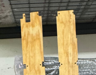

Help with Setup and First Cut
Looks like they moved on you on the last pass…
Yea I realized it’s an excuse to make a vacuum table !!

I know you’ve still got some stuff to figure out but you’re well on your way. Seeing someone go from this:
to this in a day:

I don’t see any tabs. Were there any in the EstlCAM file?
Hey Britt, what do you mean by tabs?
Holding tabs. It slipped my mind to tell you to make sure and add some. That will stop your board from moving when it cuts through. You just have to manually cut the tabs after and sand smooth.
