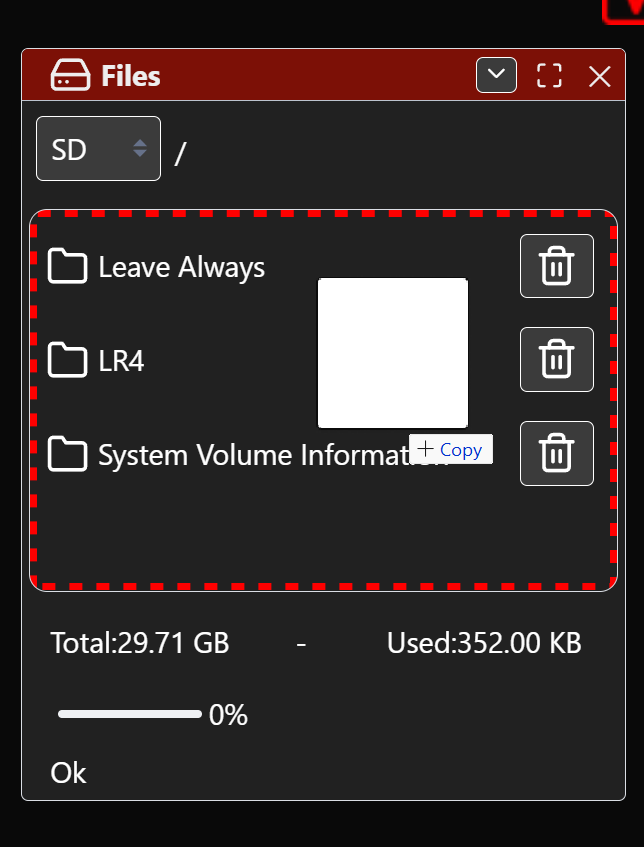

So I set up the file and got the gcode. Now how do I add it to the fluid Nc site. Specifically for the crown.

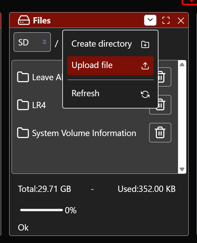

2 ways. You can remove the SD card and take it to the computer you made the gcode on and save it to the SD card, then reinsert it in the Jackpot and get it there. Or if you are wifi connected to the jackpot from the computer your gcode is on, you can pull up the webui on that computer and either click upload and chose the file, or drag and drop it and upload it.
If you drag and drop you will see the outline show up when you get the file over it. Once you let go it will ask if you want to upload it

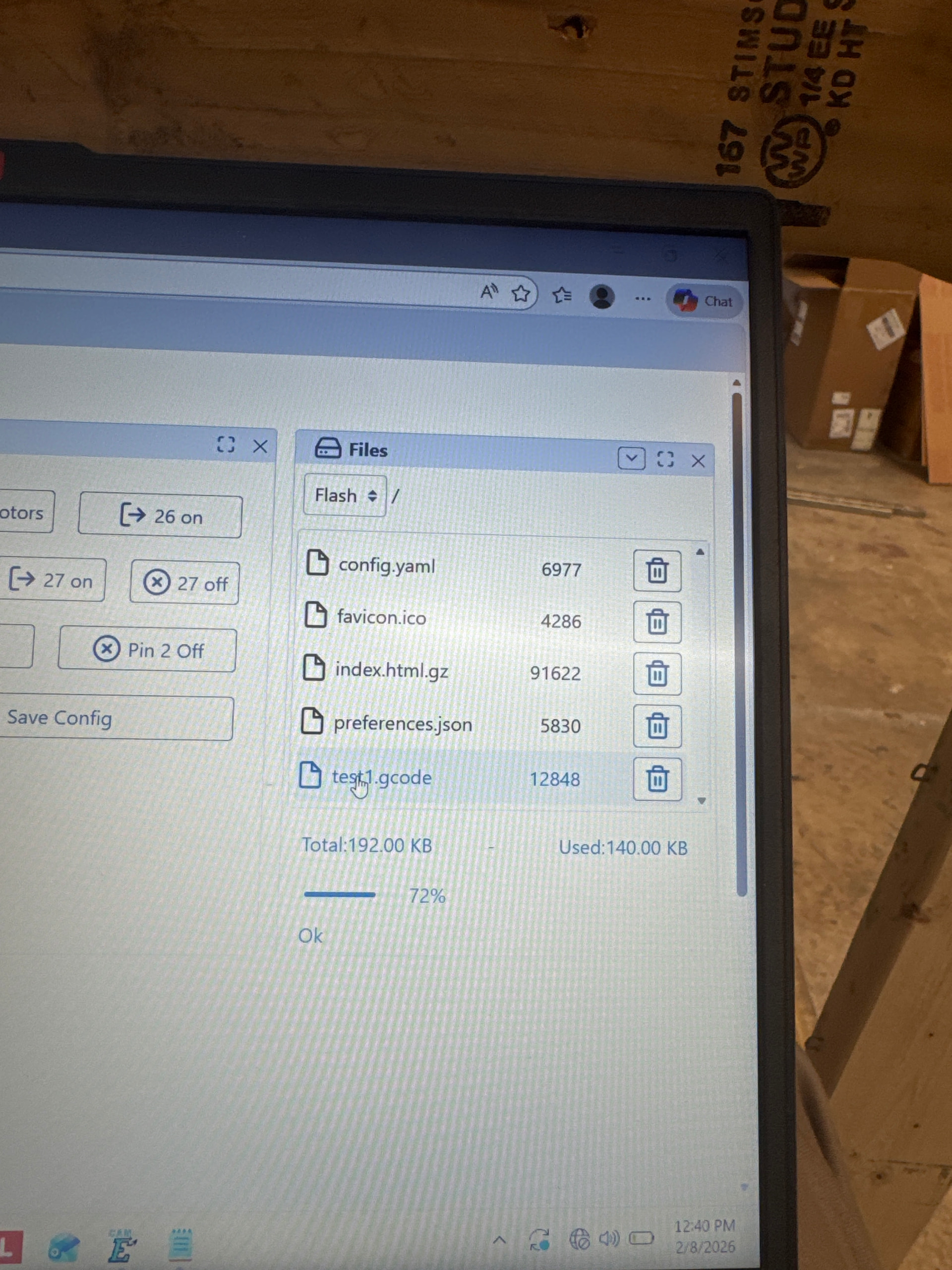

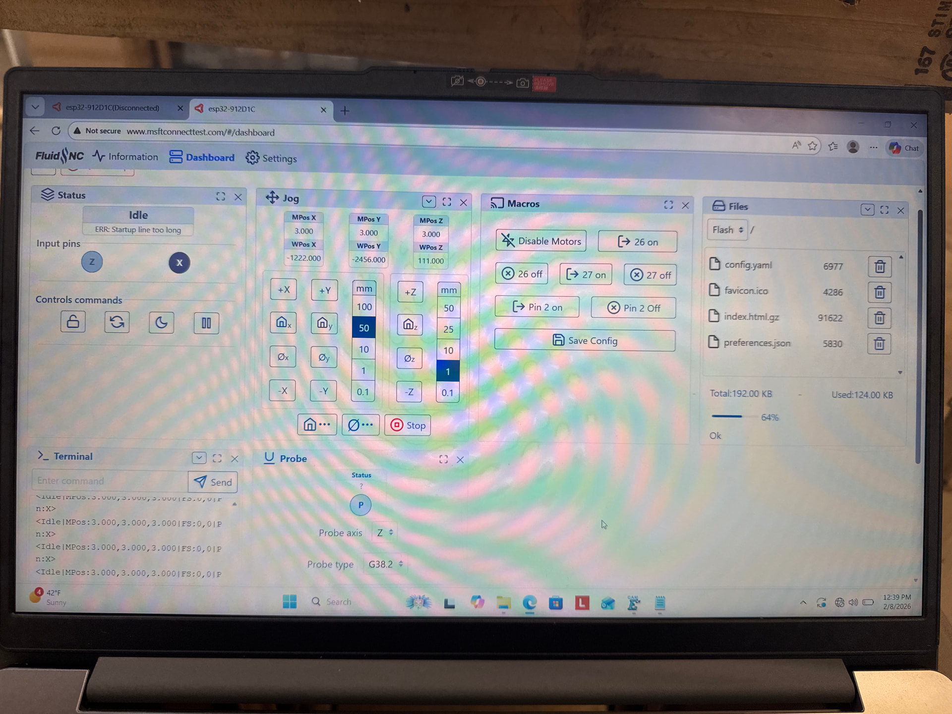

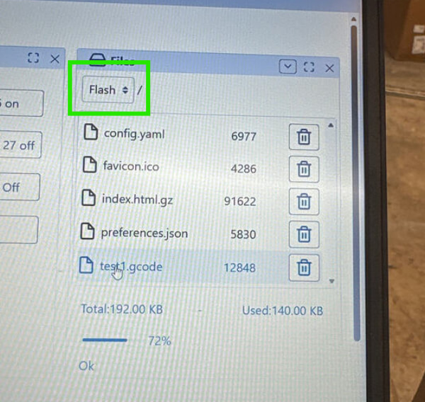

over the WiFi where do I upload it?
This is the file I made so far but where do I start it? Sorry for the million questions but I swear I read all the how toos.
Click on the FLASH and change it to SD card. You cant save gcode to the flash memory
