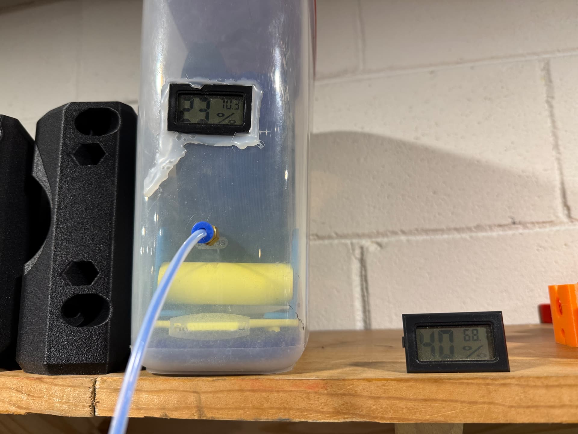

I have a bunch of these Humidity Sensors in all of my totes and dry boxes. Also have one out just sitting on the shelf monitoring the room. They are super cheap and seem to work pretty well. The lowest they read is 10% but thats plenty low. Anything under 25% you are good to go usually.
This is about 6’ away from a large dehumidifier that runs 24/7 for this room. If that wasn’t running it would be in the mid 50% in here and only that low because of the mini split on the wall.

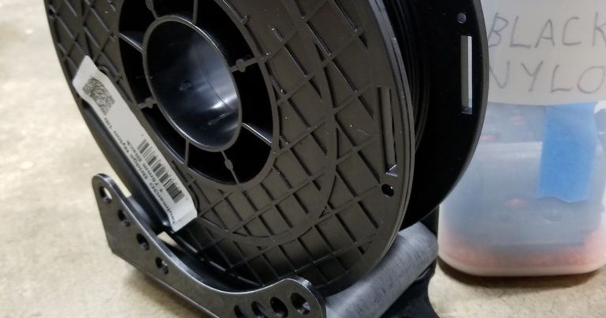

I use these Rubbermaid Containers as a dry box to feed to the printer. I have a 3d printed spool holder in the bottom. I will try to find the file and link it for you
Here it is…
I print the bottom part that’s the desiccant riser and pour desiccant in the bottom of the box before I put it or the spool in.
I use these 20 quart containers with a lid that has a gasket. I can fit 4 spools in there and I just put some dessicant in with them.
