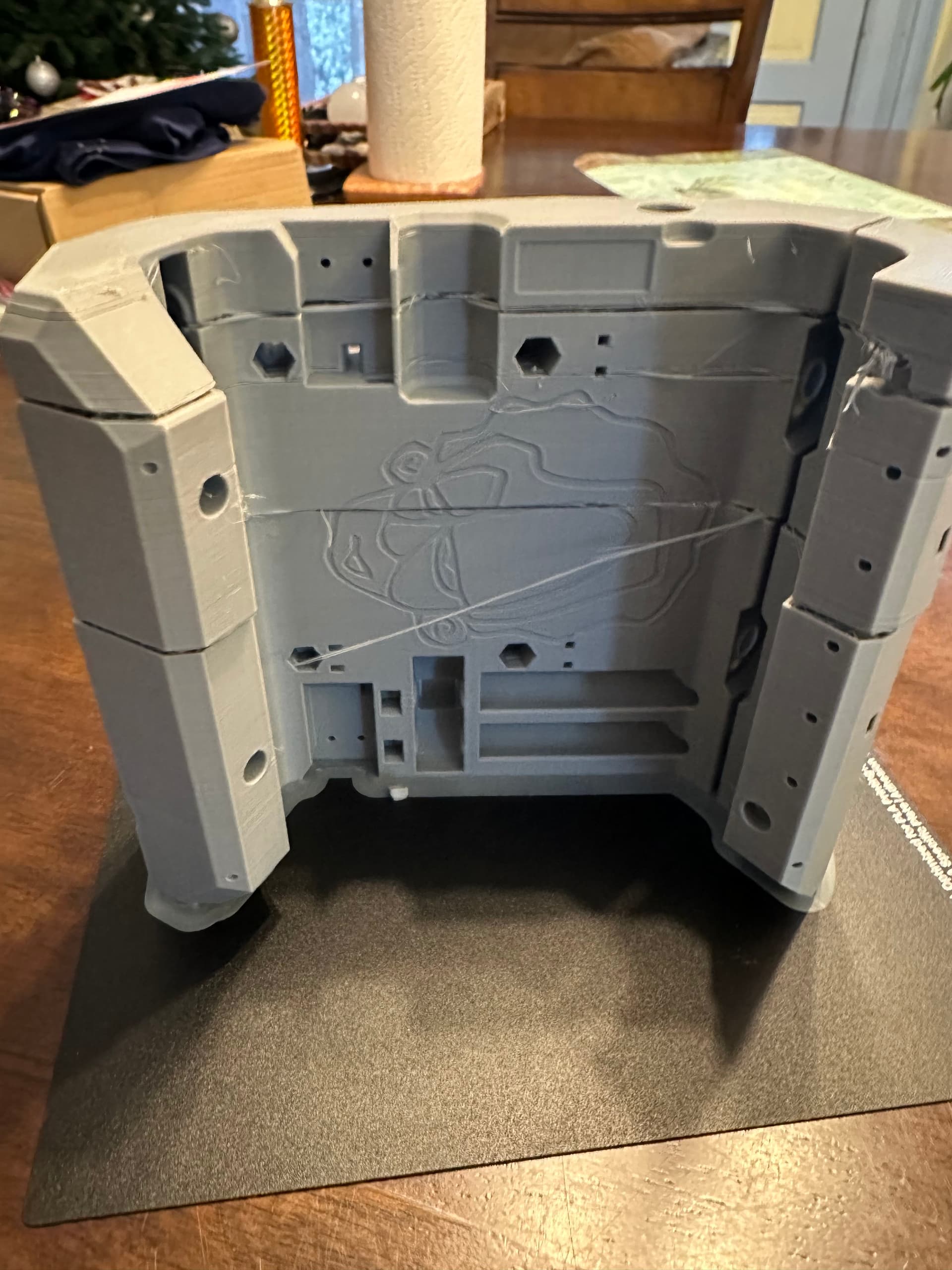

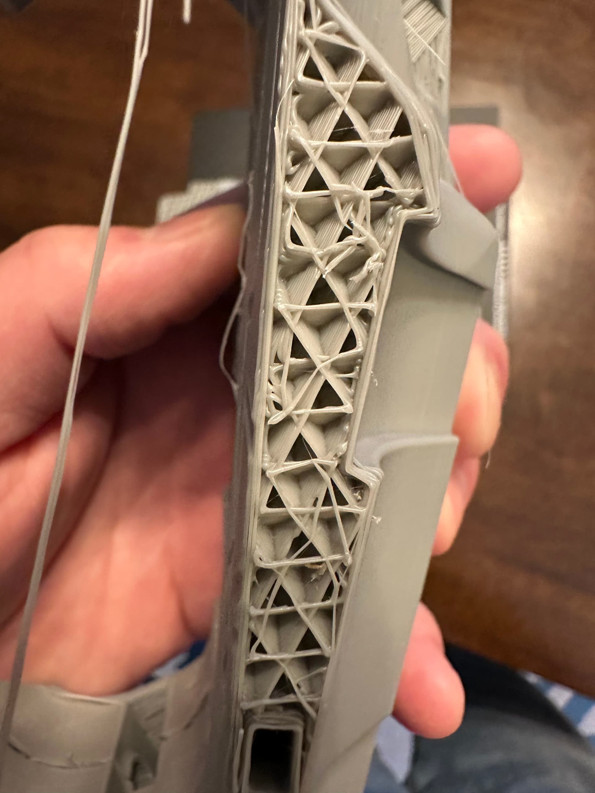

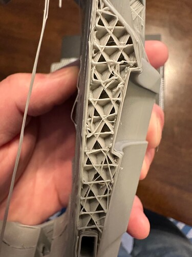

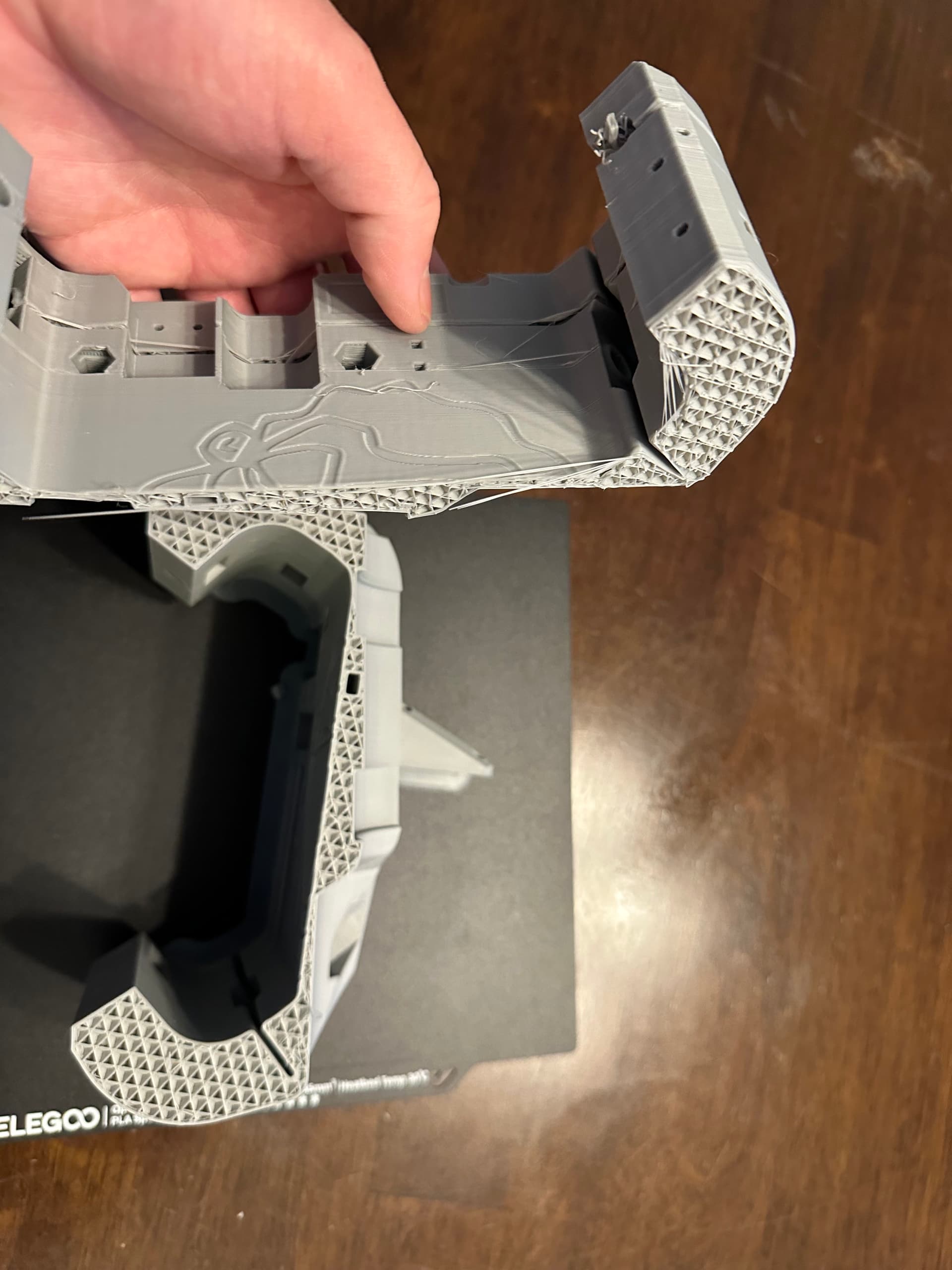

My first print job was an attempt at the Core part at the top of the list linked above. I started it in the evening and it finished some time in the morning (12+ hr print). When I checked on it, I saw that there were several layers that seemed to not adhere properly, a few critically (the pieces fell apart when I tried to pull it off the plate). Are there any known causes, tips or suggestions on getting a successful print?

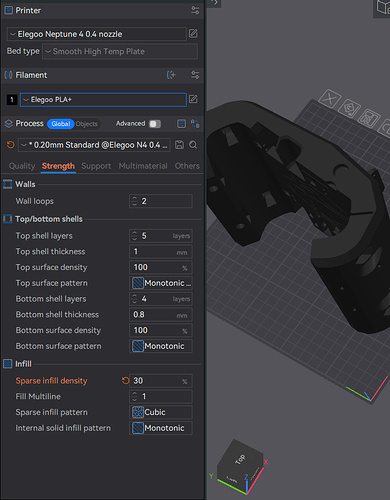

I ensured the settings in the software were correct, including infill @ 30%

Yes, there are. You need to tune your printer, and your slicer, and get some more experience with making it work right before you’re ready to print a core.
As noted above, PLA+ is less suitable for a CNC because it is less rigid. It also takes different printer profiles as the additive packages make it really a different filmament than regular PLA.
You appear to have bad layer adhesion. This may be from too cool a print setting, wrong cooling, extruder issues, slicer issues, or filament issues. We will need to work that out.

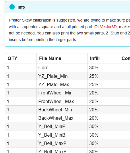

I wasn’t specifically going for the biggest, most difficult piece, it was just the first part listed in the table of the documentation:
If there’s a recommended starting point / order, perhaps that should be in the documentation. I noted that it mentions the z_Stub and z_Nut parts, but as I’ve done a decent amount of printing other things, I’d thought it unnecessary.

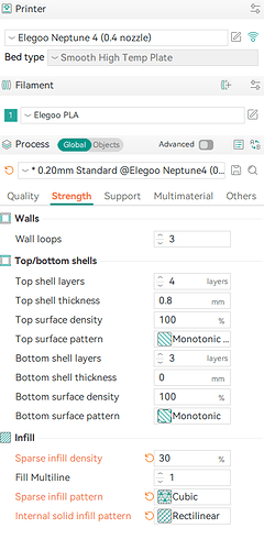

So apparently the Elegoo slicing software is based on / a fork of the Orca software and looks identical. Does this look like the proper settings for a 30% infill?

Sometimes you just get a badly wound roll of filament that snags enough to cause gaps like that.
