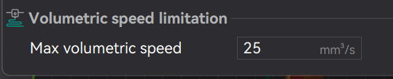

Make sure in your slicer filament settings that your volumetric flow rate is not over 27-30 mm^3/s (according to google - verify this) for the Neptune 4 pro.

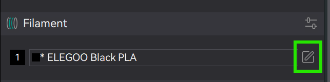

As far as volumetric flow rate, do you know where that setting may be in the software? Orca or fluidd?
It is a setting in your filament settings.
In Orca…
On the filament tab scroll all the way to the bottom…
Don’t copy my number. YMMV In Orca you can run a max flowrate calibration and figure out what your printer can handle.

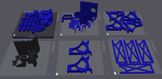

Good idea. Personally… started with Z Stub and Nut to check clearance/fit, check captured nuts seat without too much of a fight. Fix print issues, then… braces one by one, carefully observing print quality and tuning between each print, other parts, YZ plates, then the Core.
I appreciate folks with tuned printers they trust will print batches of plates full of parts.
You mean like this???
That’s just the PLA parts I print. Another 5 plates for the PET-CF Parts :partying_face:

Do you manually swap plates between jobs, or do you have some form of automatic setup? I presume you use larger spools for this kind of batch work..

Not that fancy. I just manual swap. I have them all loaded on the 2 printers I use 99.9% of the time to print the PLA parts. Just start the print from the screen and when its done I start the next one. I can see on the screen how long each print takes and try to time it to let the longer prints run over night or first thing in the morning and the shorter ones during the day when I can easily swap them around.
All 1kg spools for PLA. I run 2 Qidi Q2 printers with the Qidi Box so I just load up enough spools to make the color batch and one spool of black for the black parts. It will move to the next color spool as one runs out.
I am looking at going to larger spools for the PET-CF parts. I use 2 Qidi Q1 pros to print those on and they are not the best at stopping on time when filament runs out so looking at going to a 3kg spool for those so I don’t have to babysit them so much.

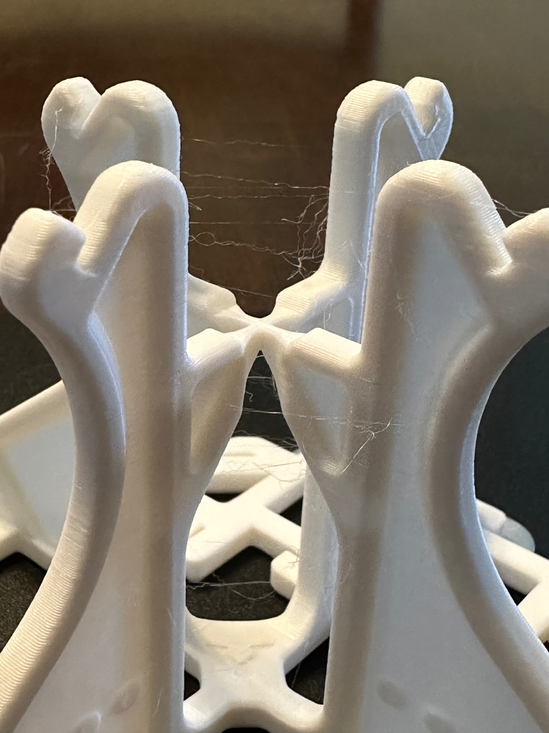

Just finished printing, and visually the print looks fine (don’t see any layering issues). Is it typical to get these “cobwebs”? I’d think tweaking the extrusion temp may help..
That’s stringing. Most likely from the filament being wet. But could be from bad retraction settings as well. But on a newer printer I would say dry your filament first off before I would try changing anything else.

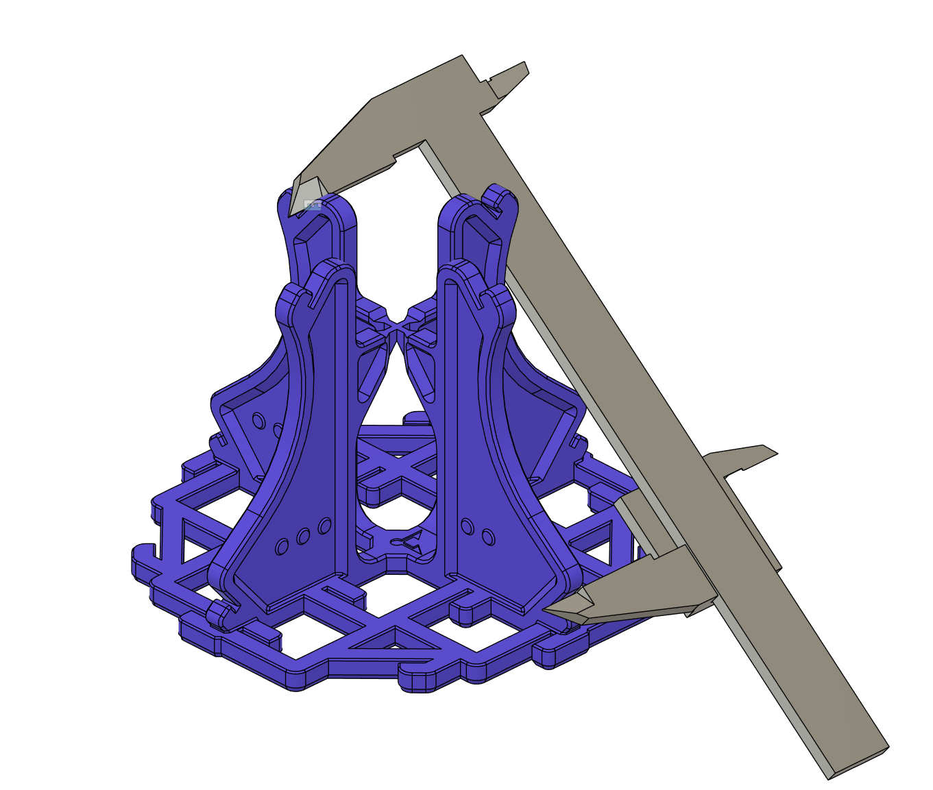

Have you done the measurements on your calilantern yet??
No measurements yet; I’m multitasking with my real job :sweat_smile:
For drying filament.. I guess I wasn’t aware how serious it is - I’ve kept my filament in the bags they came with (though not sealed). What’s the best means to dry a spool?
Most of the time the filament comes wet brand new. Personally I use a dehydrator to dry it. for PLA a good 12 hrs at 50° C works good. Now a days true filament dryers can be had for around the same price as a food dehydrator.
