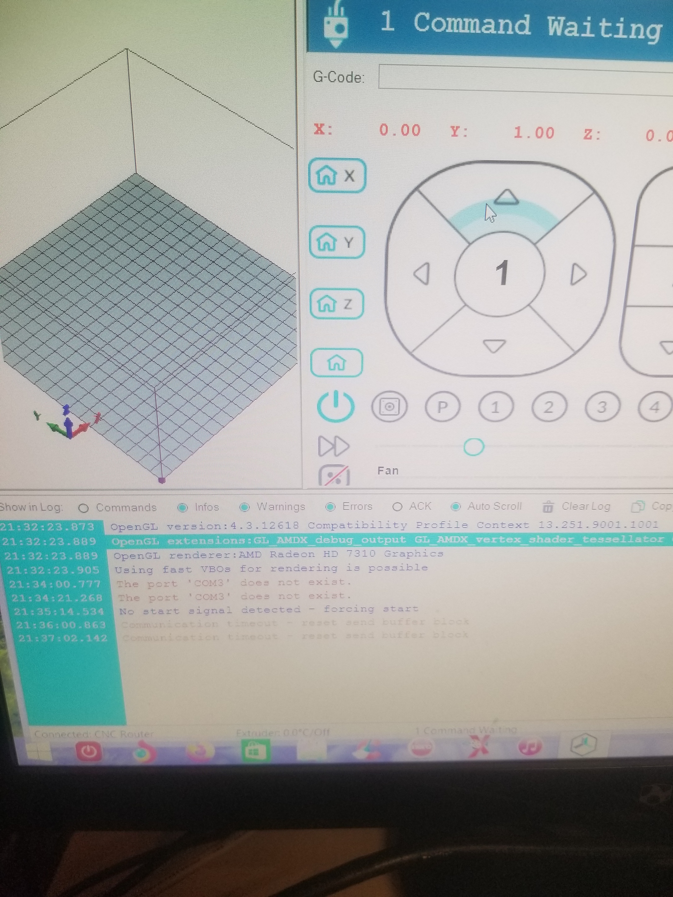

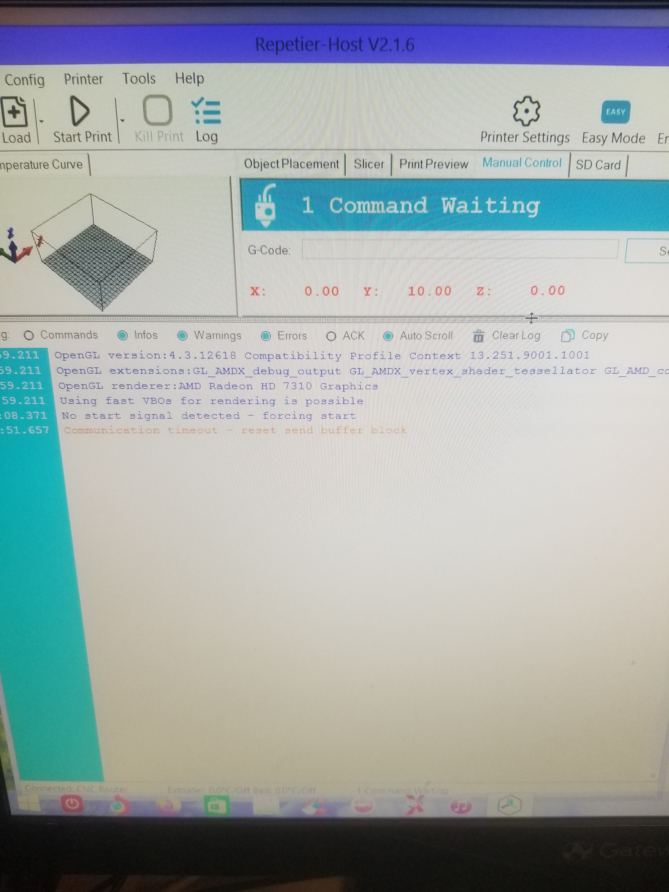

This is what it show at start up and try to mo e it. It a 1 command waiting
You uninstalled repetier SERVER and host, restarted your machine, then installed just repetier host? Has the computer been updated at all or is it some old machine that might be really out of date?
This is not an issue so you really gotta be super specific on what exactly you are doing.

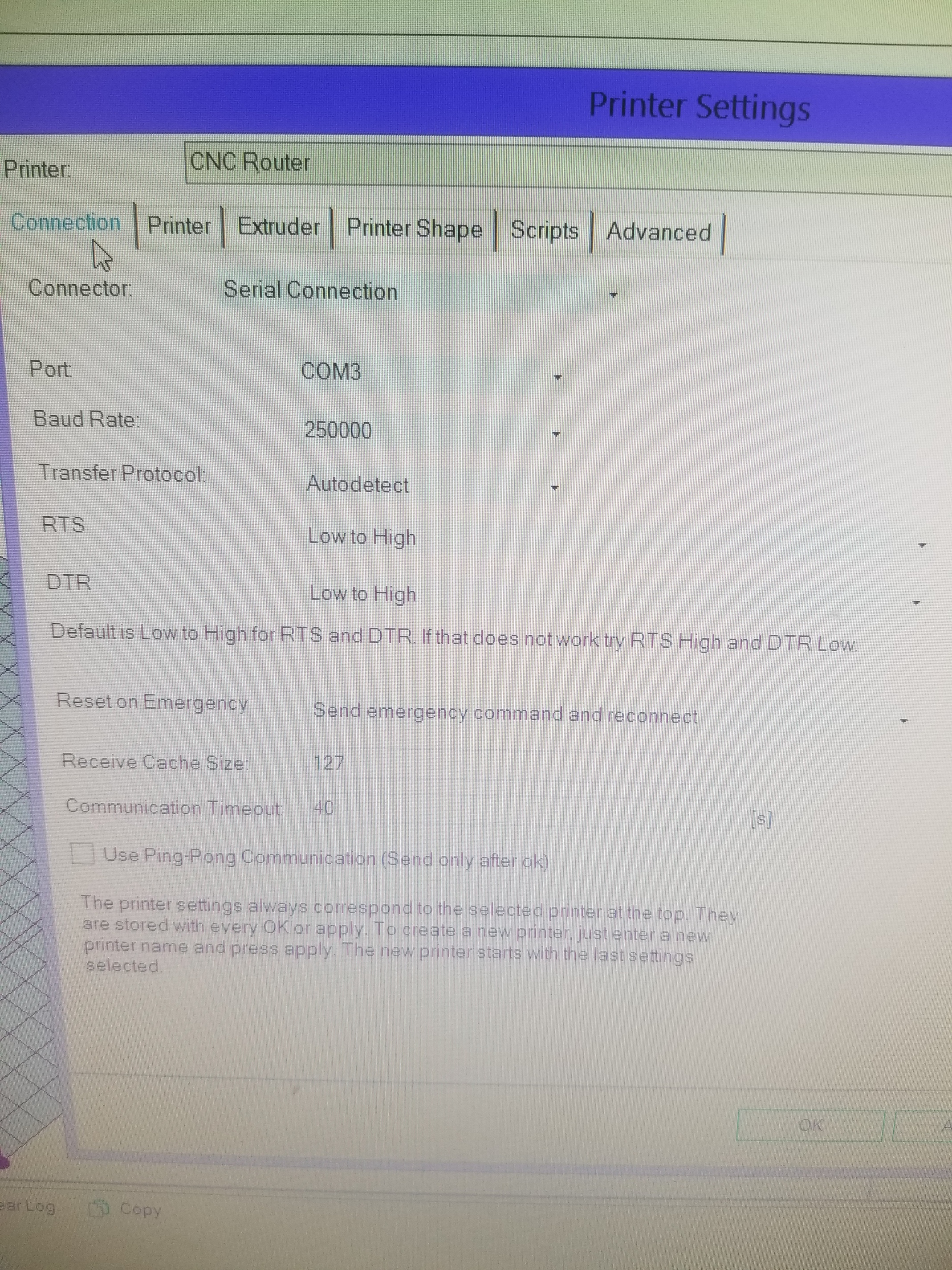

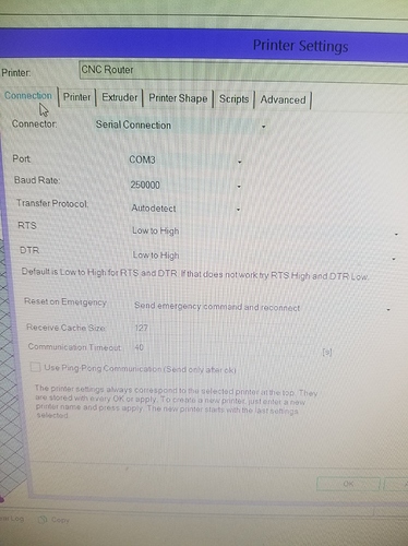

All update are up to date. I have try different cables. Are the setting for baud 250000?

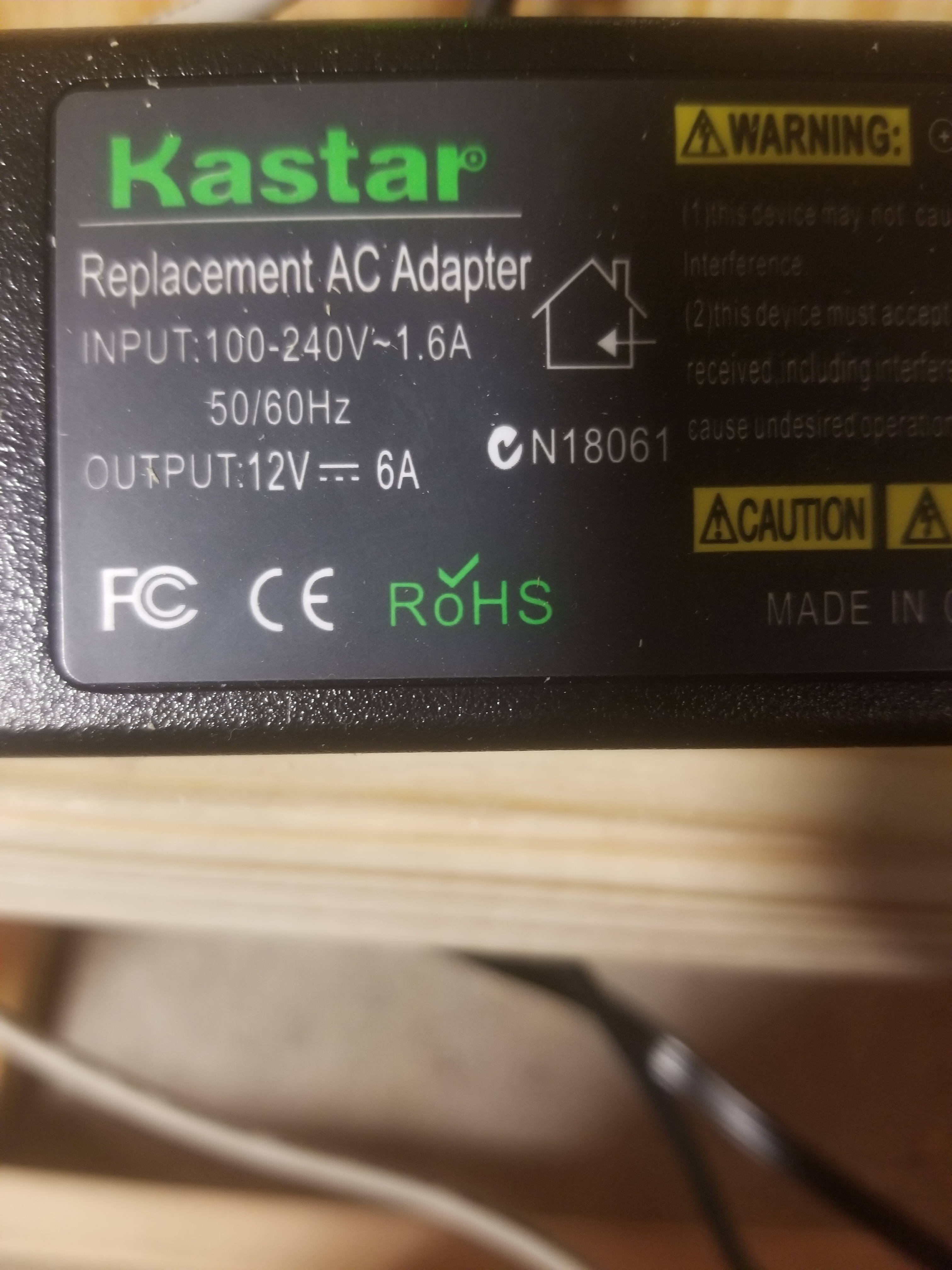

What kind of power supply are you using? How many amps does it output?
Using power supply from V1 package
If you are using the green power adapter piece take it off and use the wires like the instructions show. Or test it with a multimeter to see if you are actually getting power.
Can you put a multimeter on it? I’ve had two of those models go bad. (Though not purchased from v1 store)

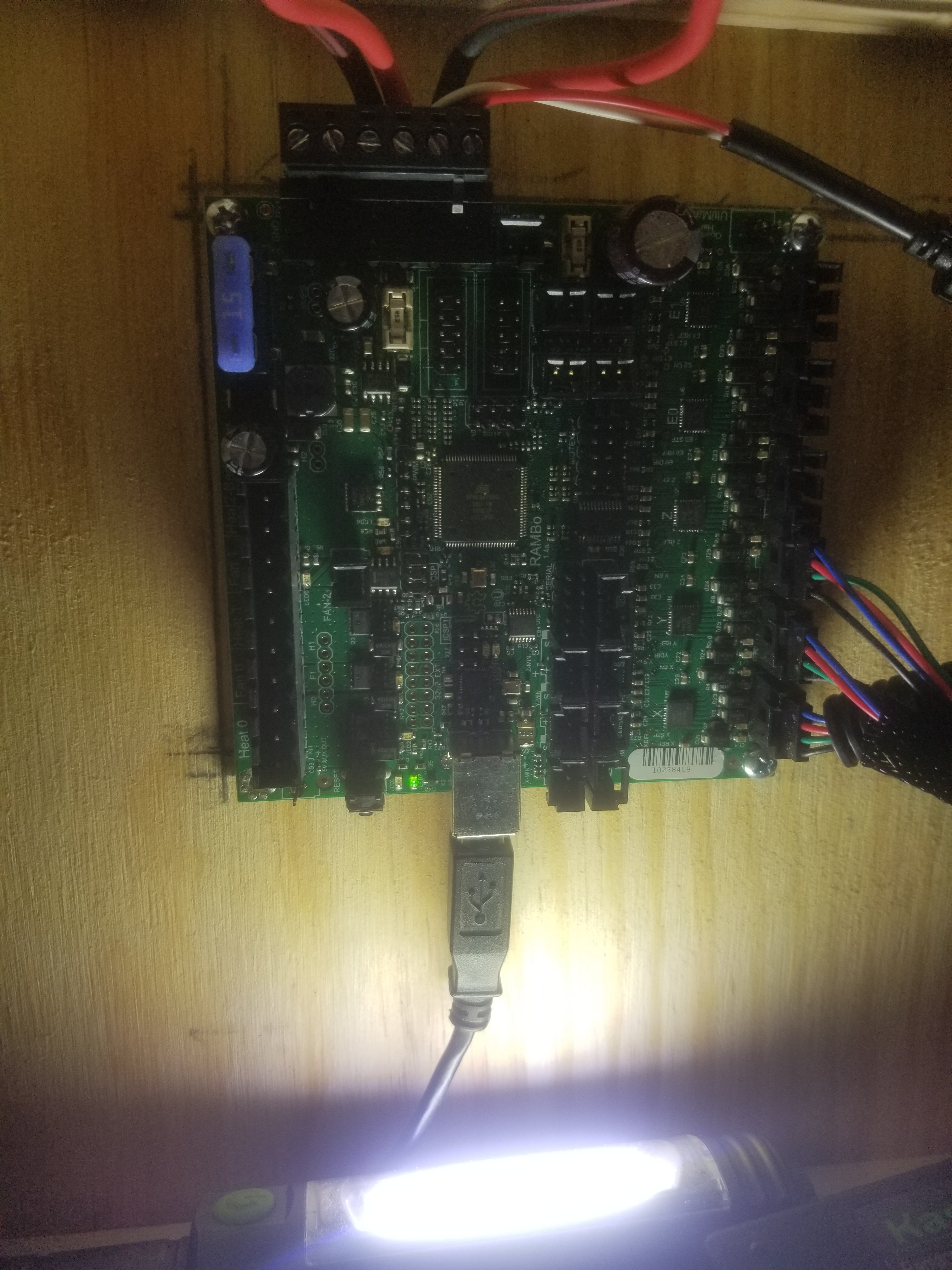

How about a picture of your board wired up
You are sure the two tiny fuses are still good? did you take them out and test them?
Yes fuse are good just checked them. I’m at a total lost here.
You do not have the LCD?
