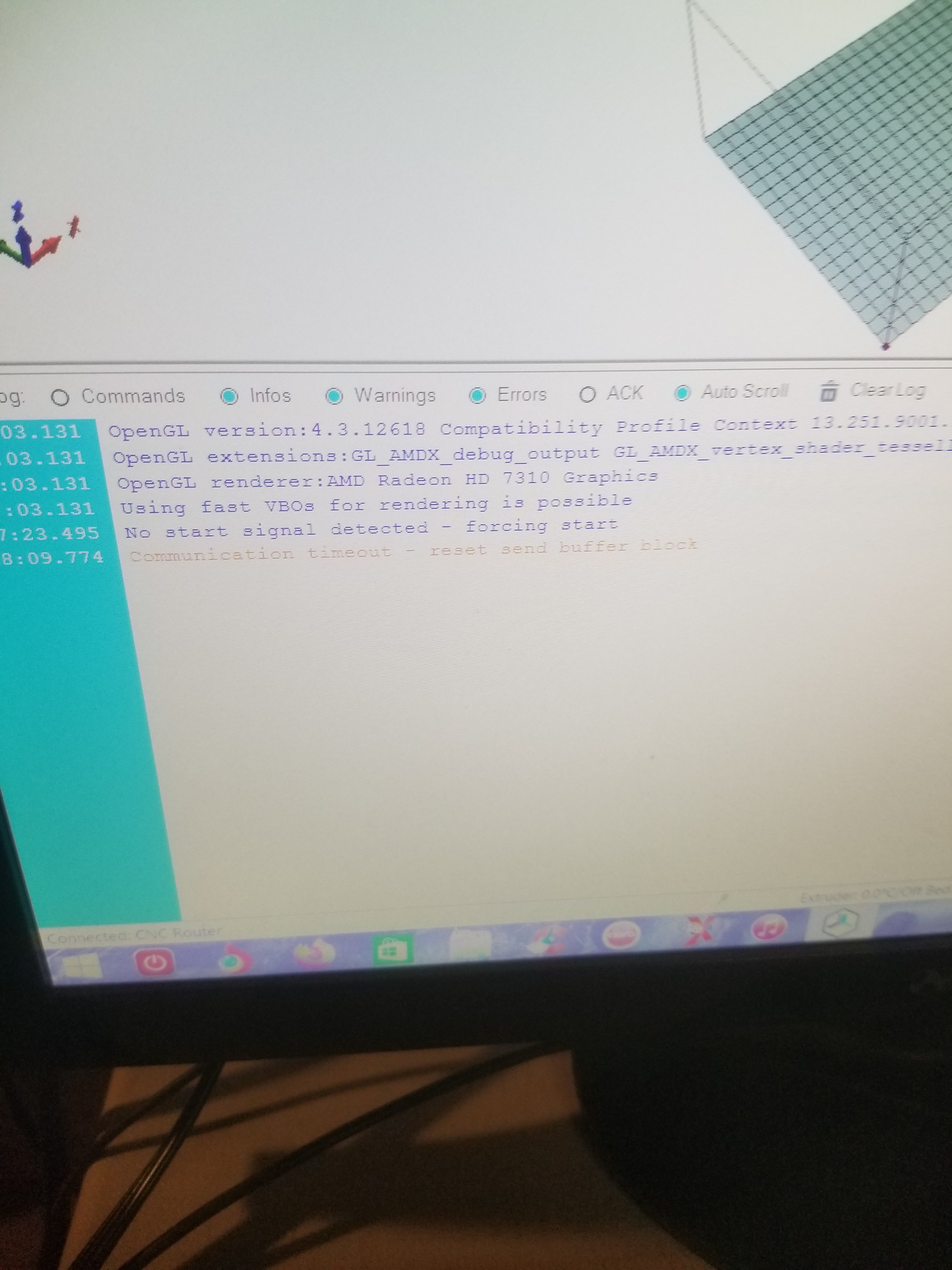

Ok installed rambo 4. No response at all.

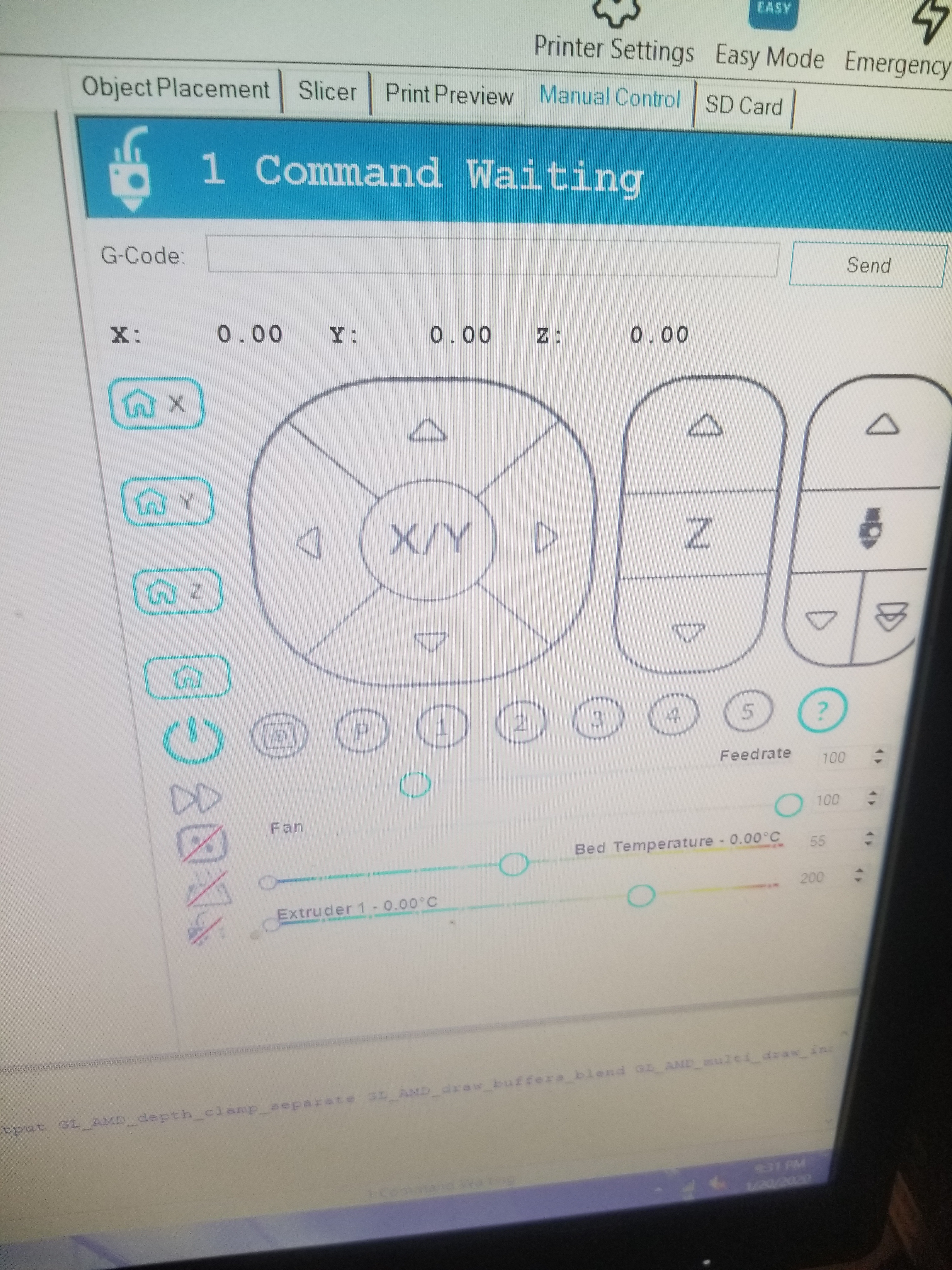

This is all it says now at bottom machine will not move or do nothing
I give it manual command to move and this is all it says

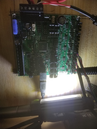

That communication timeout means it is still not connected. Can you share a picture of the board?

Are you sure it is getting power?
Green light is on all fuses are good

Is the green light on when the USB is disconnected?
Yes it stay on
Can you confirm you have installed the driver I linked to on the rambo wiki.
Yes rambo driver is installed
The link I gave you is a windows USB driver. Did you get that one?
