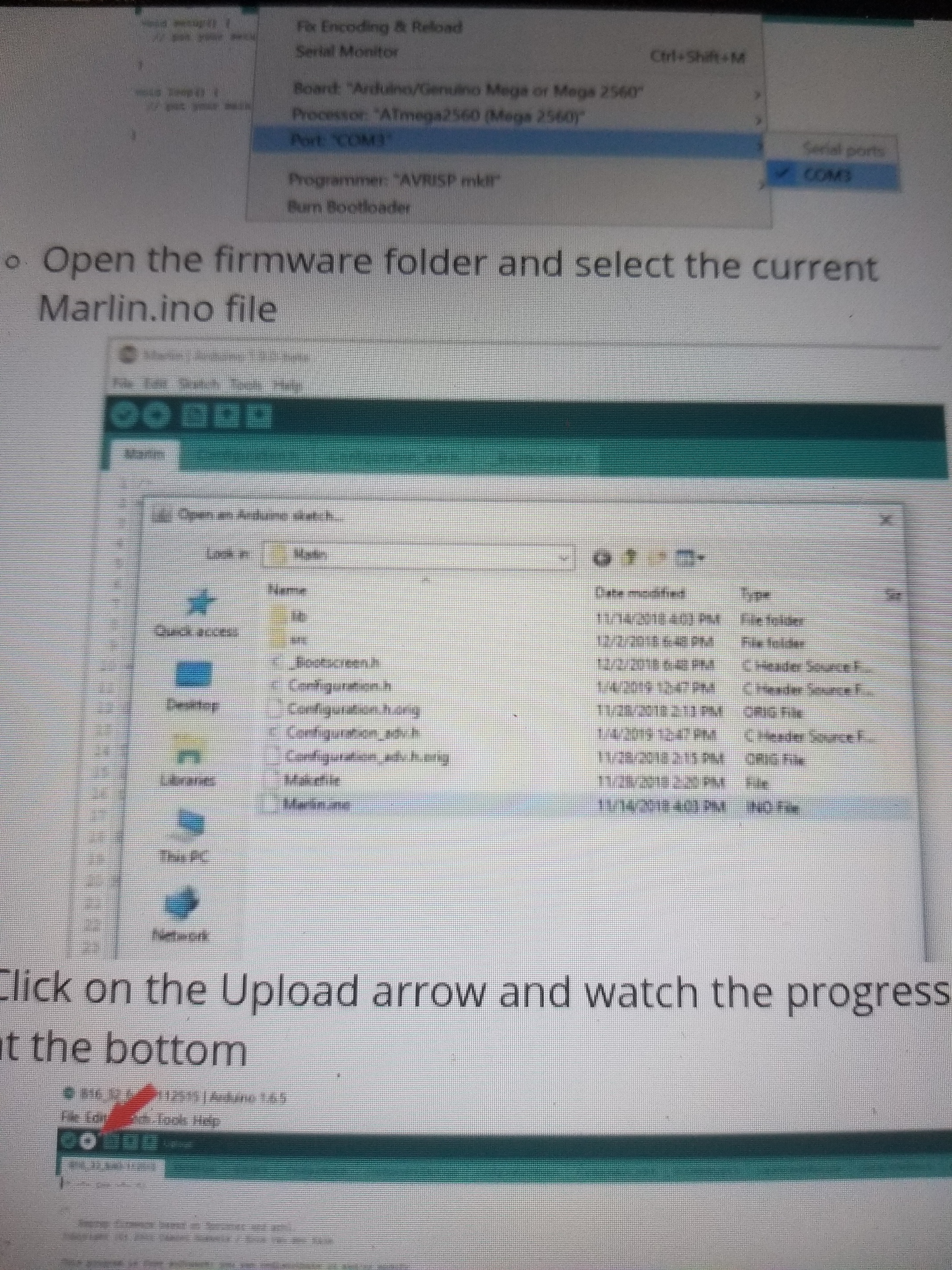

Can you give me idea how to I’m really lost at this point day 2 and can’t make machine work.
Went through your steps to point in pic. Can not figure how to get to open firmware fold
You do not need to install the firmware on the board.
Just install Arduino (for its drivers) you do not need to use it. Then install repetitive host, then try to connect.

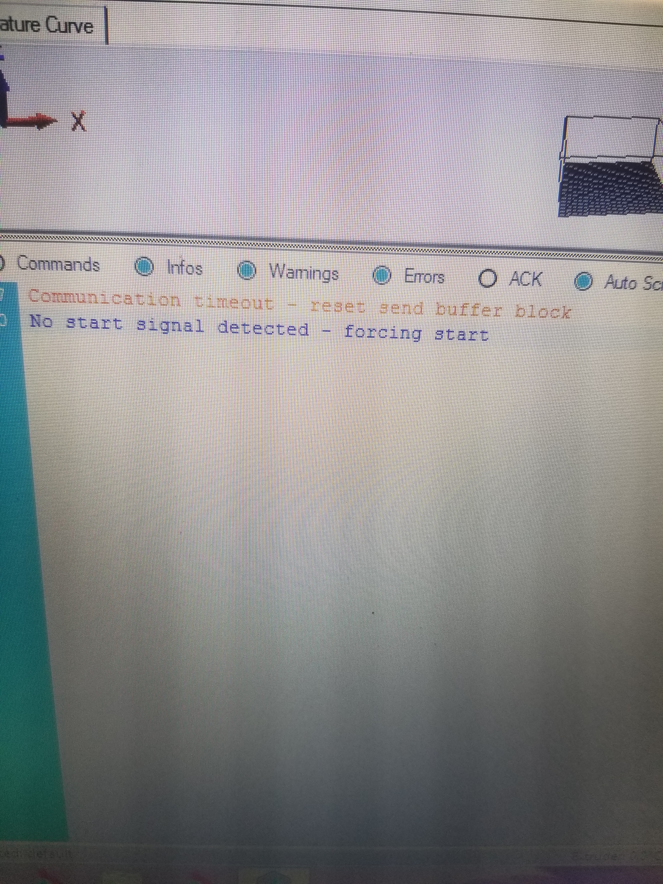

No movement at all
I have try all those steps. Rep doesn’t nothing. In port it only come up com 3. Can not move in no direction. I am really lost. Going to go on day 3 can’t get it to respond to no movement.
Since you already had repetier installed did you check the settings, baud rate?
Set all setting to start up setting. Baud at 250000.
Verified you have the correct com port?
Doesn’t matter what USB you plug into it come up com port 3
Can you double check to make sure your fuses are still okay.
Does windows make a sound when you plug it in?
Check all fuse they are good. Yellow flash when connect on board
