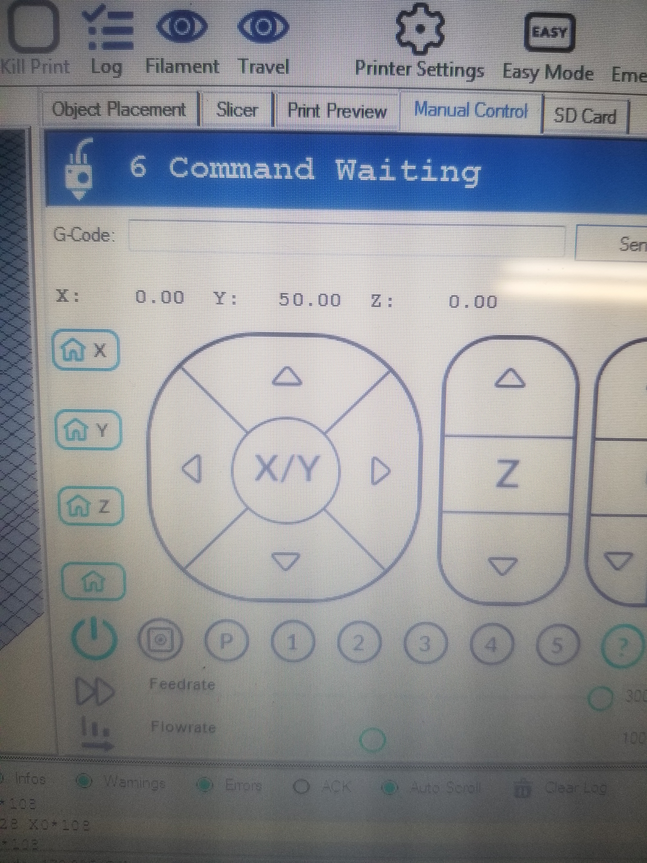

I got the z to move but x and y doesn’t move at all.

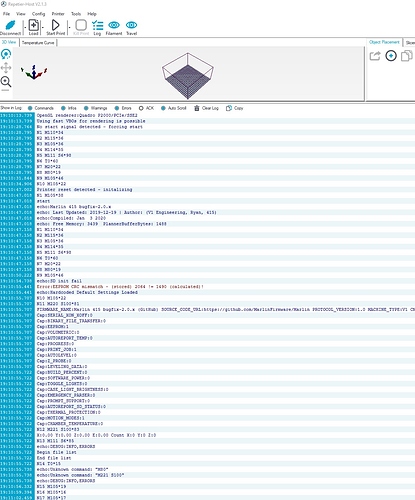

Z move correct no x or y

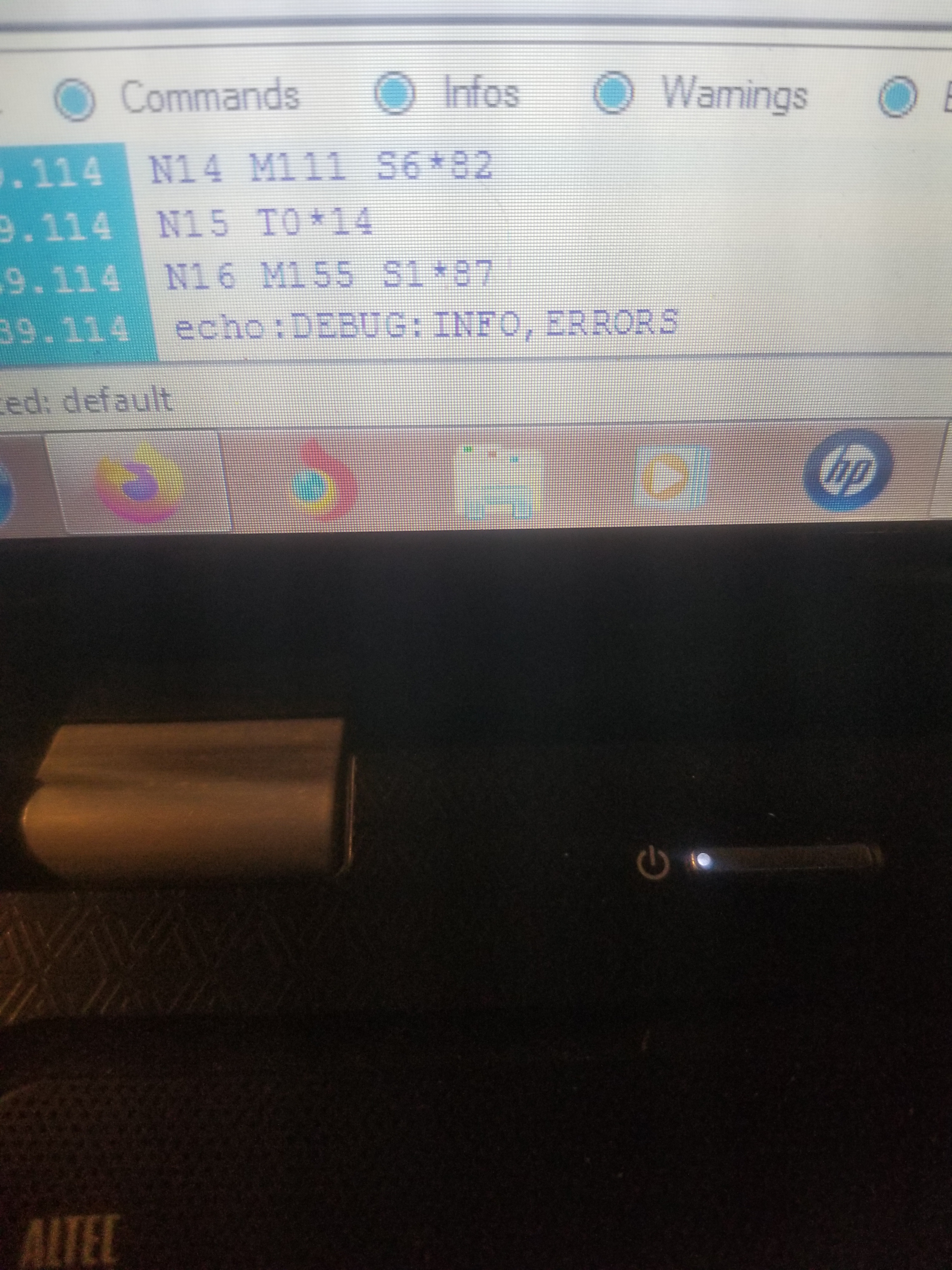

Connect and I get a debug :info ,errors

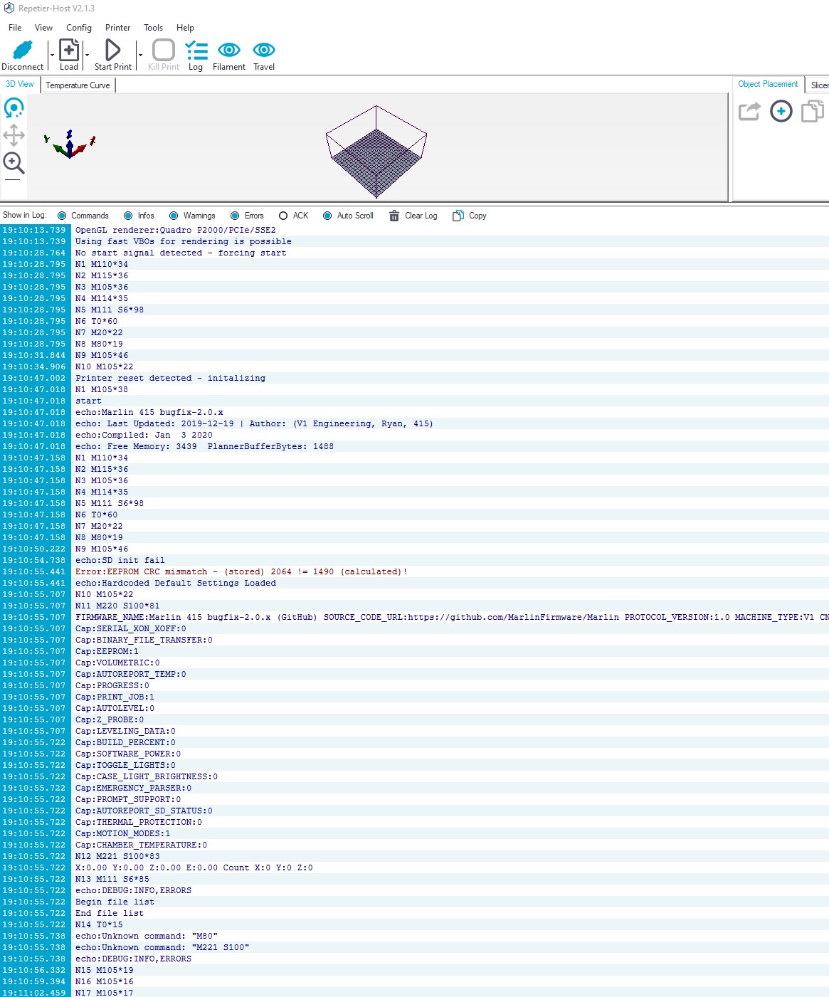

Expand that message window up and do a little scrolling, if it is connected you will either see “Johnny”, or “Ryan” which one do you have?
Not sure what you asking
That little sections where it says debug errors, you can expand that section and scroll through it. There is a lot of information hidden.

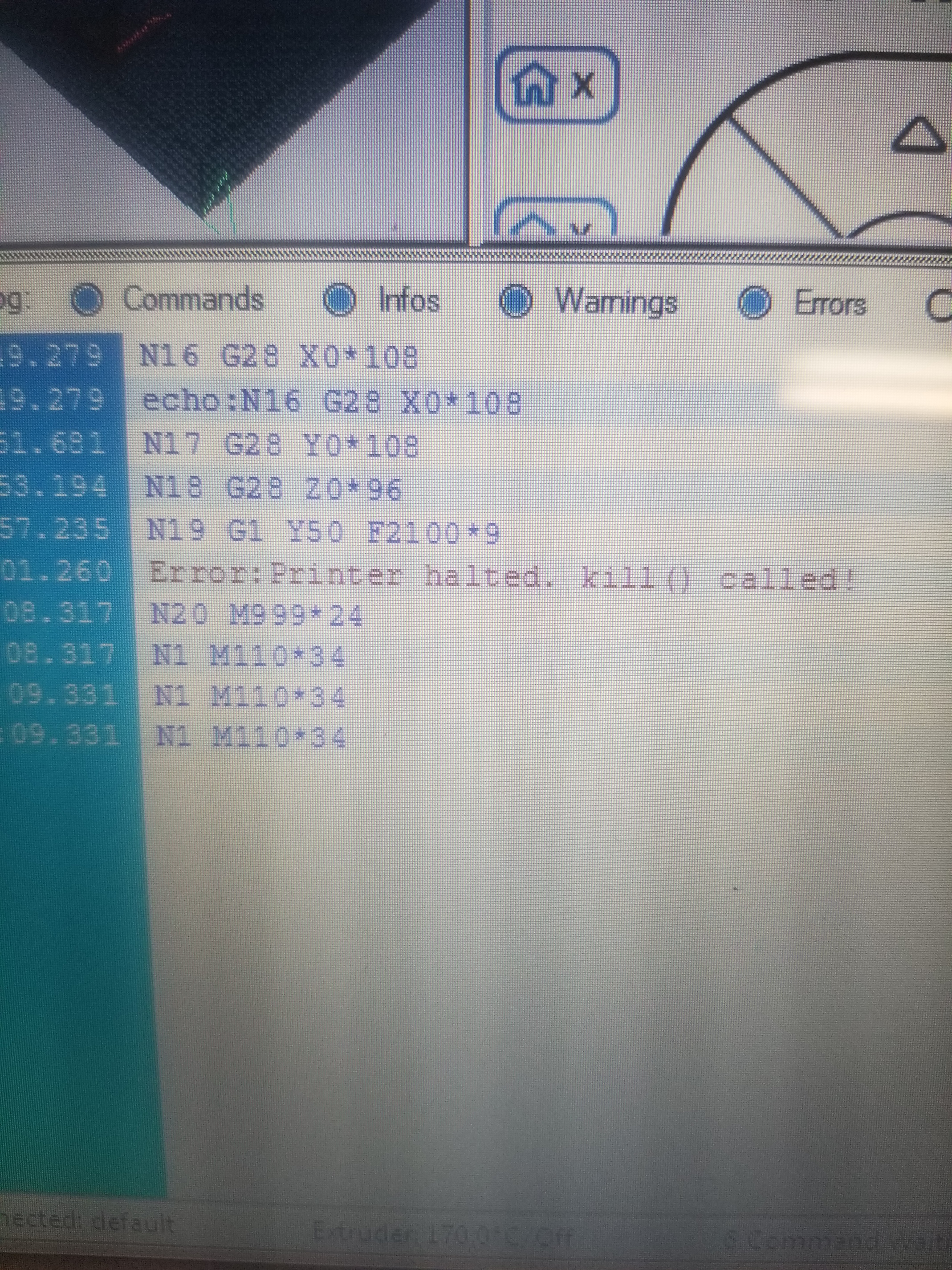

All I get now is error printer halted anytime I manual move it. I can not get it to move in manual at all. Followed all the step
I try to move it error come up and this is what it says at bottom
It always says error, we need to see the rest, like this.
machine never moved.
I can load crown program and will run program but machine will not move at all
That info is just there when you connect, no need to do anything else.
I suspect you are not actually connecting. If you can not expand and scroll the error window like I have shown in the screen shot you are not even connected, regardless of what the little icon says.

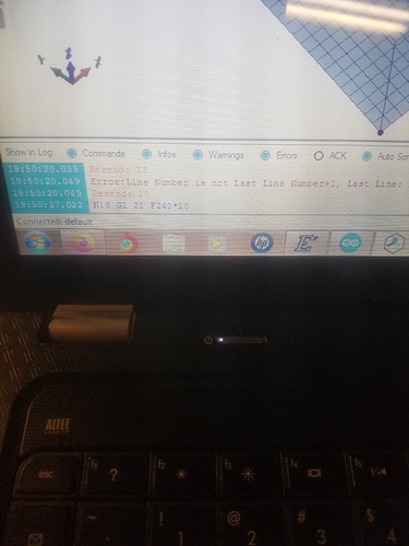

No matter what you should be able to connect, moving is a whole different thing. Just connect, and expand and show more of the error message window, there is more for sure. Make your reptier window look like mine.
