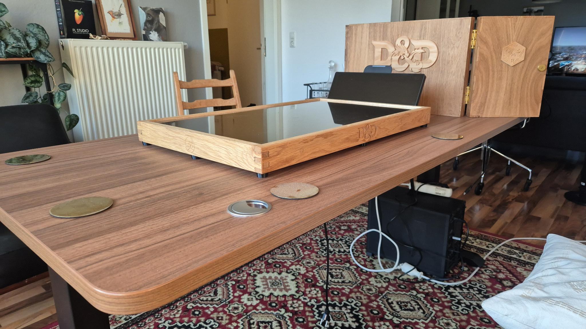

The box designer got a major update. It can now also create a lid or two doors. The nesting was also majorly improved.
What it can also do is generate the complete monitor casing for a battlemap for DnD. Just enter the size of your monitor and nearly everything else is created automatically.
Then you can add magnets, the holes for the power plugs etc.
