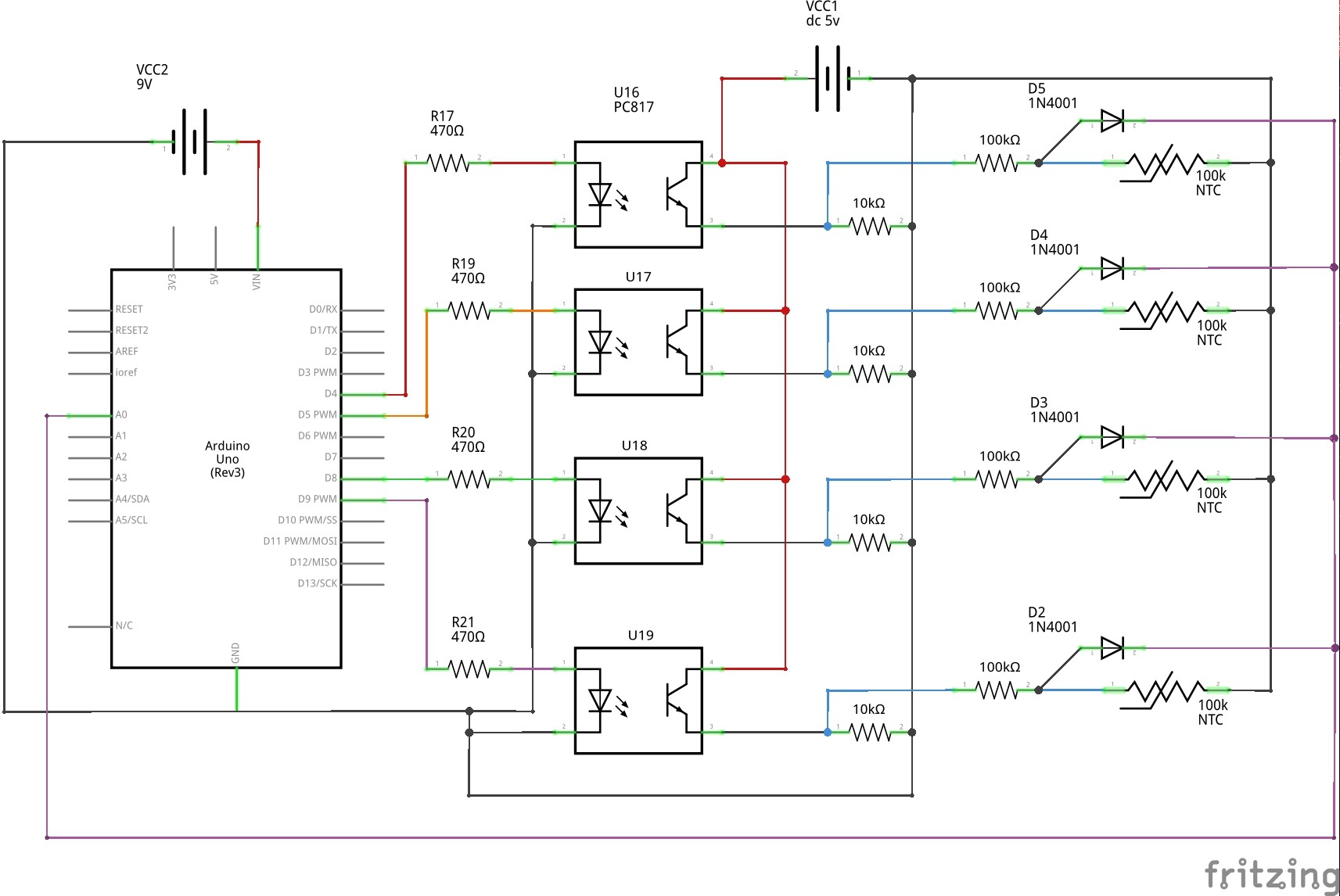

This circuit shows resistors on the input side of the 817s, maybe that is what I am missing?
This is not the circuit that I am using, it is just to show that resistors are being used on the input side of the 817s

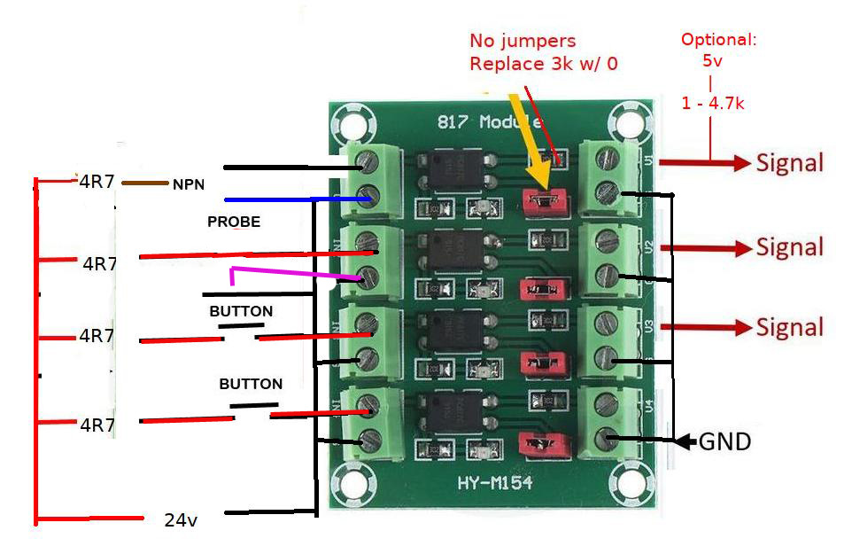

I don’t see any easy way to make that 817 module work. The GRBLDuino boards you were using would work if you replaced the 220 ohm (.11w @ 5v) input resistors with 4.7k (.12w @ 24v), the 1k pull-ups should be fine.
It took me a while to get the common anode input and switching to ground, e.g. 24v > 4.7k > PC817 pin 1, pin 2 is NPN signal or switch/touch plate + (switching to 24v gnd completes the circuit and triggers the PC817), pin 4 is the Arduino input which can have a 1 - 4.7k external pull-up (I’ve had no issues with just the internal pull-up), pin 3 is Arduino ground. Images already posted: Sometimes I get this happening - #12 by dalrun… Updated GRBLDuino image

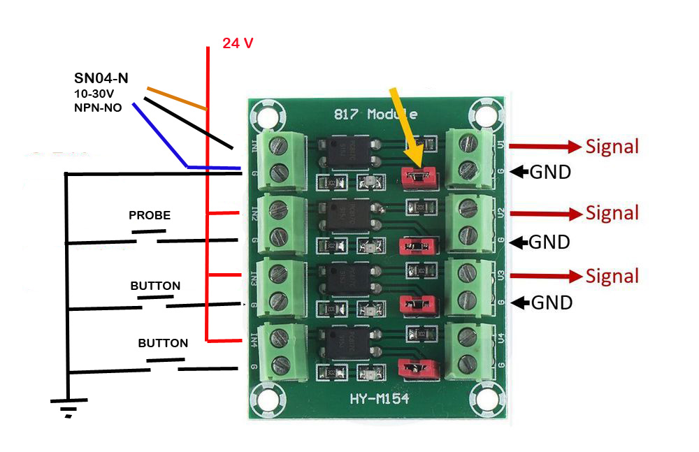

I found another drawing of the same board I am using.
I don’t understand the language, the jumpers, what are they for, are they needed?
I am not sure, but I will try this and see if it will work for me.
Not sure what the jumpers are for.
NO it doesn’t work that way. Everything is on.
It’s kind of weird. It says that if you have the jumper connected, the red signal arrow is gnd (as well, it seems), without the jumper it carries a positive current.
What I now see is a common cathode board with a huge ground plane. It looks to me like the input G terminals (via resistor/LED) and the output G terminal jumpers connect to the ground plane. I’m probably going to get myself in more trouble with this (gonna delete the last try)… I’m not an electronics guy, but the 3k G resistors would seem to negate the need for the 4.7’s in my image.

I take that back, it looks like all input G terminals go directly to ground. I’ve only had experience with common anode hookups so take that image w/ a grain of salt.

Odd wording, but yeah, no jumper = the 5v Arduino signal going out at G (to Arduino gnd) instead of to the ground plane/24v ground.
I see another problem also, the probe doesn’t short to ground, it will be shorting to positive. A work around would be to break the ground connection and hook up the probe to the ground terminal of the board and then it would work I think.
Seems like this board is a bit useless all round, and yet there are so many being sold.
No, it’s 24v > 4R7 > plate > tool > PC817 > GND

This was my thinking, showing the polarity a bit clearer, and also my thought on the work around.
I may be totally wrong, but need to find a solution for this.
But it still may not work because of the common grounds?

When the above switches are open, 24v doesn’t go past the switches and the 5v Arduino inputs don’t go past pin4 on the PC817. Closing a switch lets 24v run through the PC817 to GND (24v) which triggers the PC817 so that 5v can run to GND (5v) and trigger the Arduino input. Switches can only be in front of the PC817, everything after is GND.
You’re right that it (common cathode) may not work with a probe switch because the PC817 probably needs to be in front of the switch (common anode) so that tool = GND (unless its a 2x insulated router), i.e. 24v > 4R7 > PC817 > plate > tool > GND. An NPN switch could also be an issue if the signal/Black wire isn’t strong enough to trigger the PC817 (common anode has 24v to all PC817’s). It’s looking like a common anode capable board is the only all purpose way to do Estlcam inputs.
Wow there are a lot of variations to this board. But the Hy-154 that you show the red jumpers are for isolation between input and output grounds. Remove the red jumpers to isolate the imput from the output. Which you really should as your using 24volts on the input switches

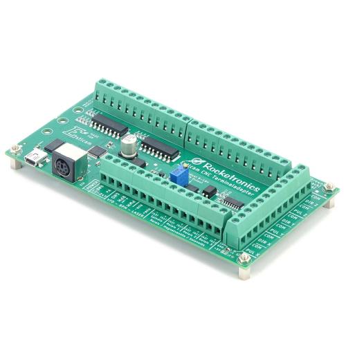

I looked for the Estlcam board but was not able to find it again, I think it was available through the ArdunioClub and I think it was about $50USD plus postage.

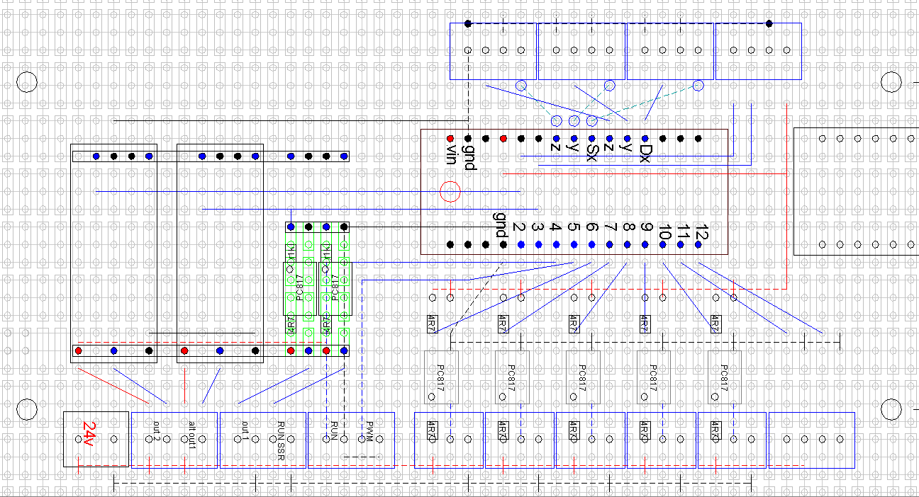

A WIP design that can accommodate stock Mosfet and custom output modules, has optional pull-ups on the inputs, etc.

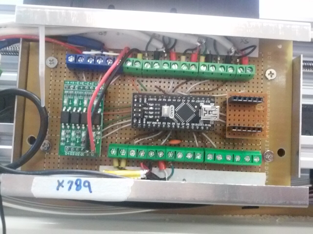

My current board w/ PC817 module (currently running fine w/ the 1k pull-ups removed).
