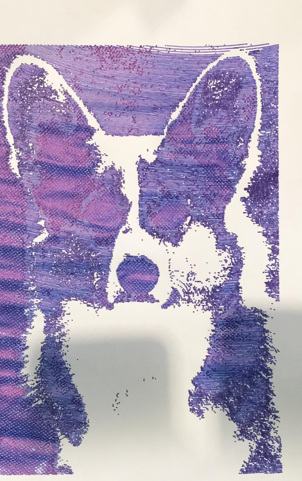

Guide for Converting Pictures Into Stylized SVGs Suitable for Plotting
I posted over on the “Things Ive Made” section about an image I made using a python extension I found. There was interest in a guide on how to do it so I figured id make a nice tutorial so that other people can generate these for their machine. This seems like the best section since the guide is all software use.
The Guide can be found here, Its rather long as i tried to be as thorough as possible.
https://docs.google.com/document/d/12hJulFG075jPUTqWEPkyutPnOiTGIKnimocnKWodH4I/edit?usp=sharing
Example Images
[attachment file=71568]
[attachment file=71567]
[attachment file=71569]

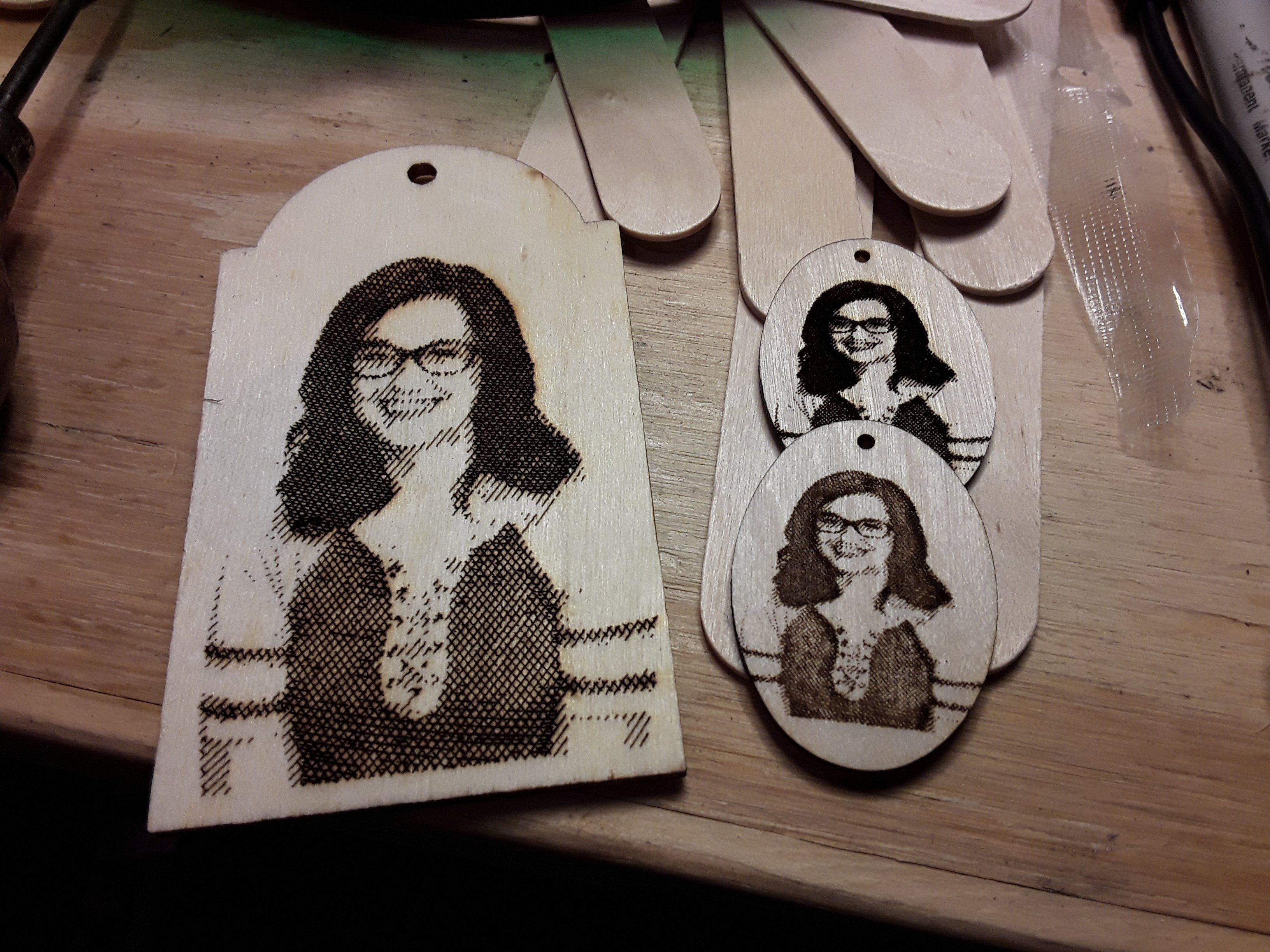

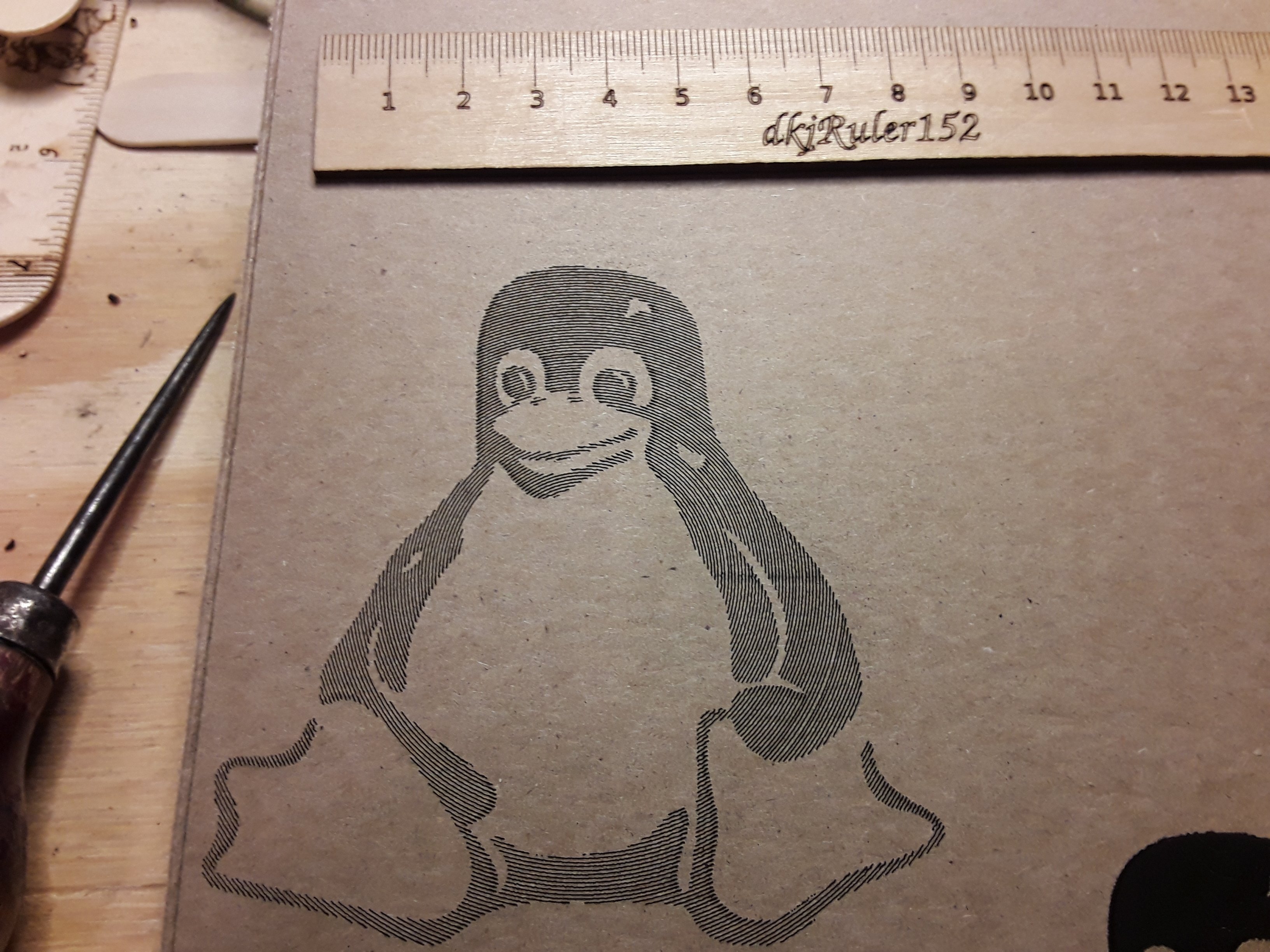

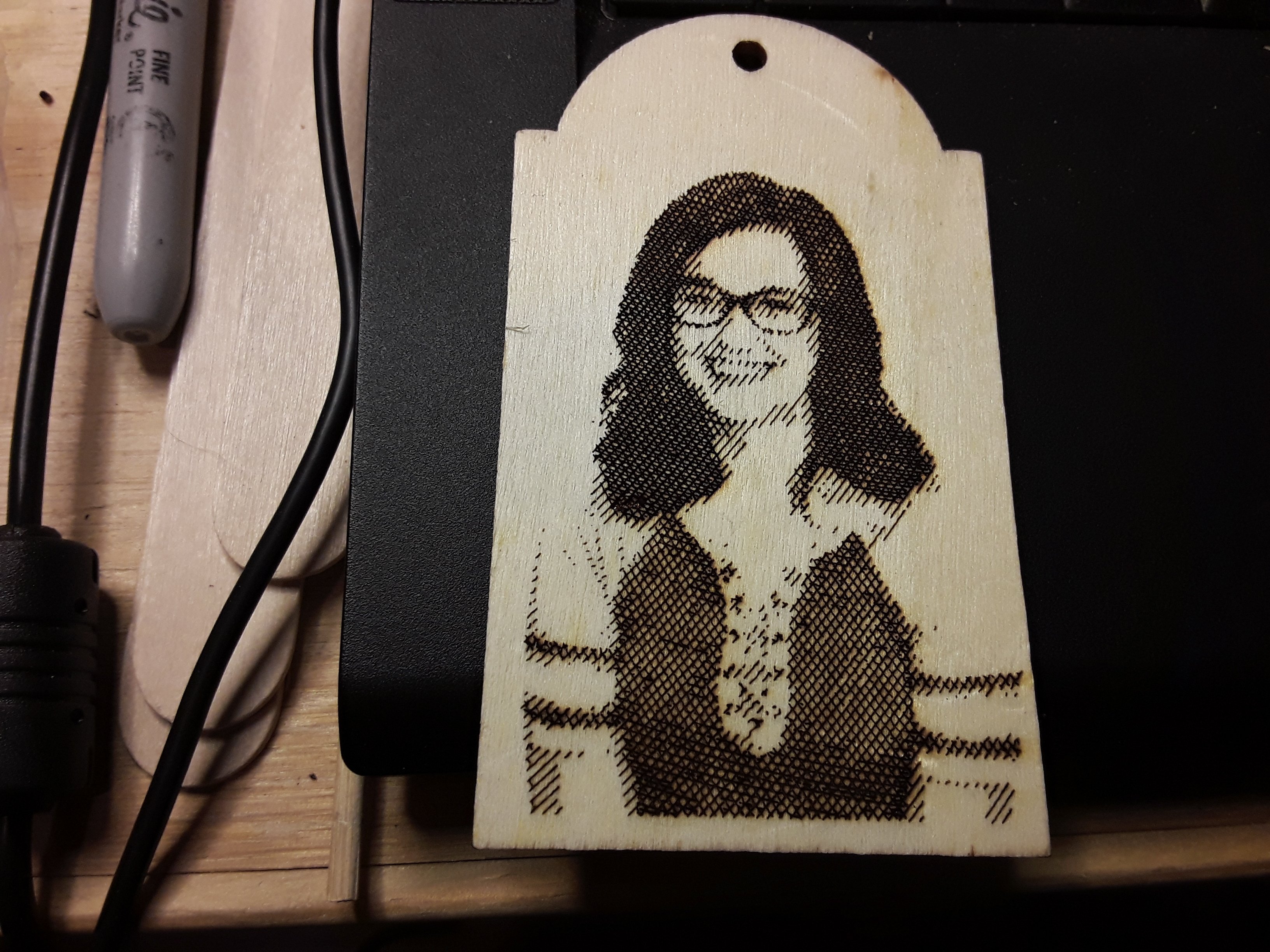

I used Inkscape and the JTech laser plugin… makes it really simple to generate gcode for recognizable images engraved in just a few minutes.
[attachment file=71826]
[attachment file=71825]

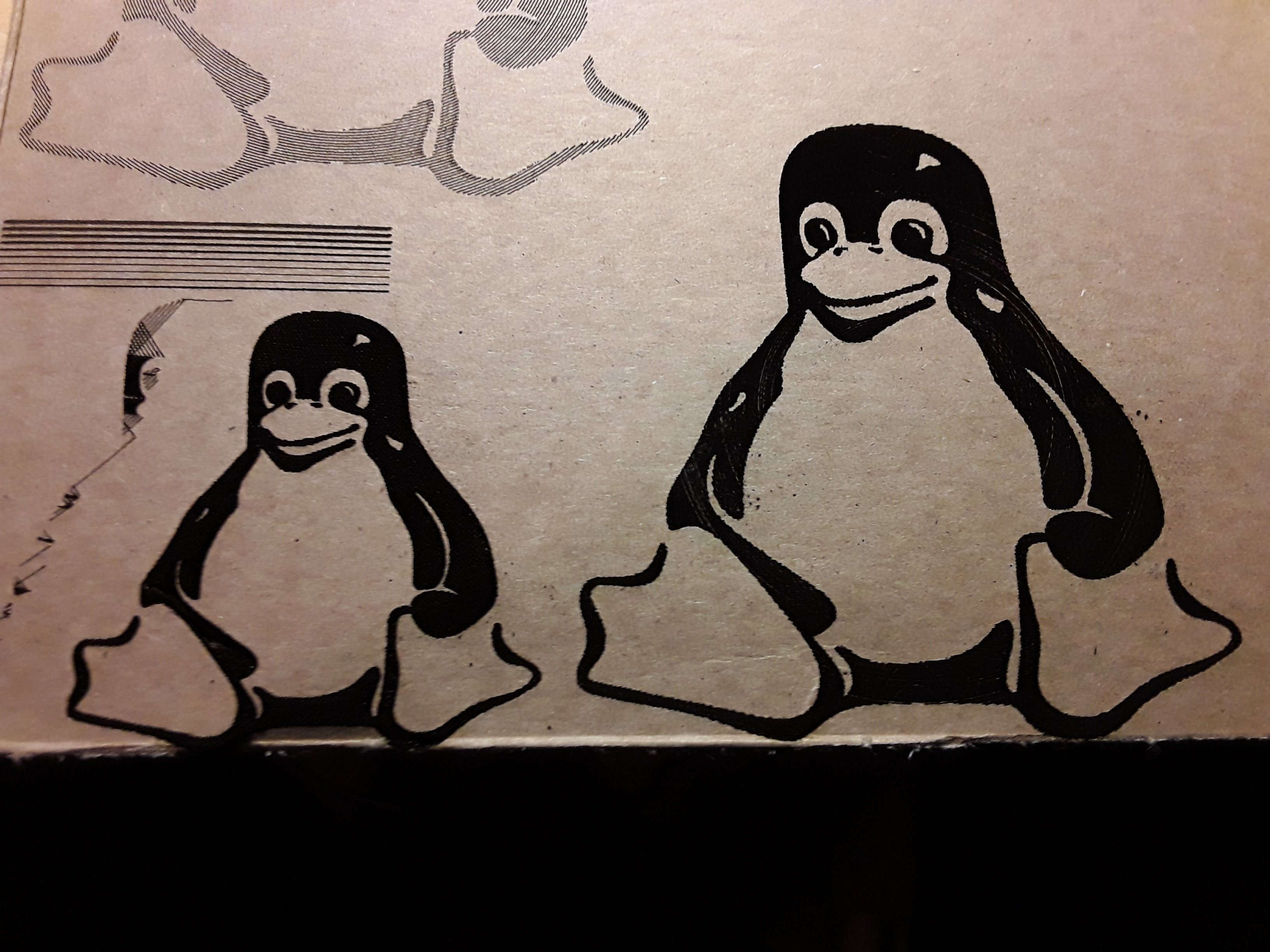

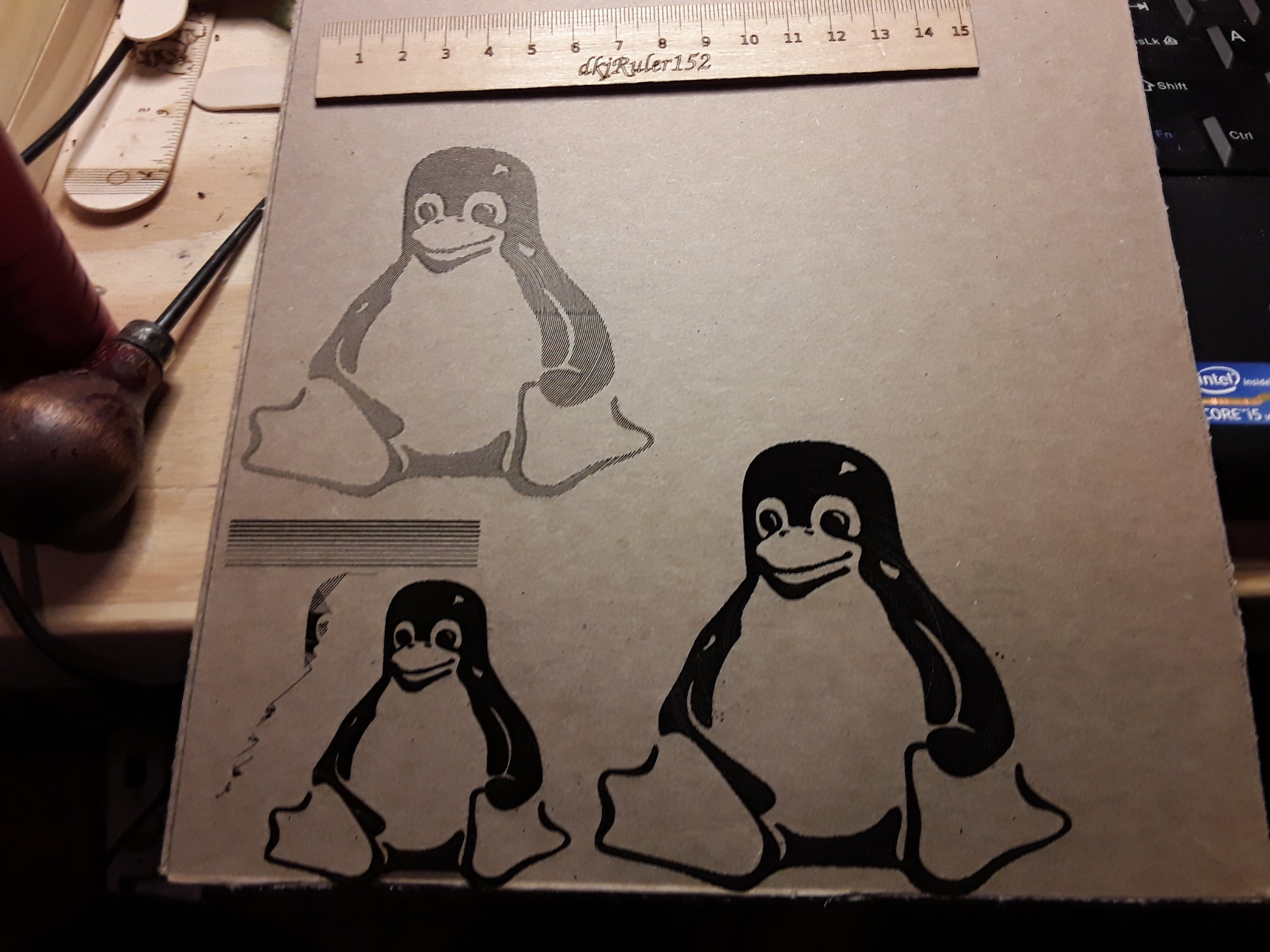

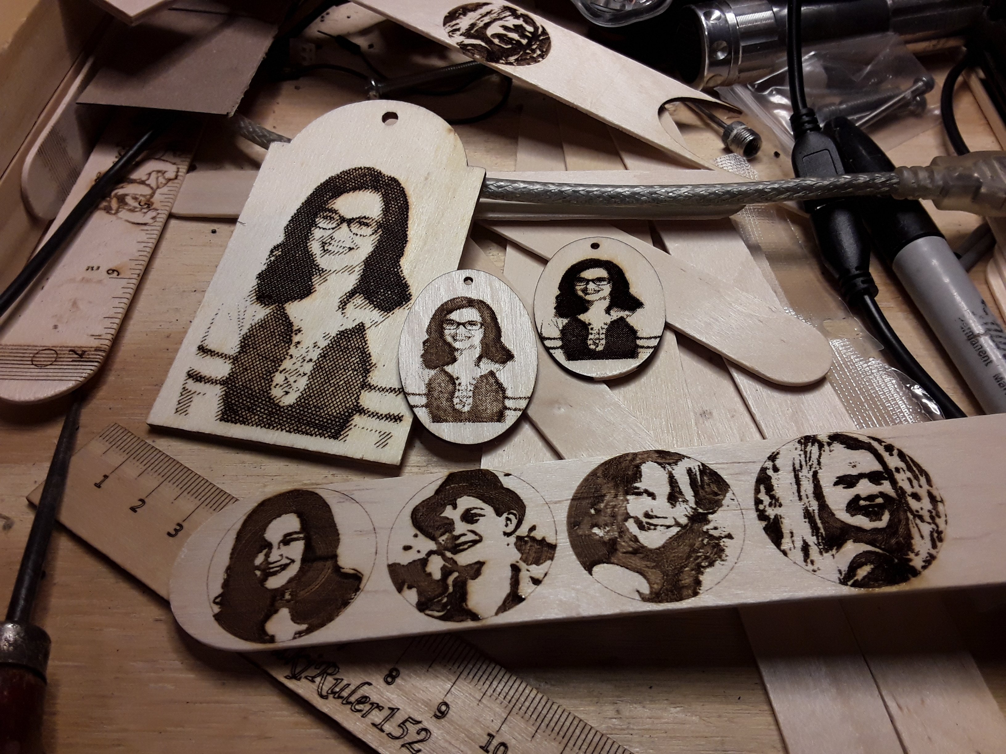

A couple more Inkscape/Jtech laser engravings… ornaments/gift tags, pendants, are all very doable. Still need to play around with feeds and power levels but all in all I’m quite pleased.
[attachment file=71929]
[attachment file=71930]
[attachment file=71931]
Wow, so I am loving this. It seems like this is actually a really good way to get pictures out of the laser really fast. As in the perfect in between of a raster and vector picture both in terms of speed and how recognizable it is. On top of that it looks great a cool style.
All 4 of those first pics are clear but each has it’s own character. I think we will be seeing a lot more of this.

It does indeed fall between vector and raster and can be adjusted to give more, or less, detail… but most recognizable. I’m having fun playing with it…

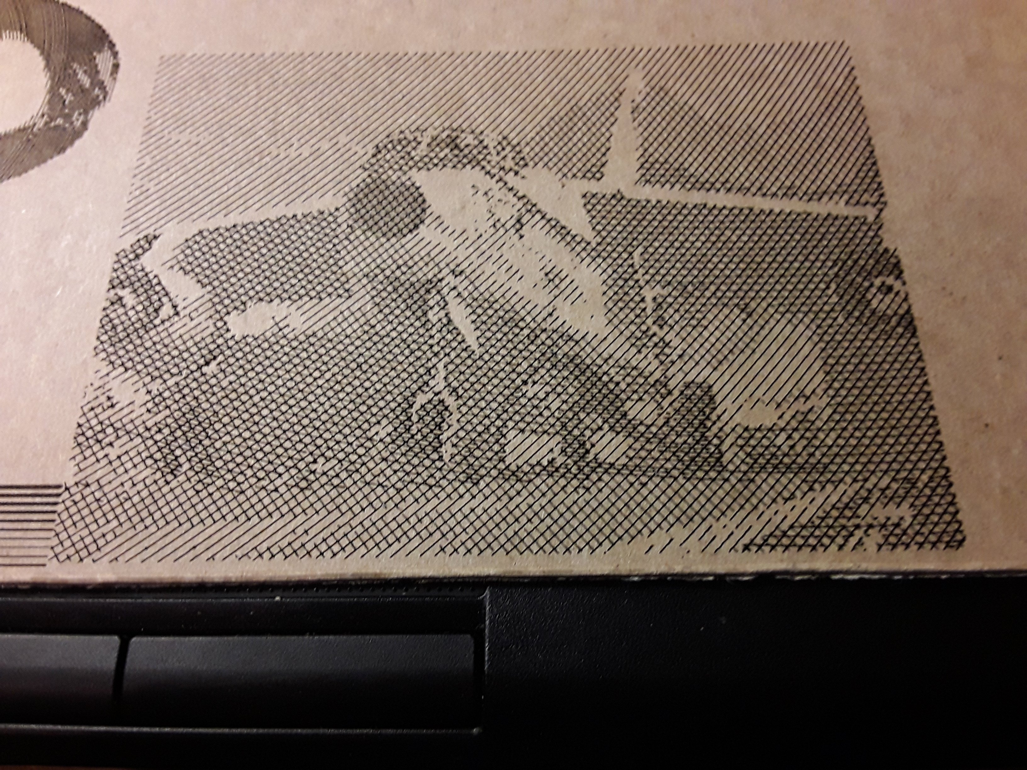

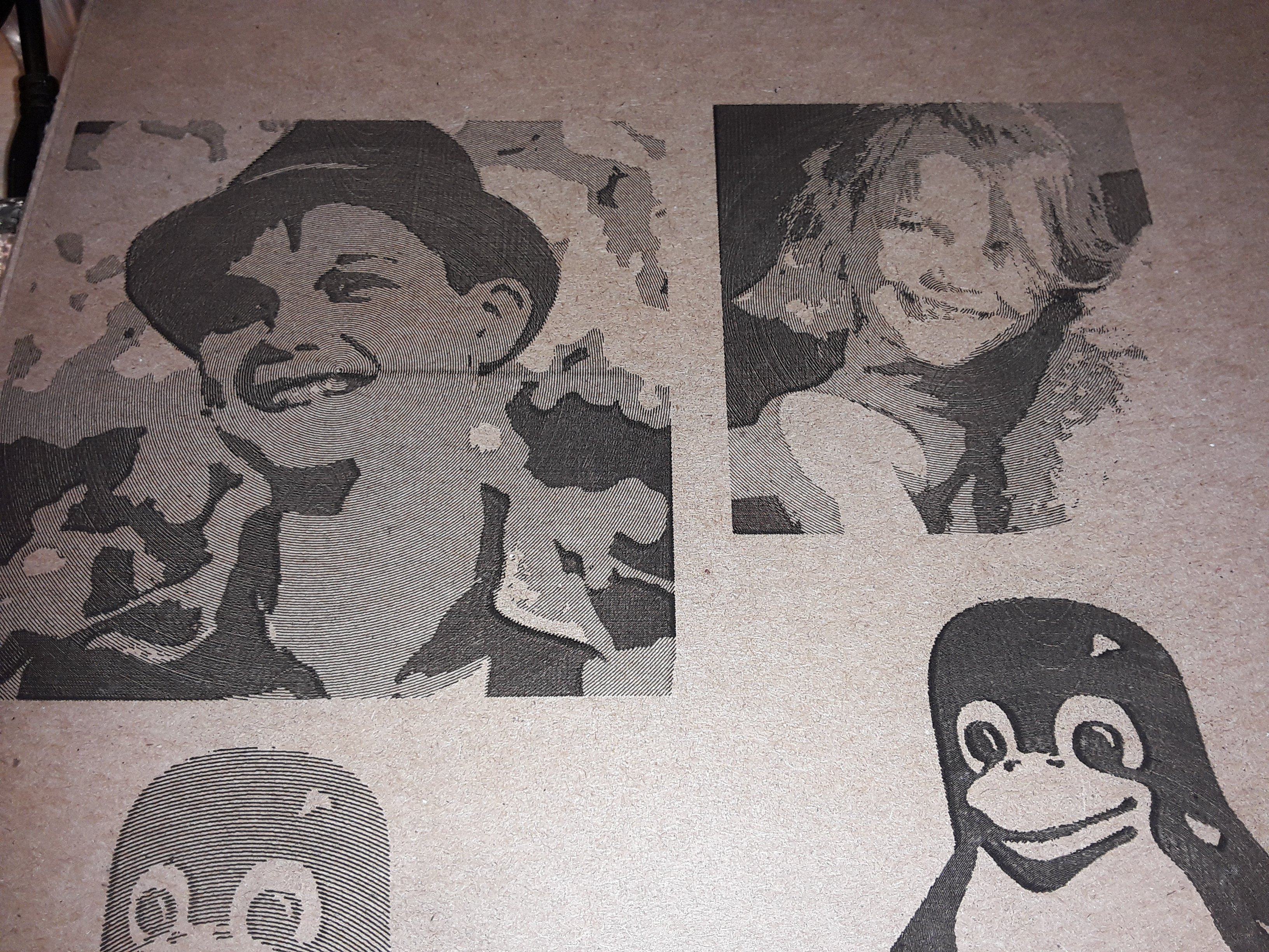

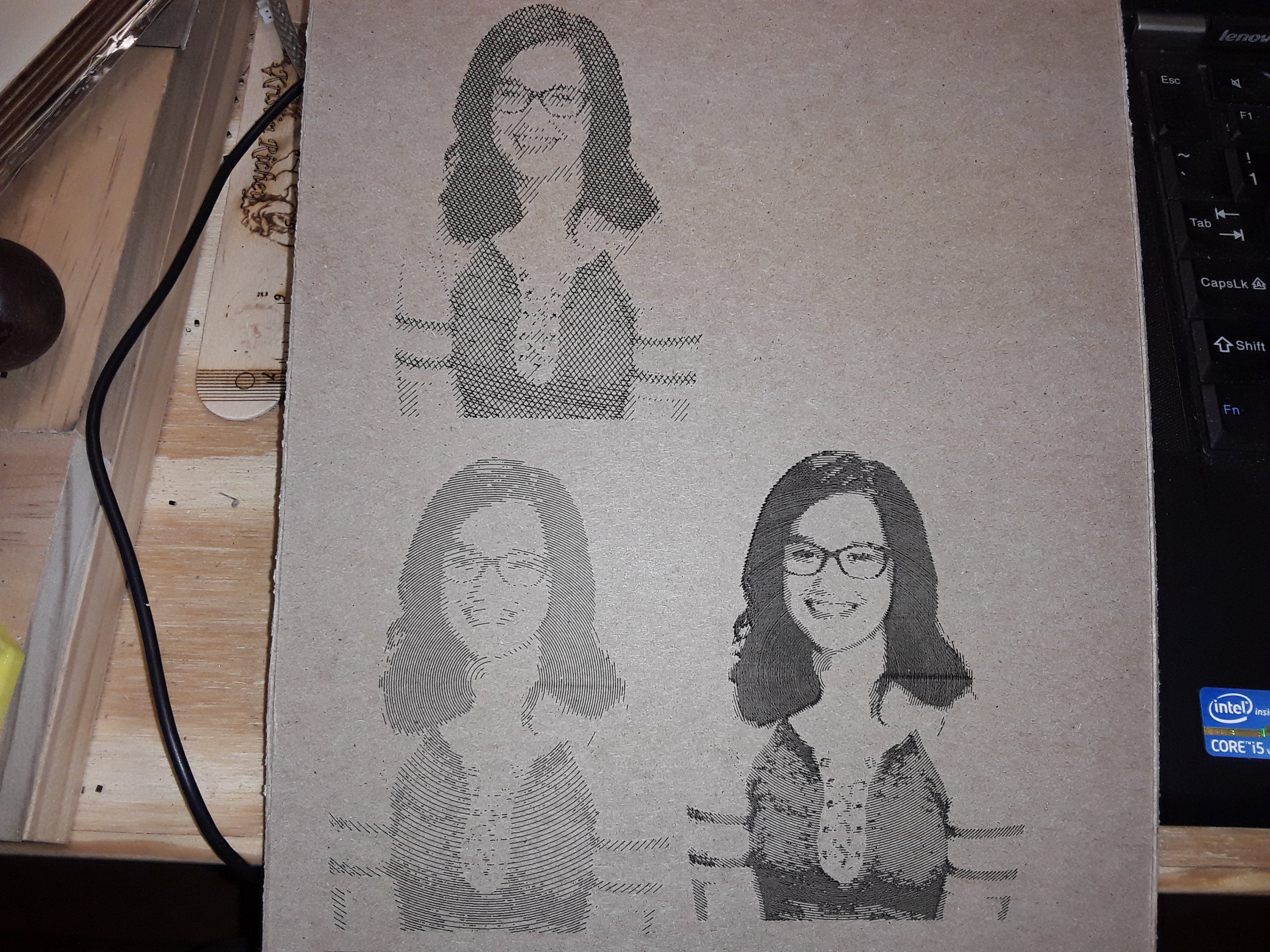

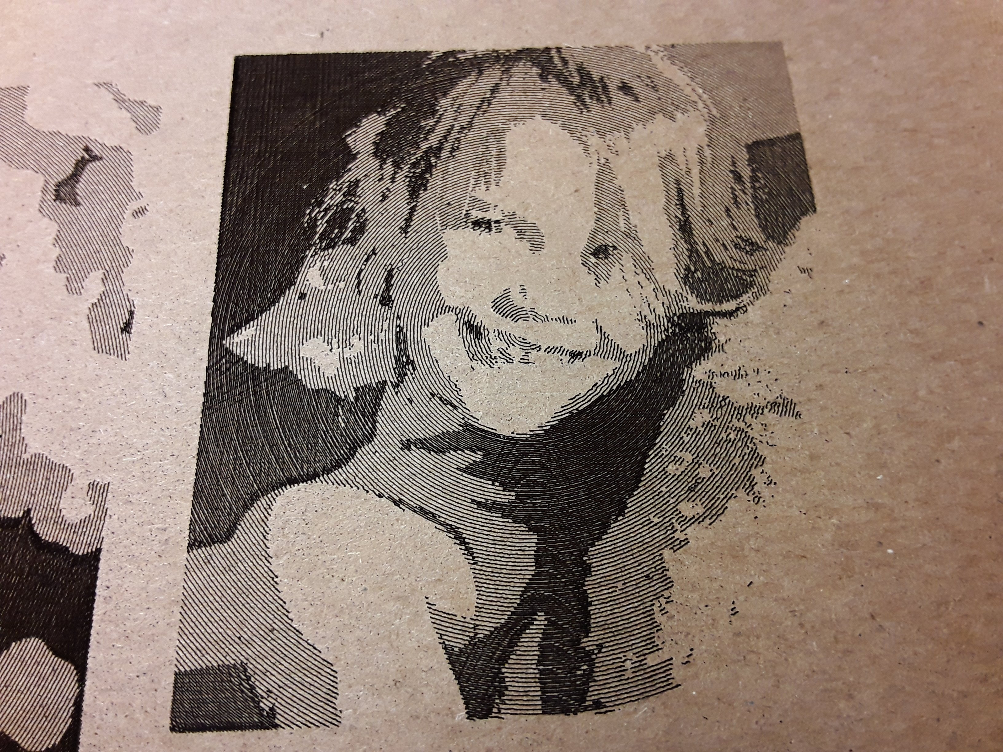

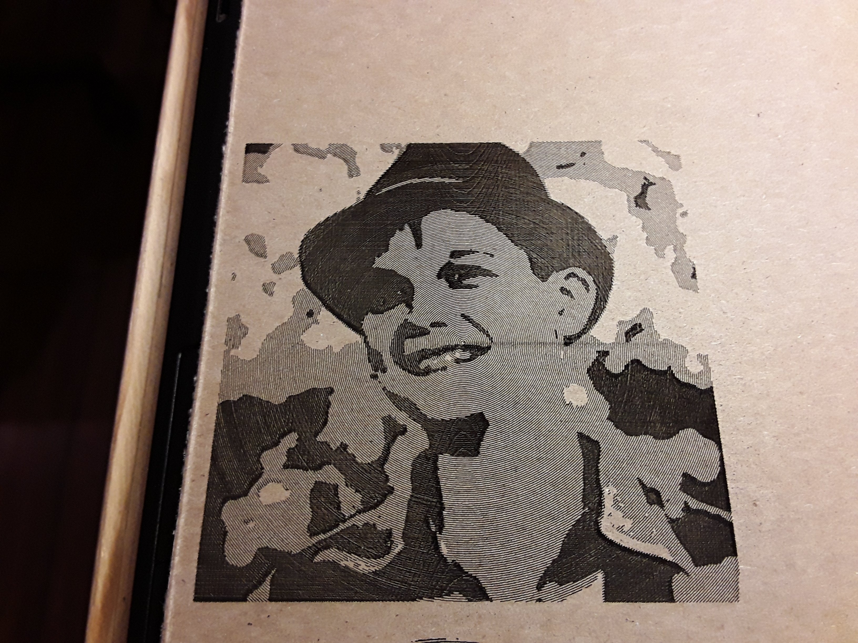

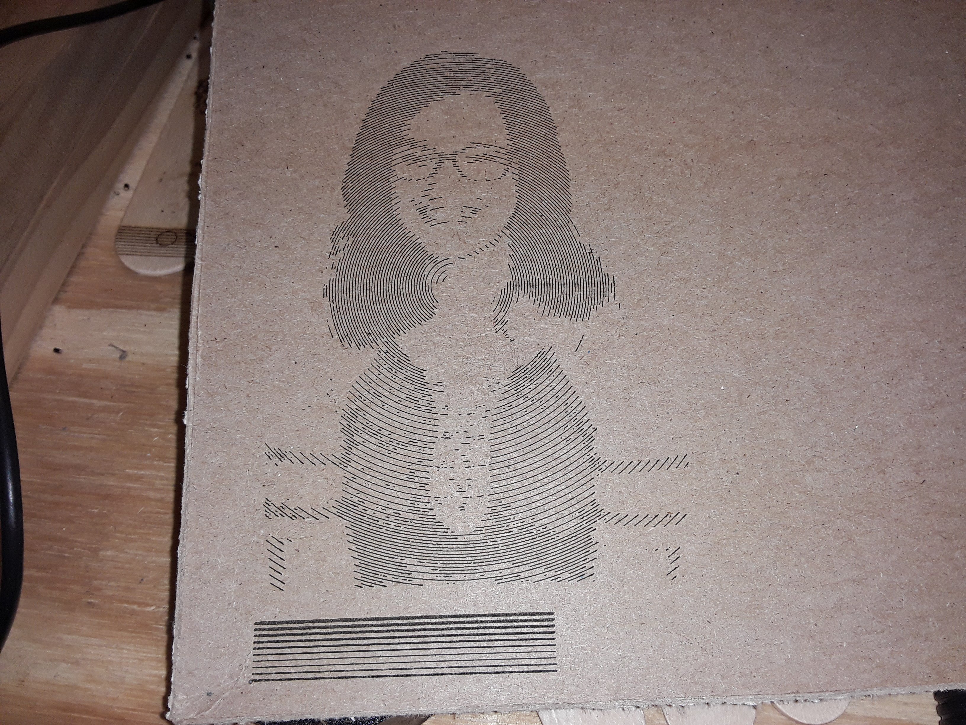

I’m far from knowing what I am doing with this. I can’t really find a good description (that I can understand) of all the parameters for each of the drawing types; sketchy, spiral, and crossed. I’m not crazy about the sketchy one, so have played only with crossed and spiral. There are some example scripts, however, so have simply played with them a bit… spiral is the easiest I think.
For the engravings I’ve shown the only things I’ve adjusted are (1) brightness/contrast/scale of grayscale source picture, (2) laser power and feed, (3) for spiral, the nib-size and line spacing parameters, (4) and final scaling in Inkscape. Cereal-box cardboard and craft sticks make nice test material and I’ve done all these with a Banggood 3.5 watt laser, using Inkscape with JTech laser plugin.

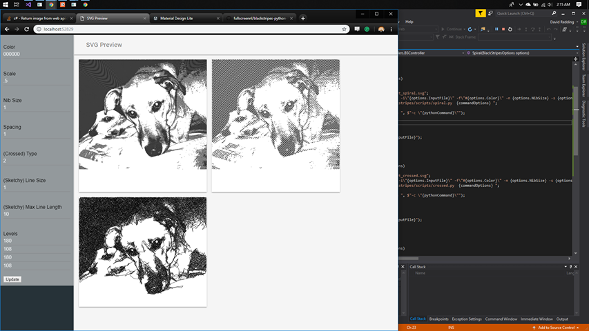

I created a simple web app to handle playing with settings
https://github.com/Davidaredding/BlackstripesViewer
it’s in pretty rough shape but it’ just barely works. I welcome PR’s and contributors :slight_smile:
