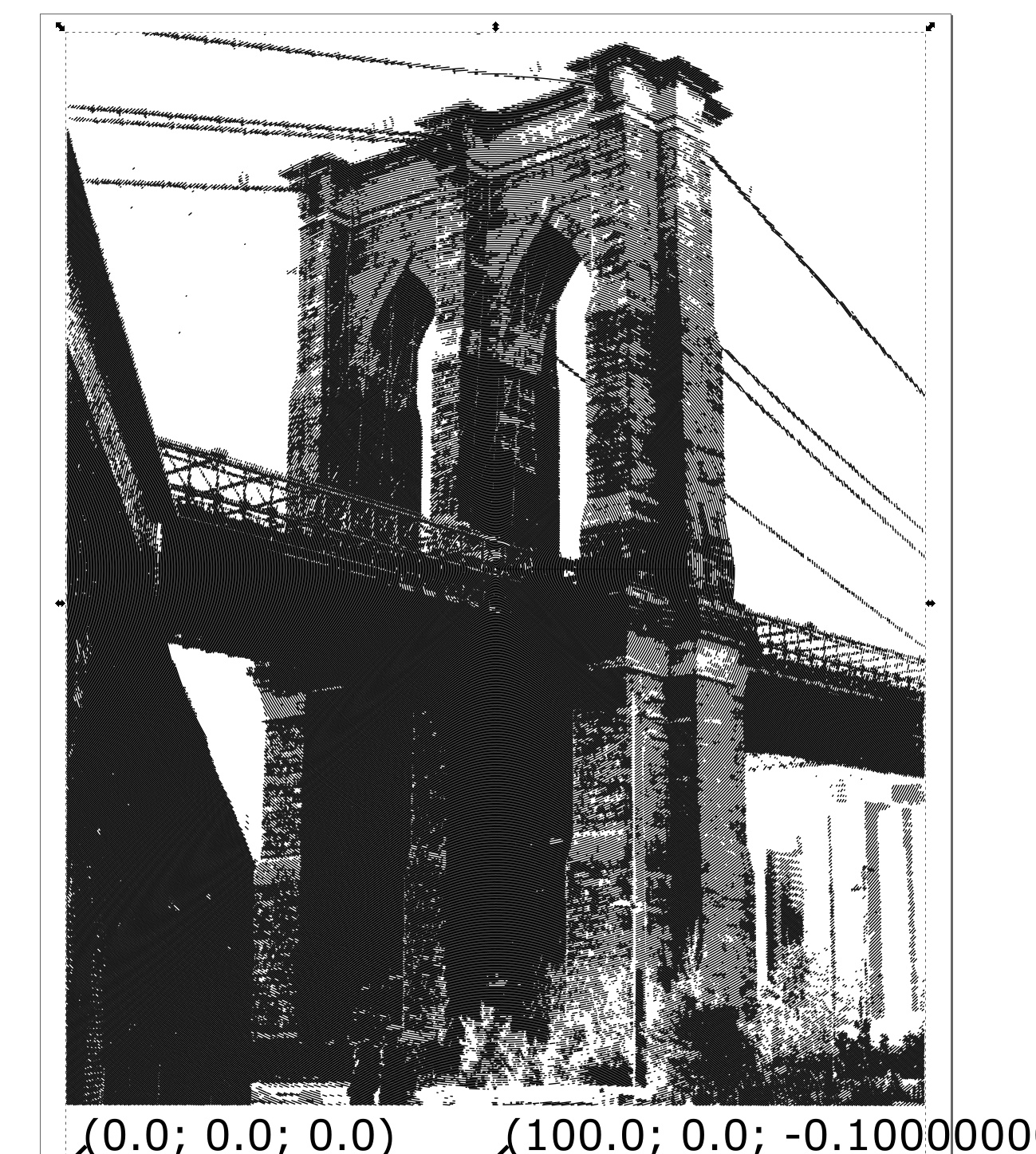

ive almost made it to the end of the write-up but when i generate the gcode it just sits in the folder at 0kb, i left it over night… still nothing. when i hit apply it gives me a message saying no errors occured but the output may be different than id expect. any ideas? Is the file too big this is whag im working with
Its hard to diagnose completely but it looks like you got output from the black stripes tool. In general if you get a 0kb file it means one of two things from my experience. Either Inkscape is still chugging along, or more likely there was an error in the processing.
Something that does look a little off to me is how small your canvas is compared to how dense your image is. Thats a ton of super small lines for inkscape to deal with and it may honestly be processing, or it may be running into an issue such as limited RAM.
I would try making a very sparse version that would be easier to process to make sure you get the work flow down.

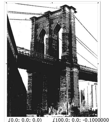

ok thanks adam, ill try some easier ones first. The canvas size is a normal piece of paper the lines are 1mm thick, but youre right it is pretty dense. It is a shame though, it would be cool to output something with this much detail to the mpcnc.

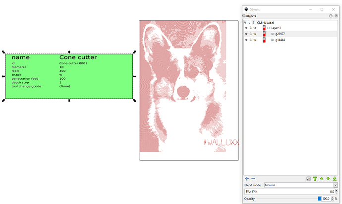

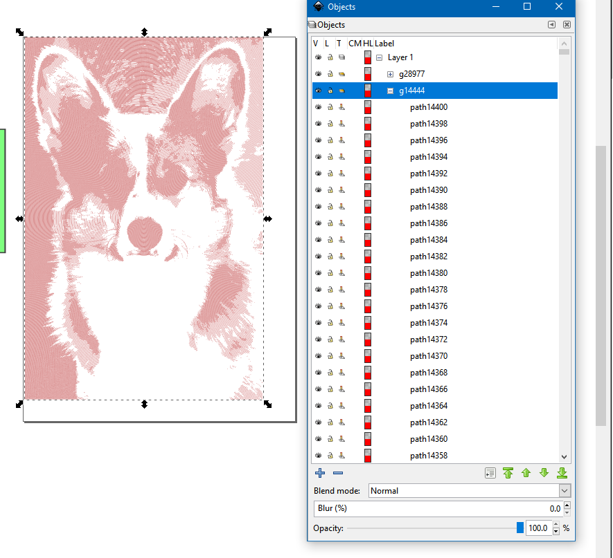

To select ONLY paths make sure that youve IMPORTED the svg not open. Go to objects tab at the top and select Objects. A new windows will pop up that shows all the objects in the file.

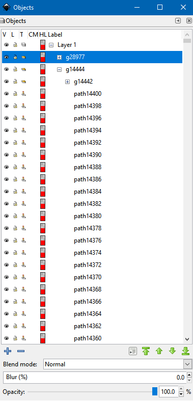

Expand the groups (the items that start with G) and try to find the one that has a lot of paths in is. For me there is a sub group (g14442 for me) that has the logo in it. Im going to delete that so one of the top level groups has only paths in it. just highlight the group and hit delete
to select all the paths just highlight the top level group and youll get a selection box.

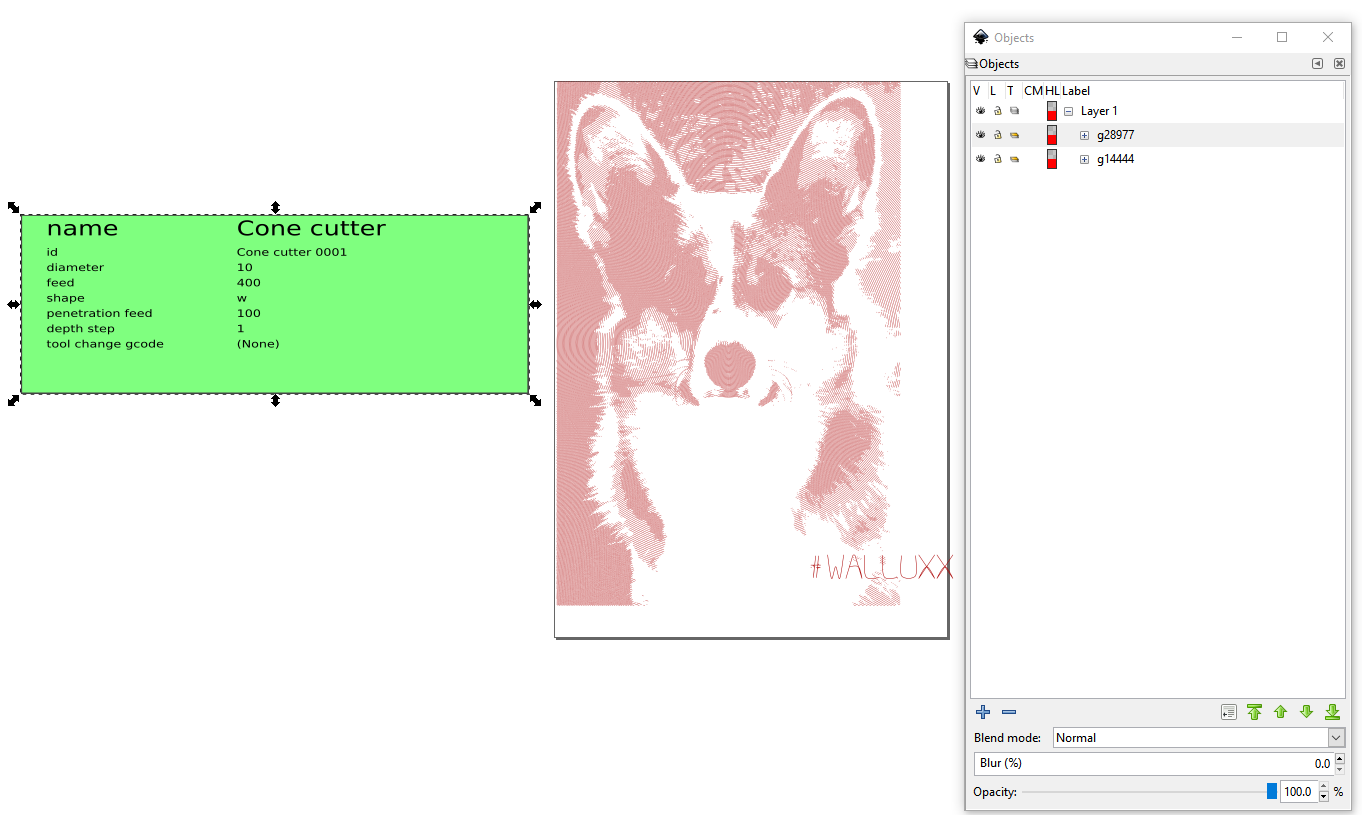

make sure you have orientation points and a tool defined and then use the Path to Gcode menu item as described in the the Guide. This will hopefully fix your error
