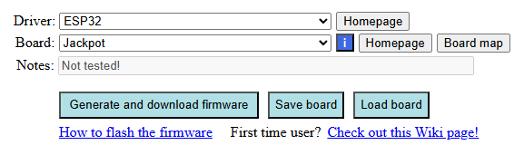

I saw that on the grblHAL web builder, there’s an option in the dropdown for the Jackpot. It specifically notes “Not tested!” but it’s an interesting thought.

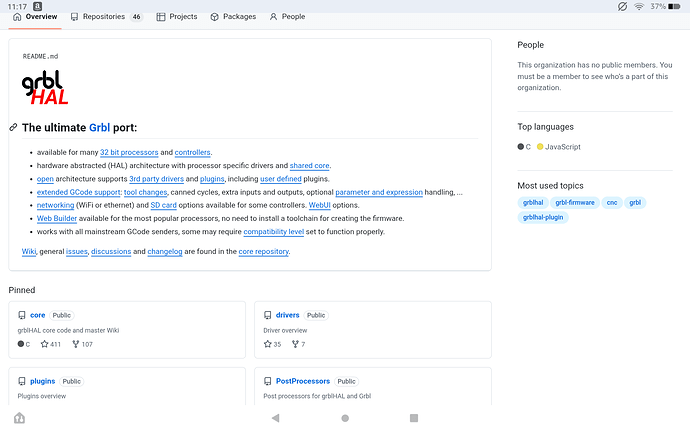

At a quick glance, there are some things in grblHAL that FluidNC doesn’t have that are interesting to me such as:

I would love to have options, and that web builder is a pretty nice touch.

I’m working to try and load one of my Jackpot V1s with GrblHAL.

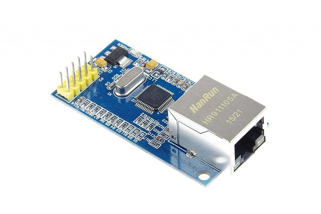

Note- as I read through the plugins, it looks like there’s a Wiznet plugin. What’s that you might be wondering? Support for wired ethernet. (Would need a board revision to use most likely or maybe a module for the expansion header on a Jackpot).

Managed to use the Web builder and chose a Jackpot V1. Used a fresh genuine ESP-32.

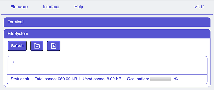

I must have goofed something because I don’t get the full WebUI.

Edit:
Turns out you have to get the WebUI from here: https://raw.githubusercontent.com/luc-github/ESP3D-WEBUI/3.0/dist/CNC/GRBLHal/index.html.gz and upload it. Much like FluidNC.
Then… Look familiar?

One question would be whether it would make sense to have a header on a board for something like the W5500 to plug into.
That’s a $6 Ethernet module.

any ESP32 can easily be ethernet-enabled using a W5500 module
