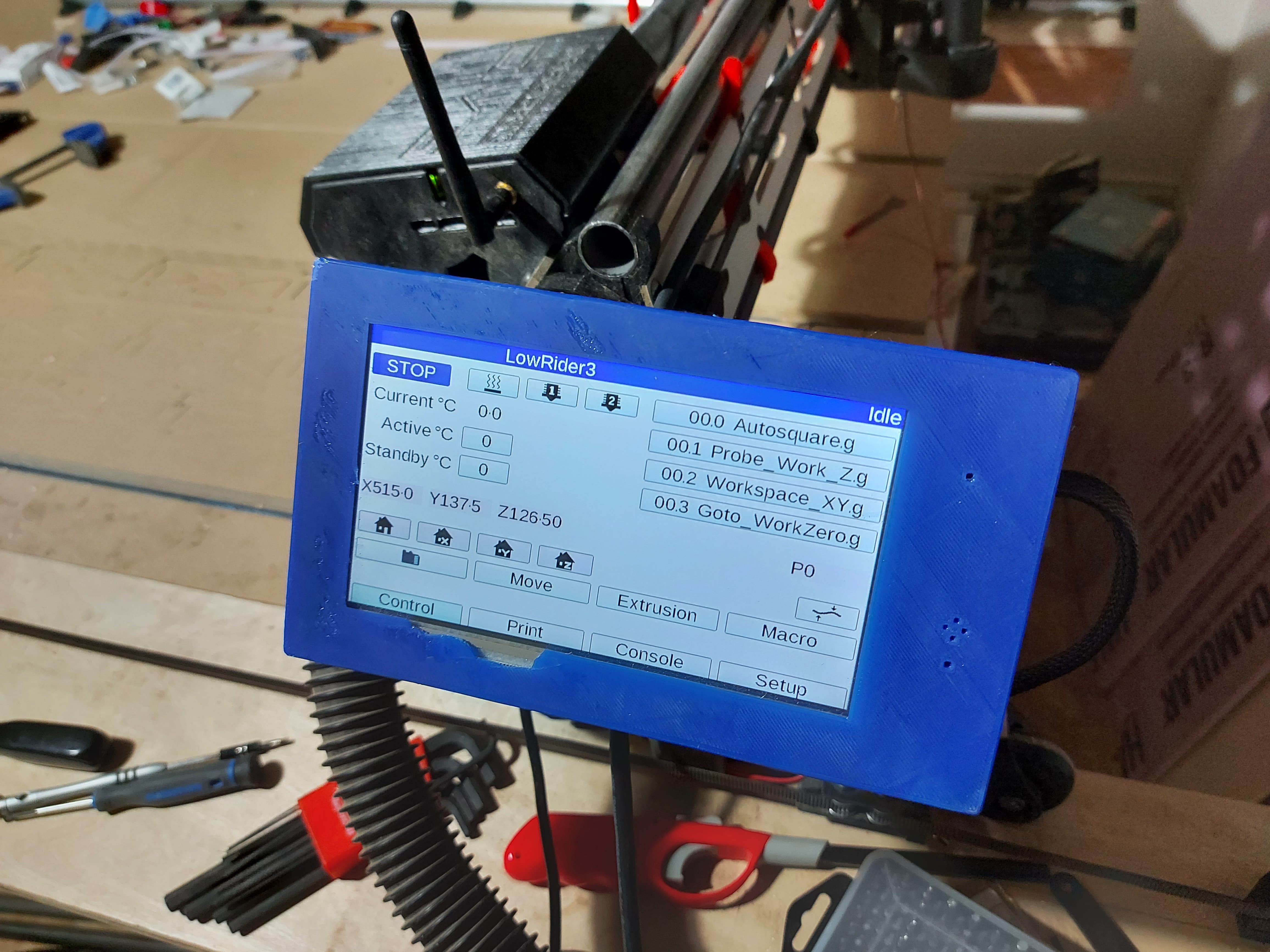

One more little step…
That 7" screen looks HOOGE though.
Looking at that 1" tube in the background, kinda wondering what the 1/2" conduit would look like… and thinking of my reusable aluminum straws. …
I think this is just about done.
I have some firmware issues to go through. For some reason, RRF doesn’t want to let me use the probe to auto-adjust my Z axis. Not sure if this is becsuse thr 2 Y drives or because CNC mode. It will report though that as it sits the rail side is 1.61mm higher than the wheel side. I don’t think I have enough adjustment in the Z stops to fix that in hardware. Kind of tempted to remix the Z stop with more adjustment on the one side. Or I can fix it in software…
I haven’t done an exhaustive check of square in the XY plane yet. Those will require software fixes to the Y endstops, too, unless I deem it acceptable strangsr things have happened. RRF should actually make those changes relatively easy. The biggest annoyance is making sure that I reset the axes back to normal when it’s all done.
