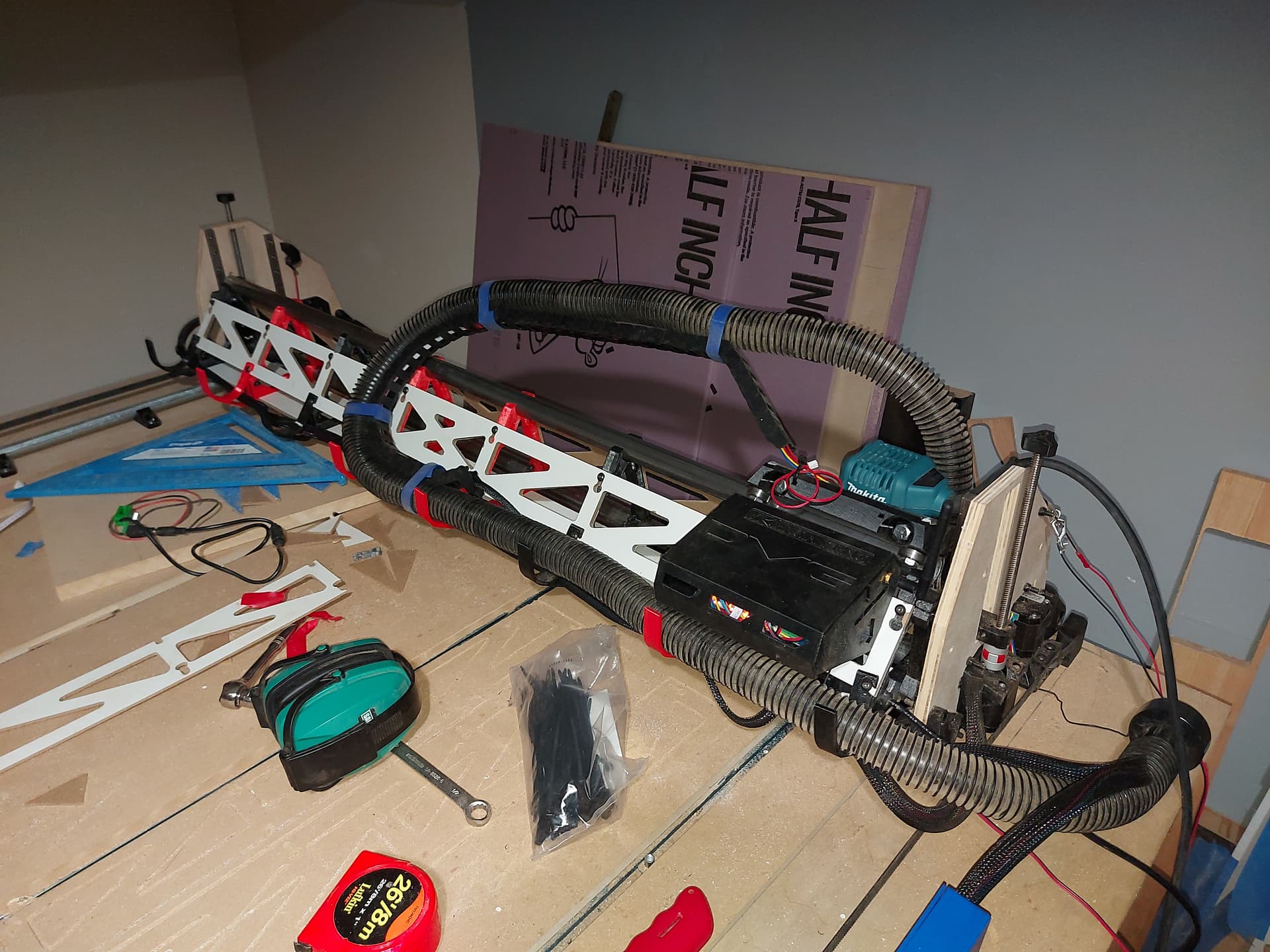

Rebuilt & ready to go again. Motors all working as expected, wiring harnesses all tucked into the hose hooks instead of in the beam.

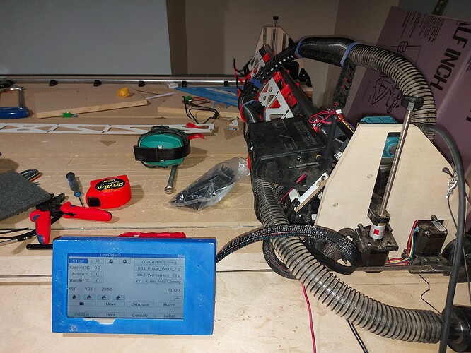

The 7" PanelDue might be too big for this. Maybe I’ll switch the 5" from the Primo, or one from a printer for rhe 7". Had a bit of a.mishap printing the case, a bit of the face stuck down to the PEI too hard, and it broke off, but I can day that printing both top and bottom, plus the various clamp pieces is the single biggest print plate I’ve ever attempted. It only barely fit on the 310mm plate.

Try and get that hose and chain connected to the top of the Core. I gave mine a few good over bends and zipped it in place. That should significantly reduce the force near the endmill, and put it all up at the top two wide spread bearings.
Will do. It’s sort of fastened down with a zip tie that you can’t really see, bit a more firm mount is in production.

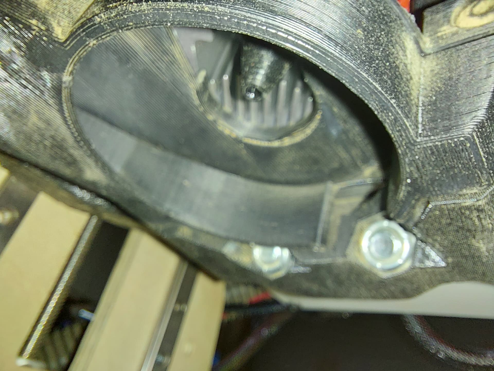

The laser is down all the way against the dust collection
In this position, the air assist nozzle is about 1cm or so higher than the bottom of the core, and with the focus set to its longest, the focal point is just above the bottom of the core. With the core just skimming the surface, it might be OK, but probsbly no good for cutting thicker.material.with multiple passes.
@vicious1 maybe having the CAD for that part is necessary after all, to allow for the laser to sit where I want/need it. I would want the air assist nozzle about even with the bottom of the core ideally. I would probably cut the opening larger, and make a diverter plate for the router cooling air to snap in place when the laser isn’t there.
Edit, I had the laser glasses on… should have turned off thr 1% focus power for the photos…
Better shot of the air assist nozzle higher than the bottom of the vac duct
Maybe the round centerpiece of vacuum shoot could be removable like the LR2??
