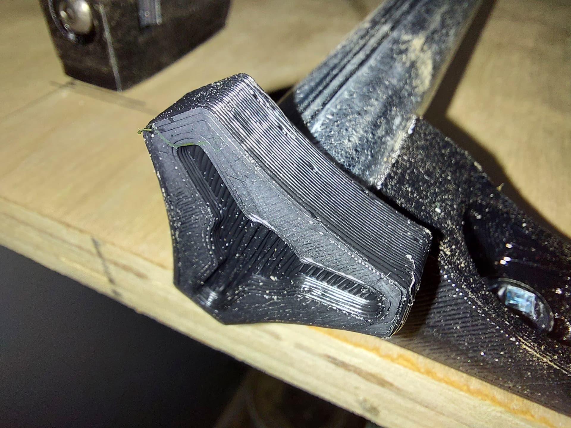

Even if you move the Z all the way up? I got mine in a few times.
At the nut holder?
Hmmm. Maybe. I thought I had it up quite a ways. I think it’s just that I have an annoyingly long screwdriver for those. Removing the rail rider was fast and effective though.
I think I wasn’t holding it well enough. It was cracked at the nut holder, yes, but also along the top portion where it aligns to the XZ plate. The result was a hot mess. I re-printed the part 2x at 50% and figured I’d “destructive test” one of them, just kind of gorilla it on and see how it fails… And it didn’t, so it’s still in place.
