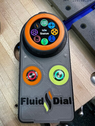

But this time he lived to see another day. Modified the config file and got the Fluid Dial working.
Mostly I need to remember how I set it up to be able to see the files on the sd card and then to load my macros…but that can wait till I’ve had my morning coffee.

I’m still unable to get the Fluid Dial to read the contents of the SD card or to load macros.
I may need some help getting this last piece of the puzzle working.
I can read the contents of the SD card in the WebUI version 3 and edic macros and save the config preferences.json file so I know that FluidNC can see the sd card and can run macros.
I just can’t see them on the fluid dial which is my prefered user interface IE: it’s how I communicate with the machine.
Like others in the forum when I upload a file to the SD card I get errors and am forced to restart the board.
Something isn’t right but I’m not sure where to start isolating the issue.
Are there know issues with the SD card with the latest FluidNC build?
Are there know issues with reading the SD card and Macros on the latest release of the Fluid Dial M5Stack version?

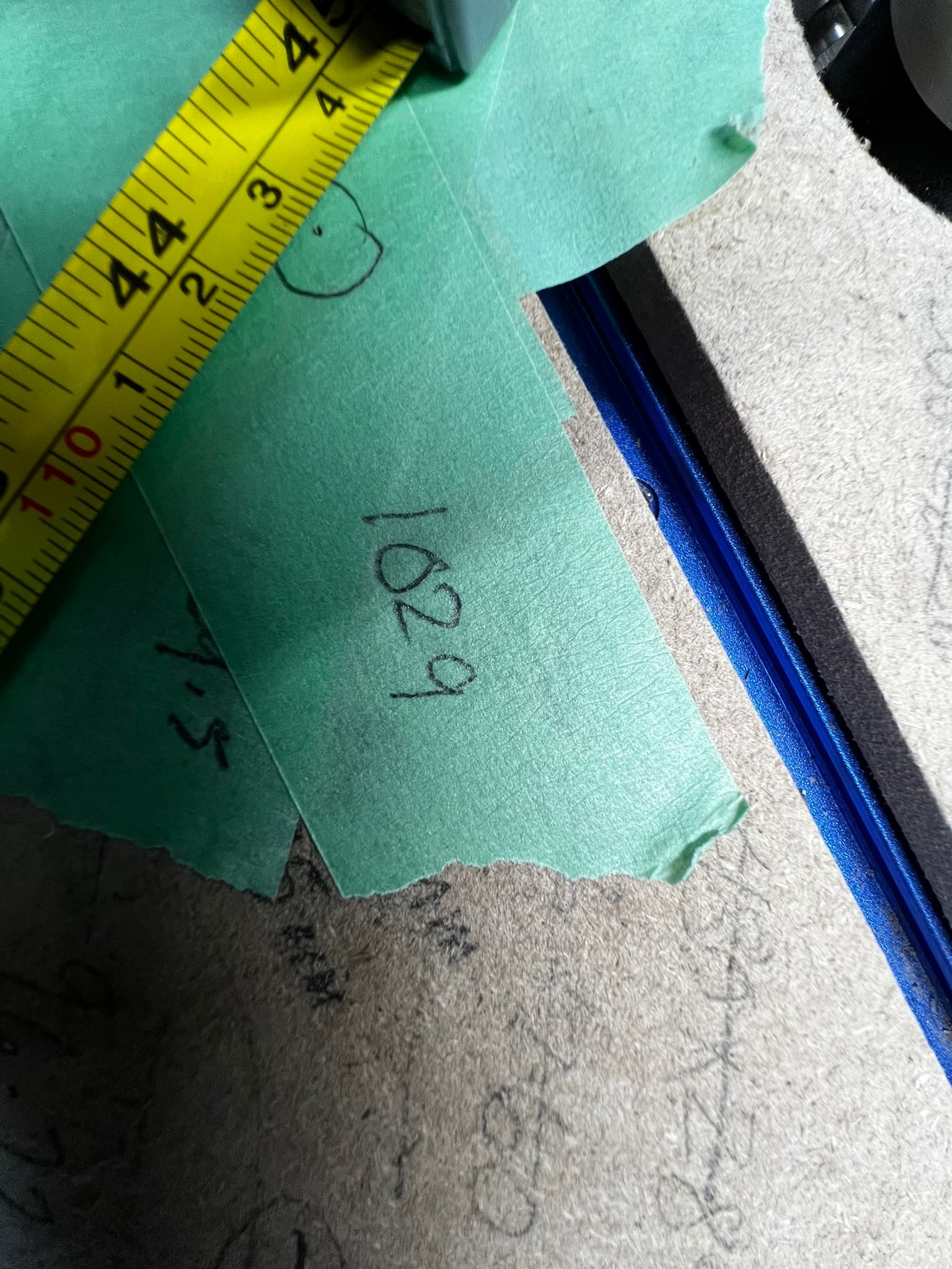

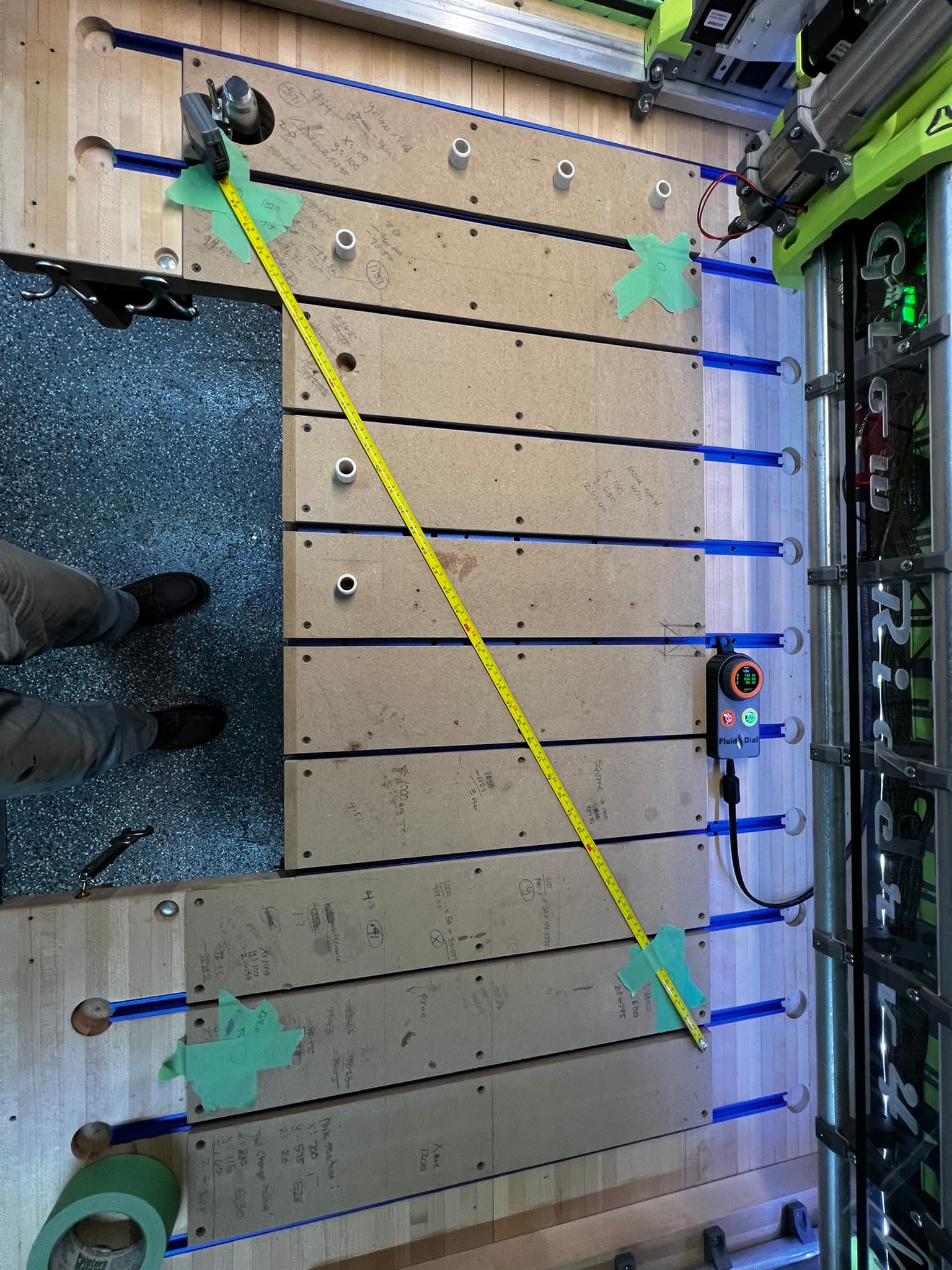

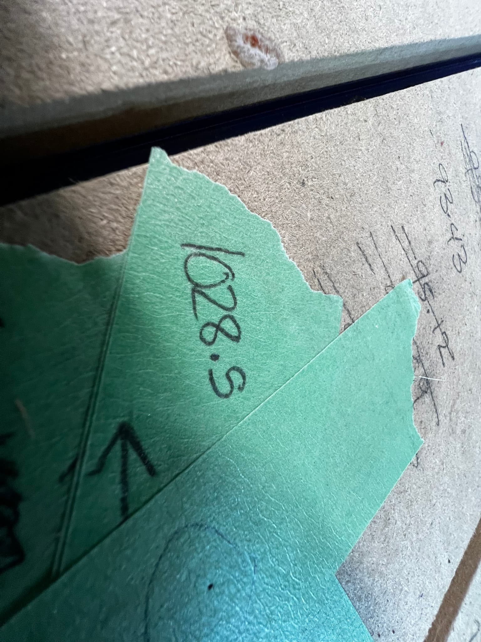

I believe my y0 pull-off distance is at 5.5 mm, while the Y1 pull-off is at the default 4mm, and over 1000mm, I was able to get the 4 corners square to .5mm
