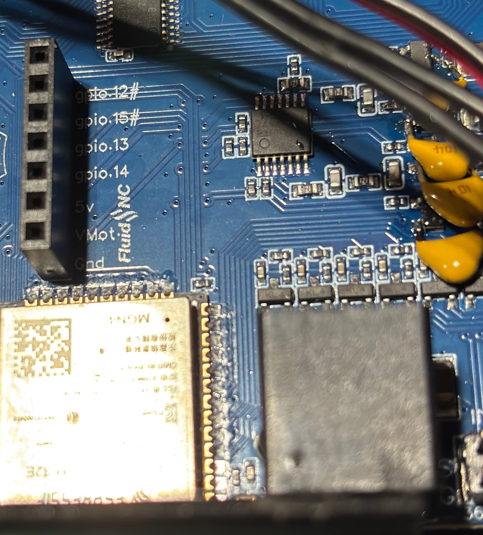

Are you getting jackpot errors with a fresh firmware install and fresh config without the pendant hooked up? Just wondering what actually fried your original JP3
Before I fried it…
It was working fine. out of the box (V1 Installed version 3.9.9 FluidNC and v1 Installed Config files)
….The Only exception was the Fluid dial not working or in the state of Not Connected (NC)
I did switch from AP mode to Client Mode for WIFI I prefer that method and configuring a Static IP address for the Jackpot so I can upload files from my workstation in the office.
Technically I can still see the files on the jackpot and the SD card and Flash it etc. but It’s in this perpetual Reset mode and will not function as it is intended.
I think when I connected the external Barts RJ11 module to the JP3 module pins I must have sent 5v to the 3.3v ESP module. or something like that

I wouldn’t think that would be possible. Using his board in that extension header should have been good to go, not needed on the JP3, but still should not have fried the board. Any chance you plugged it in 1 pin to the side or anything? Not sure if that would have hurt anything or not, but seems more plausible than if it was hooked up correctly. Sure would be good to understand what happened so we can help others not have the same situation is all I am thinking.

well my preference would be to get the fluid dial working on the onboard rj11 of the JP3 so I could use the 0-10v spindle module on the JP3 expansion pins.
From what you are saying if I just uncomment the ##Pendant section of the config file then using gpio 12 and 15 with the rj11 on board should work with the Fluid Dial as it is currently wired.
Thats the Hope at least. I may just copy and paste the uart2 text and put it below the uart1 text and leave the ##Pendant section alone…since that caused issues before. and use the text as Britt has posted above:

Anyway now that the JP3 is properly fried. It literally gets super hot to the touch just below the ESP module even just plugged into the USB 5v port. Hot enough that you pull your finger away from it right when you touch it. Which also makes me believe I must have done something ill-advised to it.
The extra spaces shouldn’t have caused any damage. It would say NC on the display, but it shouldn’t hurt anything. It doesn’t make any sense.
Maybe some one else has a suggestion for you to try measuring some points on the board.

If I remember correctly, here was the sequence of events.
  1. no power connected (either 24v VMOT in or USB)
  2. I connected the RJ11 expansion module, getting the orientation correct so that the vmot, ground, 5v, and gpio pins were alligned correctly between the expansion module and the JP3 pins
  3. Powered on using the 24V Line in power
  4. The green LED light on the JP3 “briefly” came on (and so did the LED strip I have connected to the same 24v line
  5. Then the green LED flickered and went off (so did the LED strip), and then both attempted to come back on, like when the power to your house goes out but then comes back on right away
  6. I thought this was odd, so I shut the switch off and disconnected the Bart RJ11 module.
  7. Note: I’m not sure if I left the Fluid Dial RJ-11 connector in the JP3 RJ-11 or if I moved it to the Expansion Module. <<< I remember thinking that since the JP3 RJ-11 and the Expansion pins “share gpio 12 and gpio 15 that I must have shorted something out because the Bart RJ-11 Expansion module does have pins for all of the slots, including gpio 12 and gpio 15 so in my brain I had something connected to the gpio 12 and 15 pins in both locations (RJ-11 on JP3 and Expansion module pins)
So that would be something easy for a “tester” to check what happens if you have an RJ-11 plug in the JP3 RJ-11 port and “ALSO” connect a Bart RJ-11 module to the JP3 expansion pins and turn on the power.
